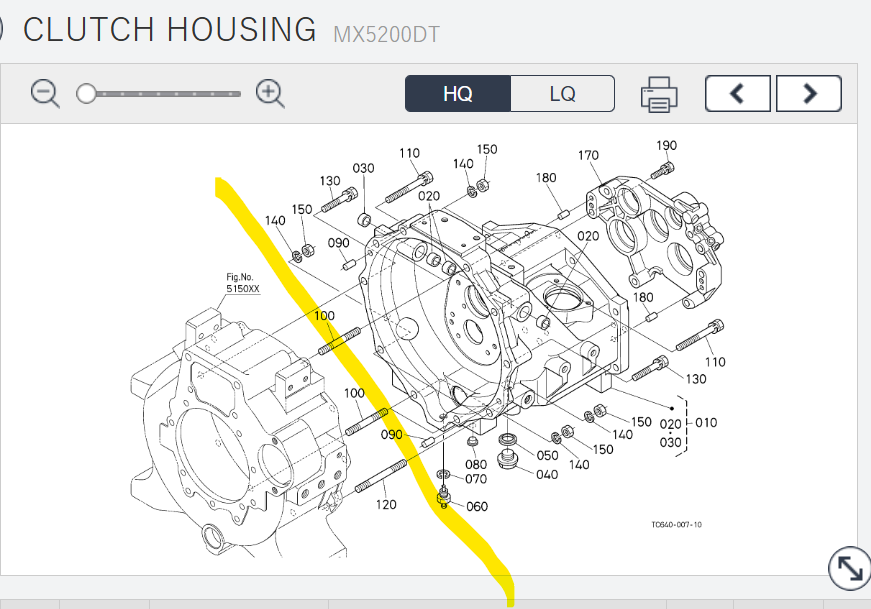

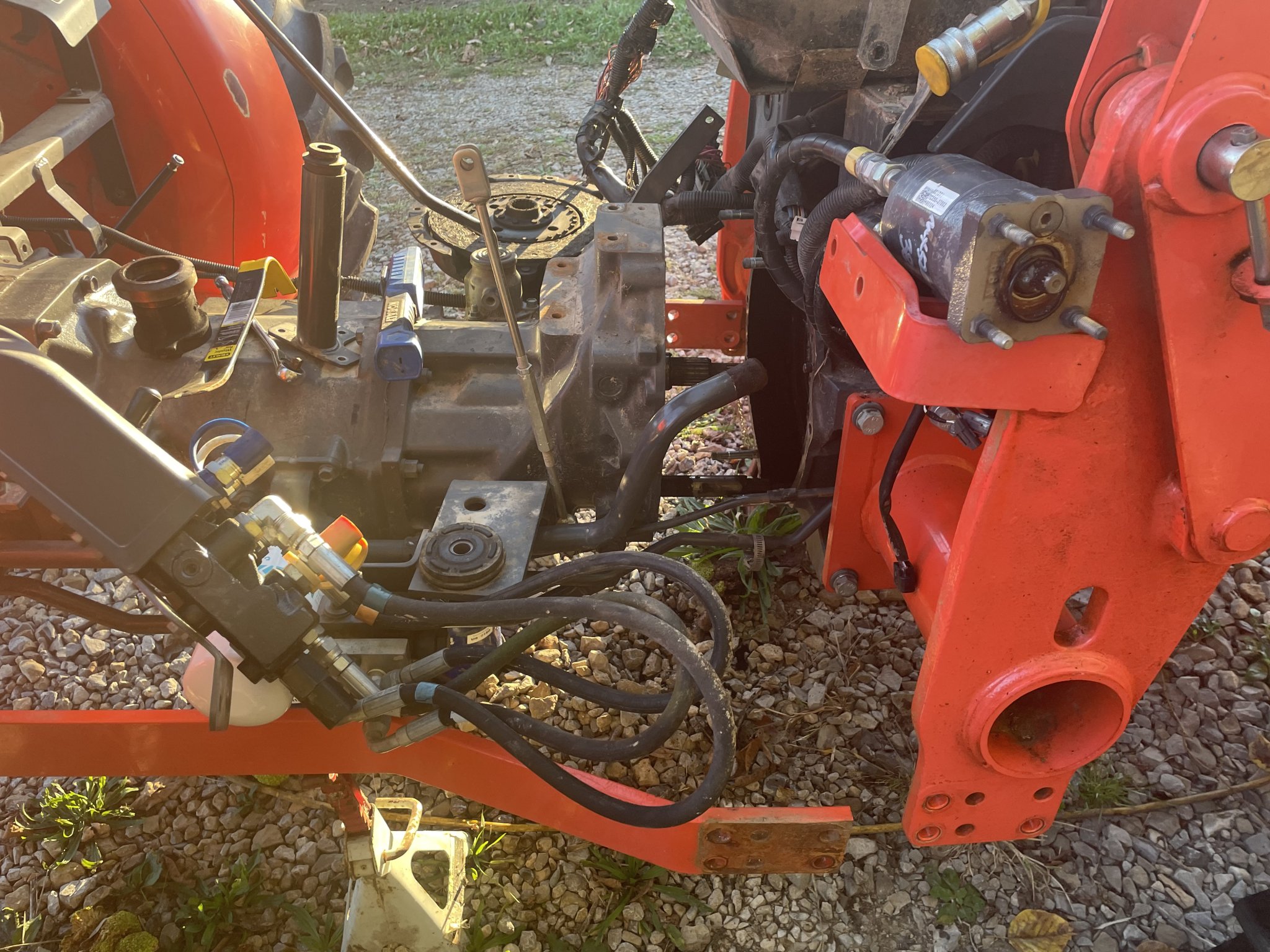

I’m splitting mine now in the manual it calls for removing the loader, the battery,the starter,the fuel cell, and engine components and wiring can I getaway with spitting the tractor just behind the bell housing. It looks as though I can and it will give me access to the clutch
crobins
mx5200
Aug 18, 2025
14
mcconnelsville, ohio

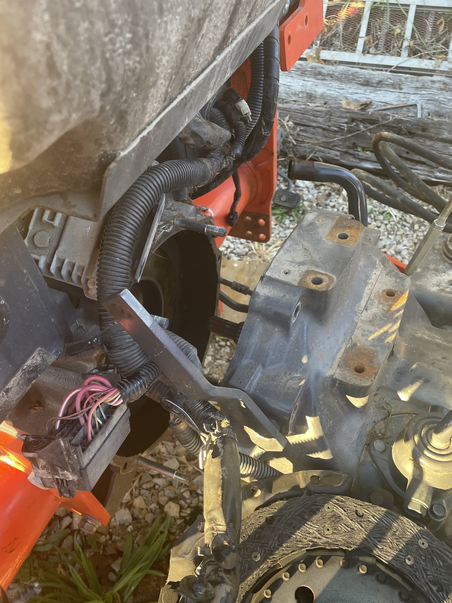

Ok that’s where I’m spitting it I didn’t see the need to remove all that but now I have it about 1/2 spot and seems to be hanging up a bit I’m going to try prying alittle just came in to get a flashlight to make sure I wasn’t going to destroy something
Did you pull the front propeller shaft out?
7,113
2,545
Did you block the front axle and the engine so it doesn’t flop over on the pivot pin when you get it split?

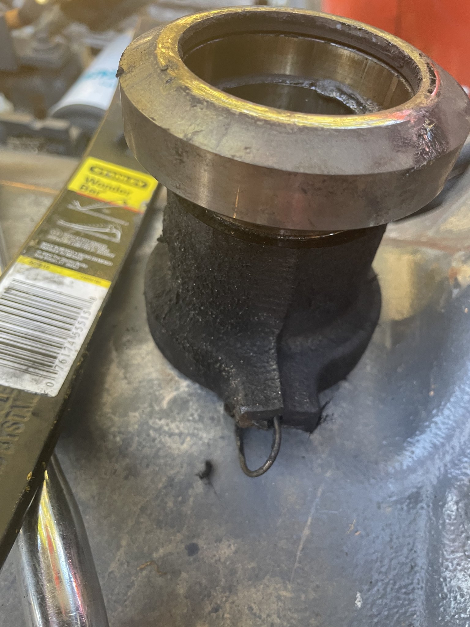

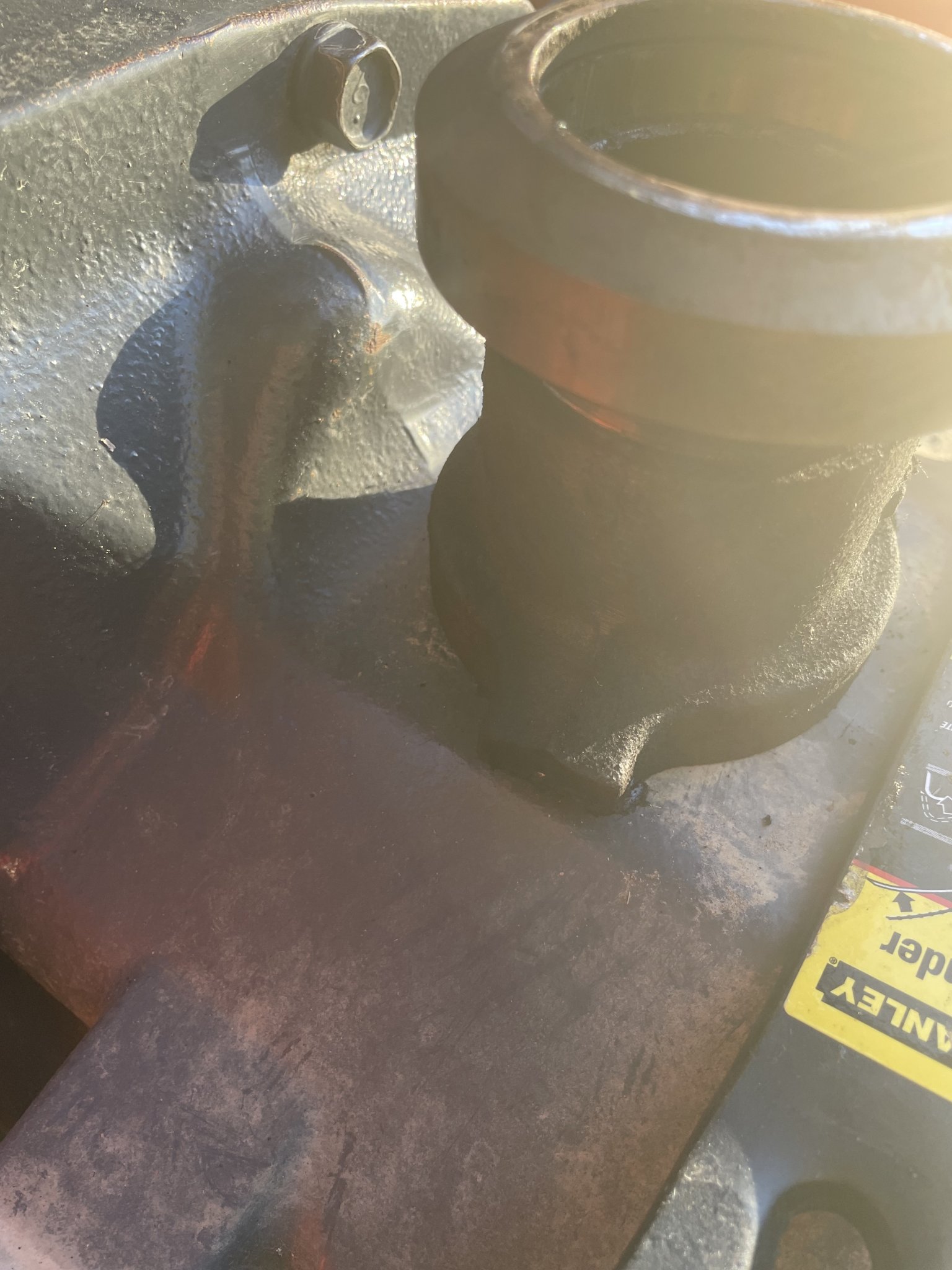

It came apart the clutch is worn out. I have a new one but I will also need to order a pressure plate and a throw out bearing. I think the housing that the bearing slides on has a clip missing on one end and it was popped off on the other the bearing itself was not free sliding on the housing the clutch completely wore through on the pressure plate side but still good on the flywheel side.
