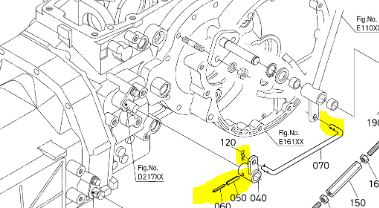

I suggest 1st thing to do is check gear shift linkage. Does gear range control lever have an resistance when attempting to speed change ranges?

You most likely have a linkage issue.
check that the linkage is attach at both ends and even more importantly that it hasn't sheared the roll pins and is just rotating on the shaft.
If it's neither of these then you're looking at doing a split to repair internal damage.

All the linkage looks good and moving freely. Talked to a service tech he said to change the foul filter. Does this sound correct? But I'll try it tomorrow.
