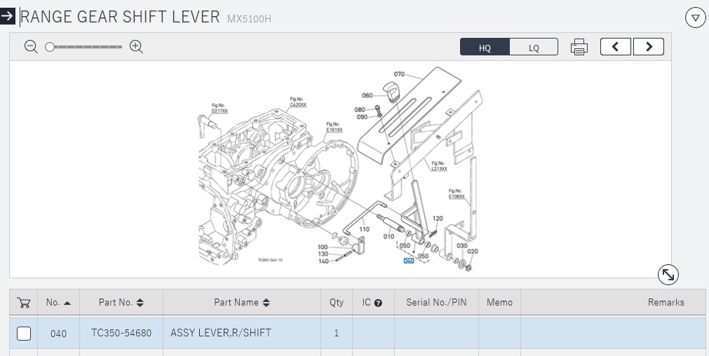

My guess would be the range shifter is disconnected somewhere and is between gears. Taking off the platform takes some time and may not show much - Cover 070 comes off with 2 screws. Worth a look-see in there before diving deeper.

Disconect item #110 in the drawing above put a adjustable wrench on #100 and rotate it you will be able the feel if it is moviny the gear clusters in the gear case. You can do all this from under the tractor.
