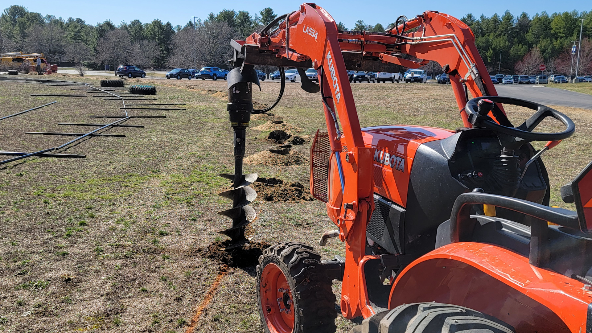

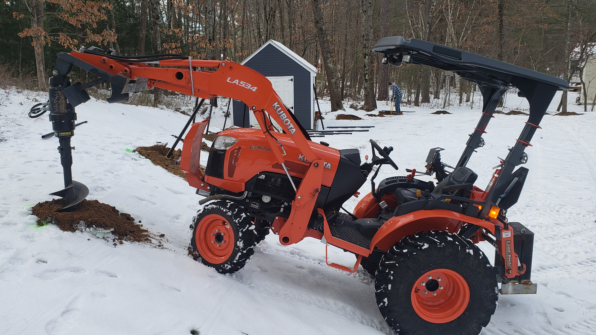

I have literally drilled thousands of holes with my hydraulic auger on my B2650 with only 5gpm flow. You should be fine.
Up here in NH the pto augers spend more time stuck in the hole than they do drilling. NO down pressure, NO reverse, NO control, NO comfort, NO THANKS!

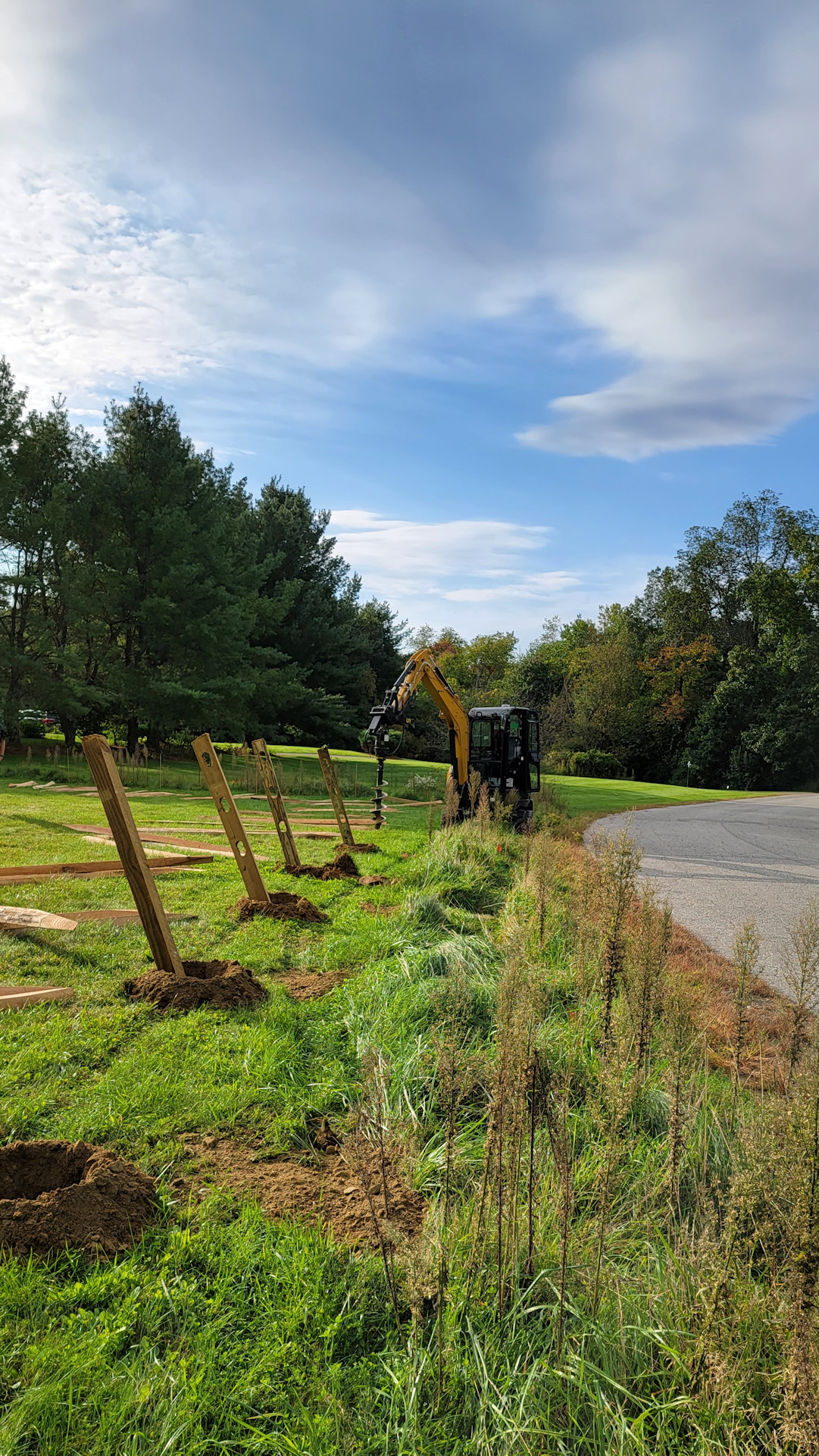

If I have really nasty digging to do I will use my mini excavator because between the auger, the bucket and the hammer there is no hole up here I can't do. At the same time the tractor is a lot lower impact than the mini is on the ground and landscape.
12in bit - 65 holes for a baseball field 90 minutes from load to load.
For speed and power, the mini wins.

Nice ballast and fire extinguisher set up…how much does the block weigh?
