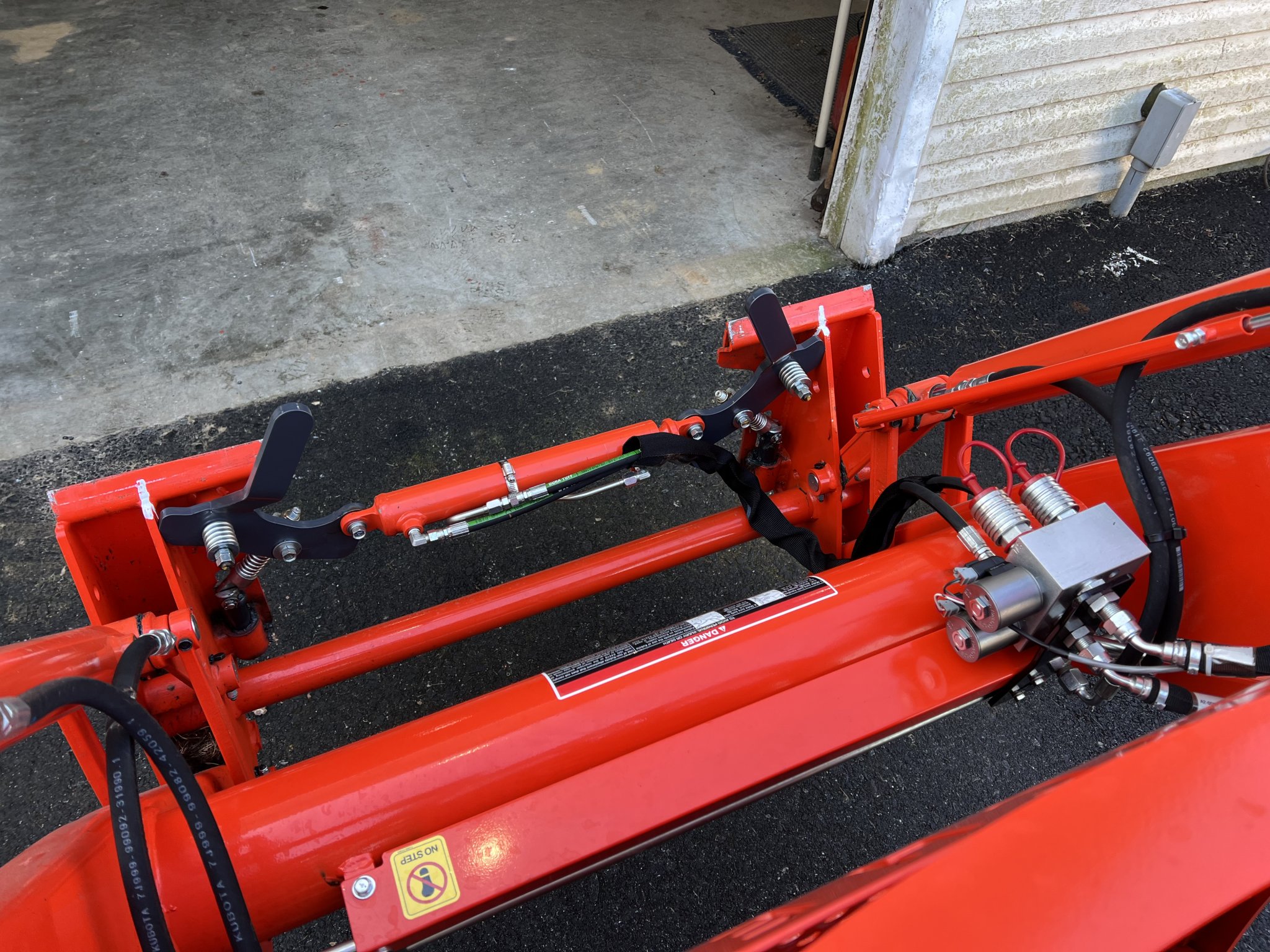

Well I put the final touches on the Hydraulic QA Coupler for my MX series tractor this morning.
Added the cylinder cover and the decals. :)

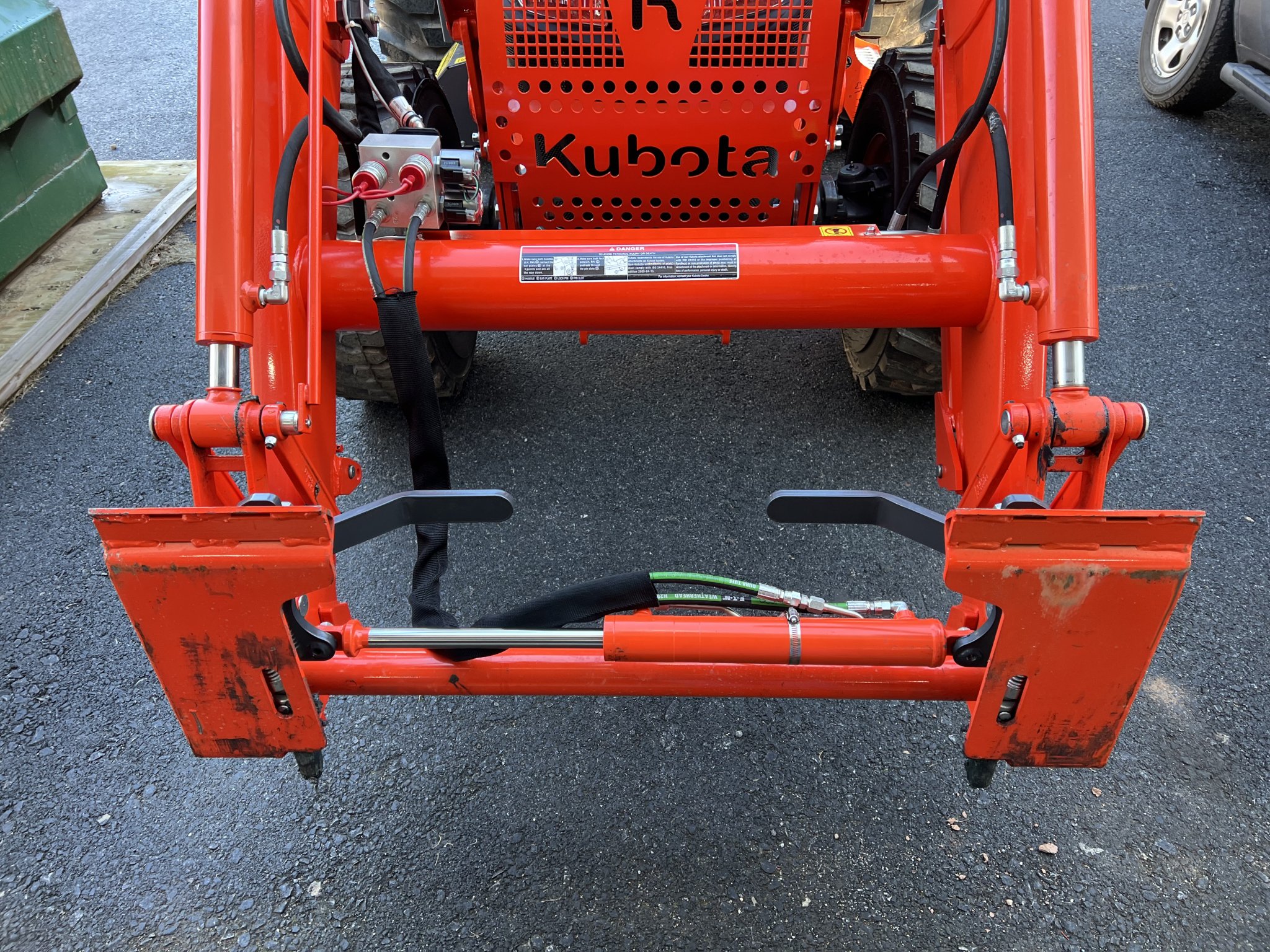

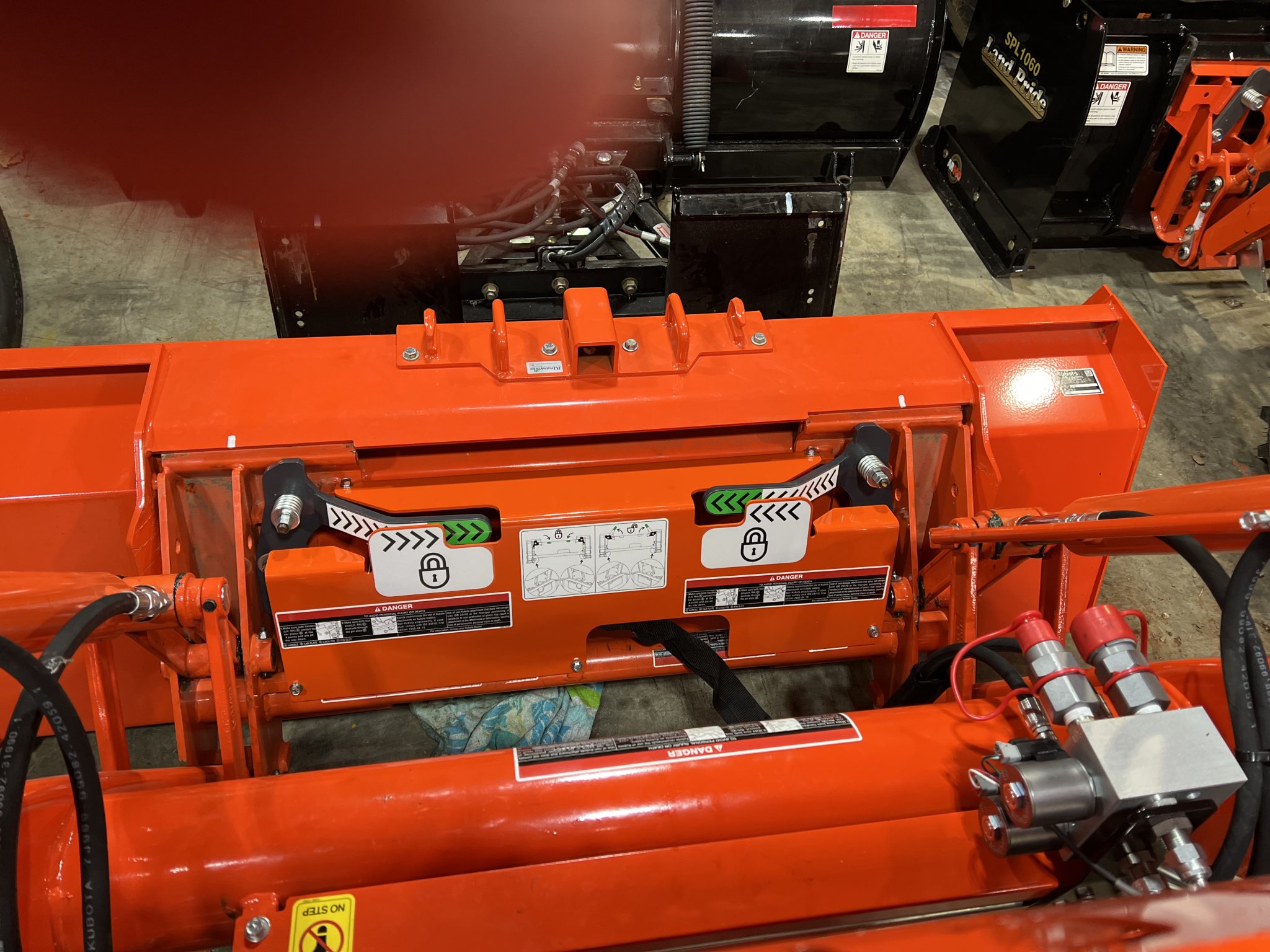

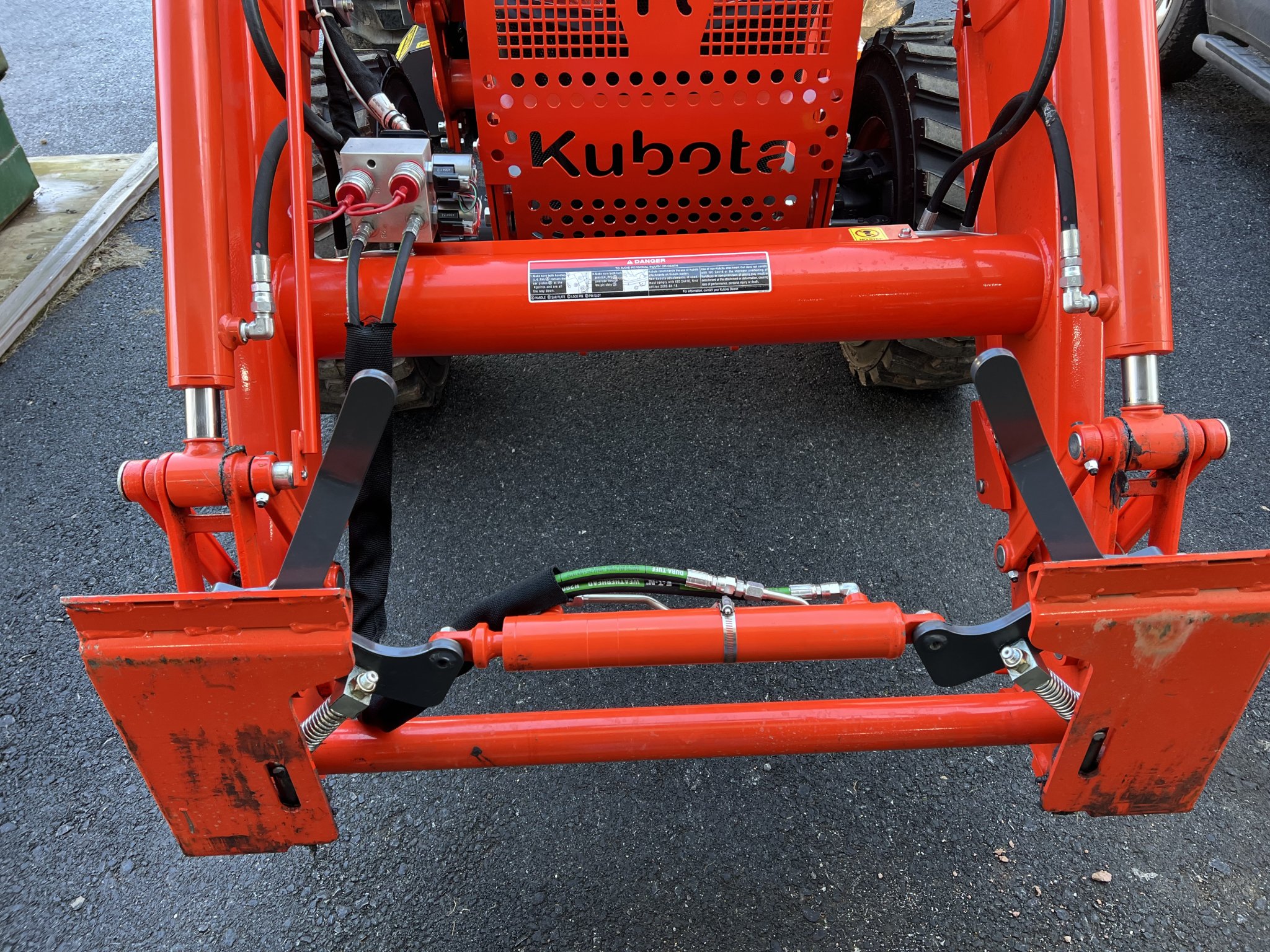

Well I finished the hydraulic coupler project and it functions perfectly I'm really happy with it :)
Below are a few pictures of it in different positions. It's really nice being able to just toggle between the 3rd and 4th function depending what you want to do and then just use the buttons on the loader control to operate the Q.A. coupler (4th function) or grapple (3rd function)
