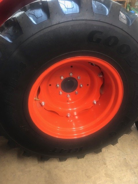

Your R14 wheels should be adjustable. Post a picture of the wheel.

That is their almost widest setting. You could move the disc to the other side of the bracket in wheel and gain the width of the bracket.

That's the same wheel set up I have on the MX and I like it. You have the same set up too right? I can easily get on/off the trailer with 82" between the fenders, and with 600lb of wheel weights and around 500lb of Rim Guard the tractor feels very stable.
Yes, I believe those are the same wheels used for R4 tires.
