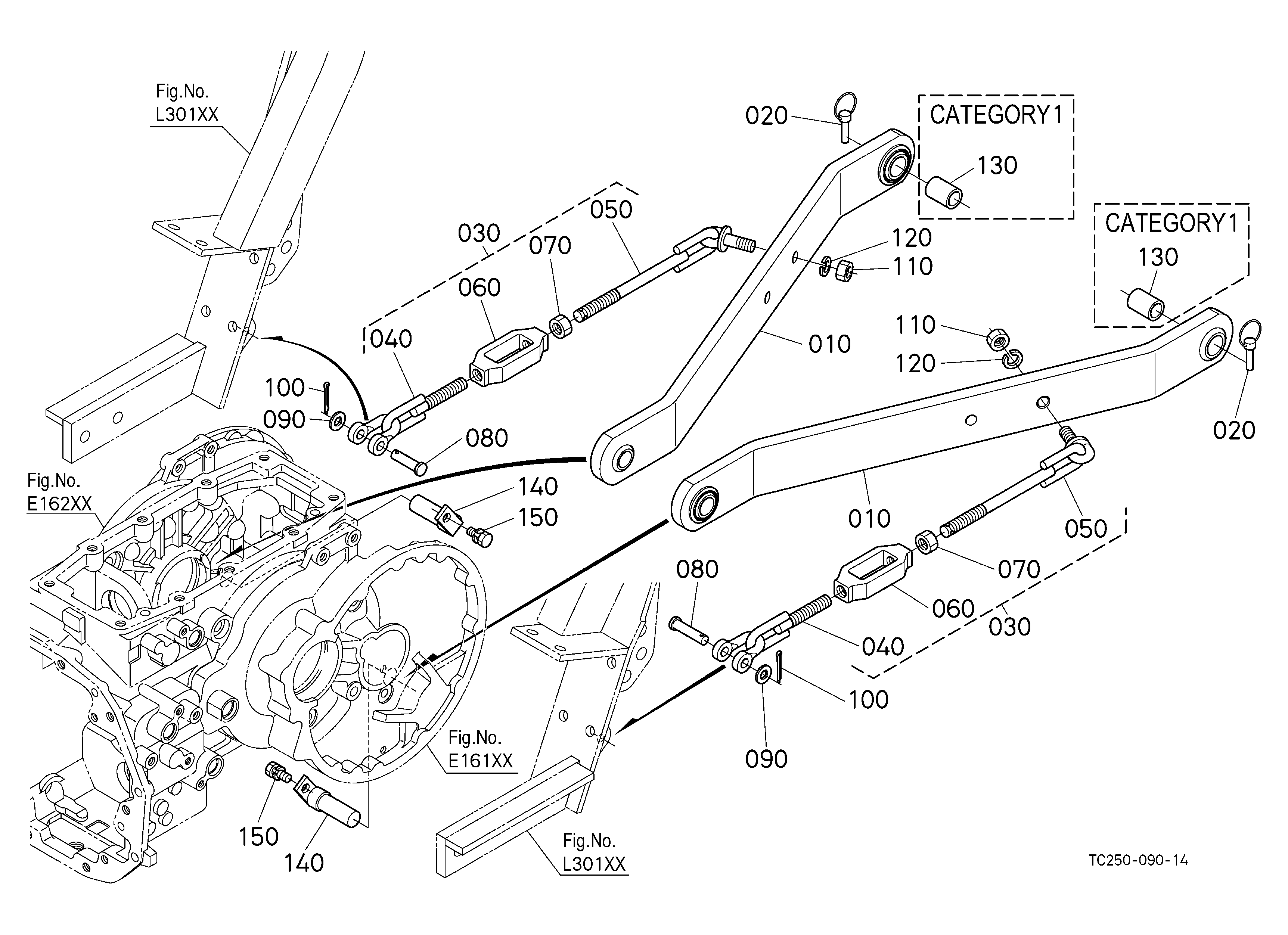

They don’t show one:
You may have to tell us the max/min lengths you’re looking for and perhaps someone can tell you what might fit?

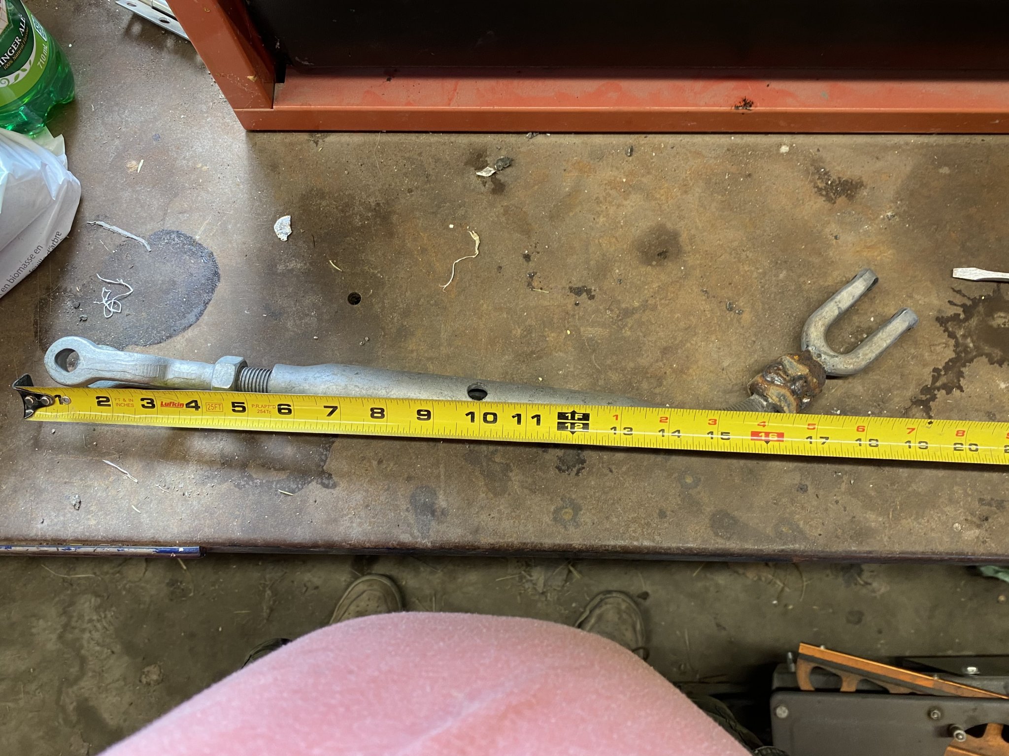

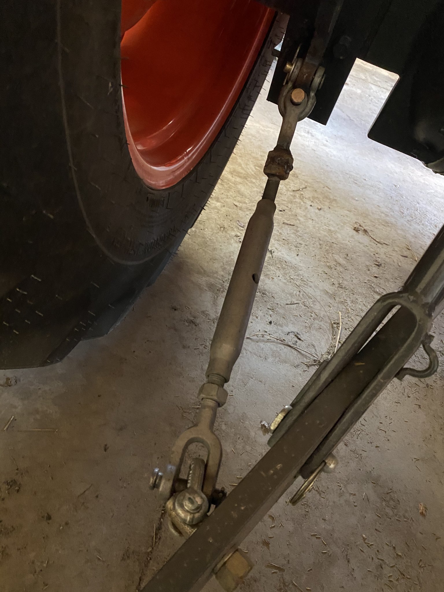

Post a picture of the turnbuckle as you removed it and measure eye to eye. Then post a picture of each end at the attachment point on the tractor.
That information should allow anyone to measure there and let you know if it fits, and on what tractor.
