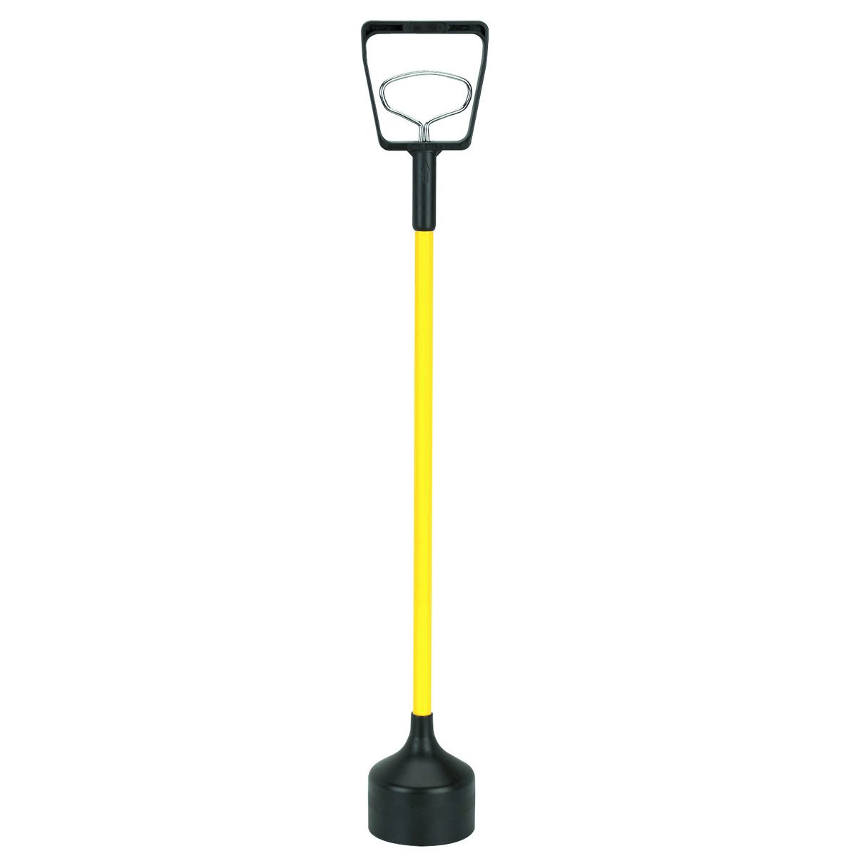

As far as the drilling stuff, what i typically do is stand up some magnets around the hole im drilling.
If you want to pull the 'swarf' (improper term?) off the magnet easier you can wrap it in a paper towel or put it inside a disposable glove. Or, if you have compressed air in the shop ive found that i can 'clean' shavings off a magnet just fine with a blow gun. Obviously, caution and eye protection should go along with that one.
Magnet Tool
I also have a magnetic pickup tool from HF with a quick-release handle that lifts the magnet off the bottom to let things drop off it. Obviously there are magnetic brooms but they're pricier and don't fit all around the feet/pedestals of drill presses, bench grinders, etc. This thing is just a 4" wide magnetic broom that fits everywhere, and then i pull the release while banging it on the lip of the trash can and everything falls in. Very convenient cleaning tool for $12.
Another thing i do with it is if i need to find a nut or bolt out of a bucket of mixed hardware (of which i have many..) i just dump that thing out on the shop floor, spread it around with my hands, pick out the things i need, and then use the magnet to load all the rest back into the bucket in 5-10 passes vs picking up 200 little pieces by hand. Ive also used this method just to clean out buckets of hardware that sat for years accumulating dust because the magnet wont pick up the dust. So you dump it all out, magnet it back in, and sweep up/out all the dirt left behind.
