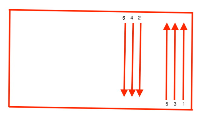

This is how I used to do it.
First pass at the edge. Second pass after a comfortable turn. Third pass next to the first, fourth pass next to the second. Same large turns all across the field.

And you were posting while I was looking for online patterns, then drawing. :)

After posting this I lay down for a snooze and let my mind picture it and came up with the same pattern, makes sense to just "shift across" an easy, open rectangle and use the "spare runs" to clean up any fiddly bits (none of my mowing areas are regular shape and are undulating, steep or have rocks/small clumps of brush etc scattered throughout)
Ill give it a go this week as I have 10 acres of weed regrowth to tackle...

Pretty interesting - I started flail mowing commercially 6 years ago, and of course started at the perimeter and then kept going around until I got to the end which was usually a small section with tighter and tighter turns. I realized these sharp turns took more time, and eventually "came up" with the idea of mowing parallel sections on my own. It made sense. It doesn't work everywhere, but usually a couple of passes around the perimeter to start followed by parallel turns is the fastest way.
Bruce
Common pattern once used for plowing/discing with "large" trailing plows/discs in large or at least rectangular shaped areas.
