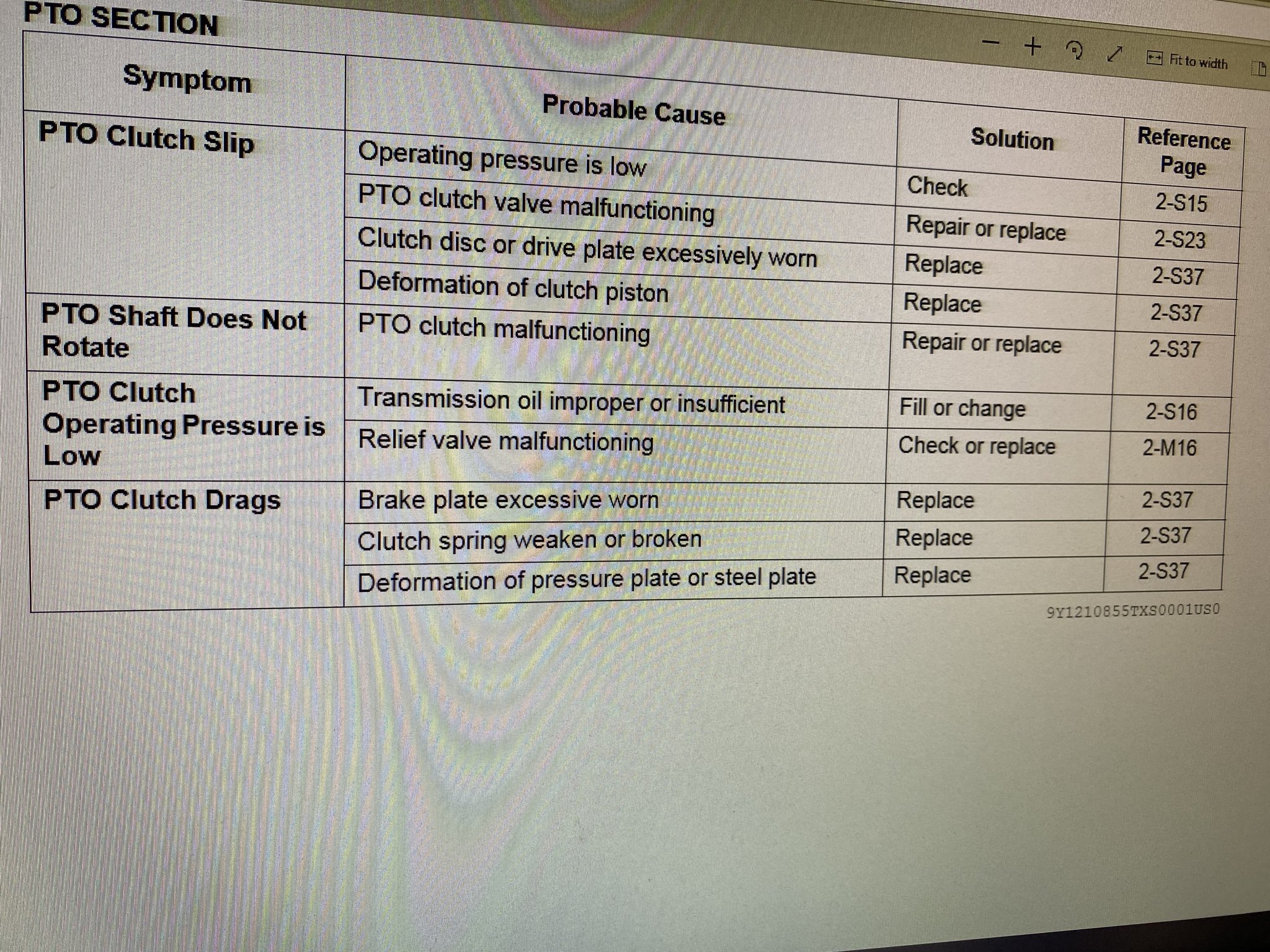

Clutch. This is what I was afraid of and not what I wanted to hear! Two commentors above say the same thing. And to confirm it this morning I enlisted some help and found some very heavy grass, crawled along beside it while it was mowing and watched the drive shaft {reconfirming this is a belly mower}. Blades stalled completely, so did the drive shaft. Belt never seemed to slip.
The clutch inside the trans has to be either failing or the hydralic valve that engages the pto clutch is faulity. Or even the pto lever linkage needs adjustment.
The first two are beyond my ability to repair. The linkage? Maybe. If anybody has an idea how to adjust that let me know. I've crawled under it and don't see anything that is adjustable.
Reminder that this is a BX2375, not a full-size tractor.
I'm going to limp though the rest of the summer season then take it to the shop this fall when it's slower at the shop. This probably will not be cheap!

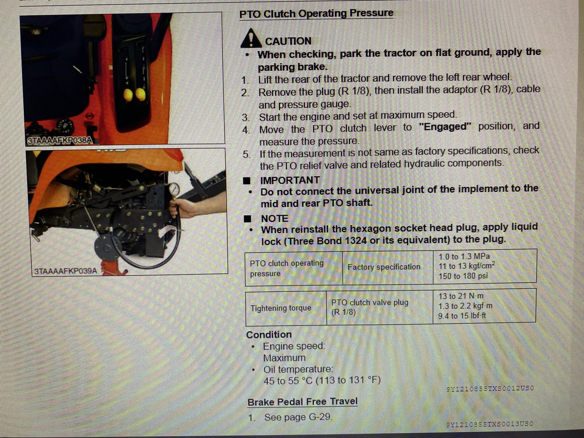

Thanks tinker. That helps. I've ordered a hydraulic pressure tester as I'm quite sure my pressure is down some. Lots of whistling and the bucket doesn't seem to lift as much. This one hooks up directly to the front implement connections and checks hydraulic pressure.
Now you are probably going to tell me that is a different reading from the clutch. Hope not. If it is, I'll get that kit as well. I don't mind buying tools. Cheaper than the Kubota dealer!
Edit: From reading around it appears the clutch is a separate system. And, that the clutch valve may be the culprit. I should be able to find a gauge for that somewhere.
If it reads low, I'd like to pull it off and clean it first, as some threads suggest is is prone to being clogged. Is the valve hard to change out? Mixed reviews online. One says ten hours!
It takes 3 - 10 seconds for the PTO to engage. Reading suggests it should pretty much be instantaneous.

Yes the clutch is separate place to test. Check pressure first before pulling things apart . What you need to do is order or download PDF WSM for your bx 2370. There are other hyd pressure test areas for different systems on your tractor.

Morning: So after discussion above and a bunch of other reading, I need to check the pressure in the clutch. I cannot find a premade pressure gauge setup. Anyone know of anyone who sells them? I've got one on the way for the bucket hydraulic circuit. Not interchangeable, plus the specs for pressure are much lower for the clutch and it should be a gauge that reads up to 200 PSI, not 2000.
If I have to assemble myself, can I use a standard gauge like you'd use on a well pump?
