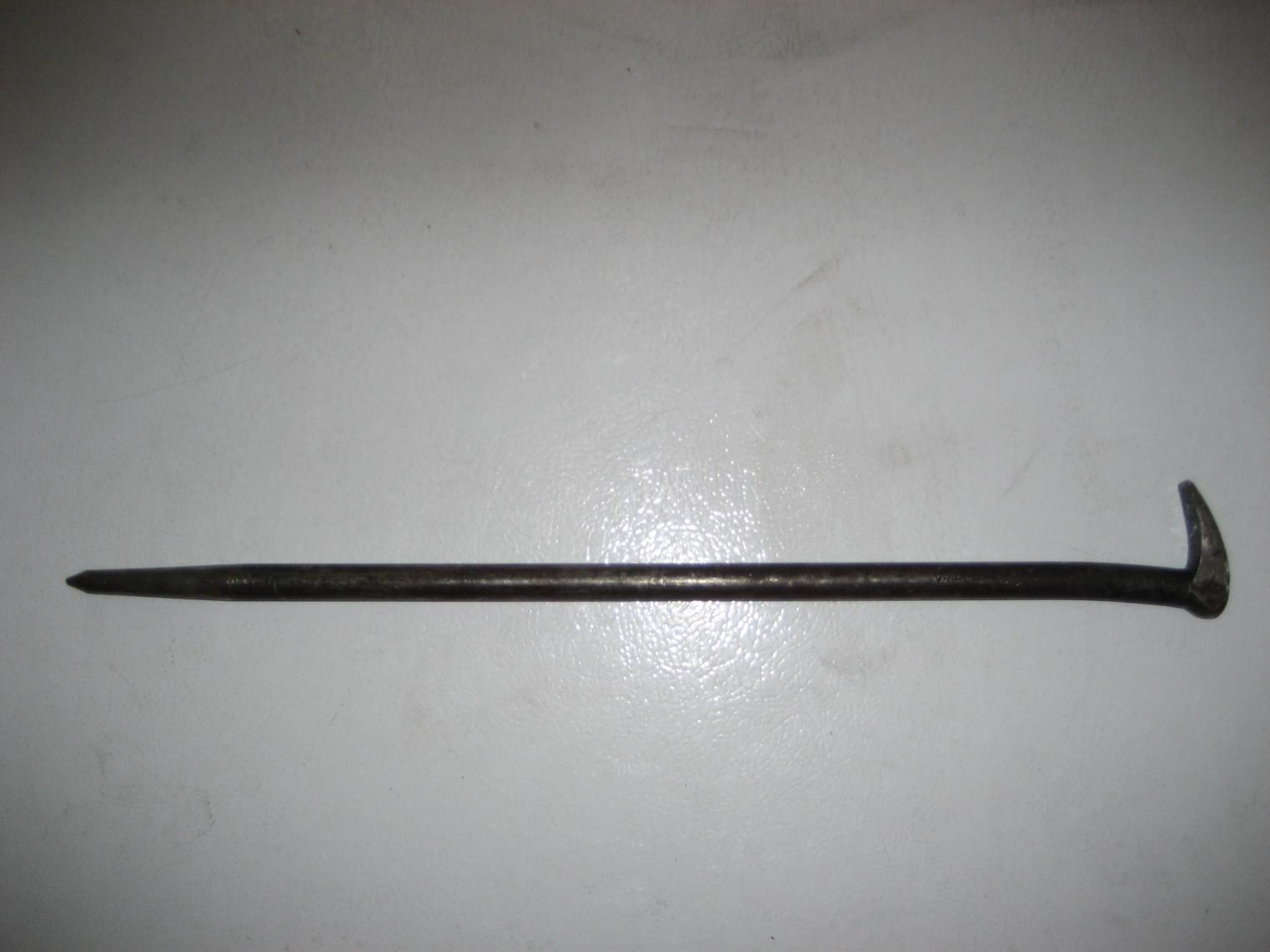

I bought this pry bar as part of a set from Harbor Freight many years ago. This one stays permanently on my tractor. I use it for so many tasks including releasing tension on the mower deck belt idler pulley.
