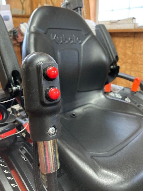

I've been irritated recently because when lifting my blade or bucket from the ground, my loader stops, jerks, and stutters. Come to find out, I'M doing it!
My 3rd function buttons are on the front of the joystick knob (see photo). My fingers tend to at least brush the buttons when I lift my loader. When I grab the stick below them and lift, smooth as silk. But I like, or have gotten used to, keeping my palm on the knob with my fingers hanging down. Used that way, or with my thumb over the knob and fingers wrapped around, I have a problem. Reaching down and grabbing the stick feels wrong.
Does anyone know if I can loosen some of the screws shown and try turning the buttons toward me on the tractor? I'd try using thumb to hit them. I think that would feel more natural. And even if it doesn't, I use the blade and bucket lots more than my grapple. It's a Land Pride 3rd function kit, but since the dealer installed it I don't have manuals. No indication what the wiring is like in there.
View from front showing buttons:

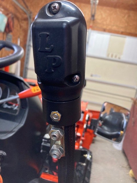

View from rear, showing more screws:

hitting the 3rd function buttons while nothing is hooked up to the ports shouldnt effect the loader operation. At least it didnt on my B2601, with the kubota 3rd function.
to twist the handle, insert allen key into stud, loosen lock nuts, rotate handle being mindful to not tighten the pins onto the wire running up the inside of the handle.
I have same control knob / buttons that you have on an "L" and the buttons point towards my right hip.
Simple loosen and twist should do it.
When operating my grapple lid the lift/curl is still smooth and very controllable.

Thanks, boakley! Will try it. Gently . . . I want my buttons where you have yours, pointed to my right side.
that’s exactly what I did to mine. just Turned it 90 and use my thumb to hit the buttons.

"to twist the handle, insert allen key into stud, loosen lock nuts, rotate handle being mindful to not tighten the pins onto the wire running up the inside of the handle."​
Thanks, 737. All I can say is the buttons seem to affect my loader when I hit them while raising the bucket or blade. A Kubota tech said that was my issue, and I conformed it by pulling back on the stick making sure I didn't hit the buttons, and no problem.
But now that you mention it. how IS that possible when the 3rd function hydraulics are not attached!!!?

Depends on what type of third function you have. If it's a diverter, when you hit the button you cut the loader circuit out and direct the flow to the third function hoses. It doesn't matter if there are hoses connected or not, the flow is directed to those ports, and cut off from the loader ports.

I have the Land Pride 3rd function that looks like the one the original poster shows in his pictures. When one of the buttons is pressed it diverts all hydraulic pressure to the 3rd function so there is no power to the FEL. It might be handy to be able to operate the FEL and 3rd function at the same time, but that's not how it works.
Also, when mine was installed the buttons were facing out instead of in towards me. After asking on this forum I learned that the knob can be turned to whatever position you like by loosening the two set screws.

Geezer, are the set screws at the very bottom?
