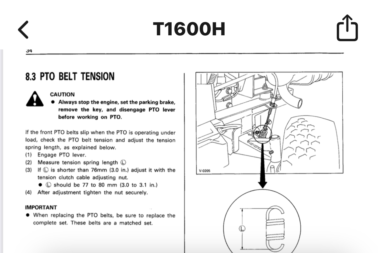

Lug66 Active member Lifetime Member Equipment LX2610HSDC, Z422KWT Jun 7, 2023 117 67 28 SW Michigan Jun 23, 2024 #5 Maybe this might help. Attachments IMG_1958.jpeg 289.3 KB Views: 116
L lugbolt Well-known member Equipment ZG127S-54 Oct 15, 2015 5,444 2,137 113 Mid, South, USA Jun 23, 2024 #6 for some reason I read it as "T1400" which is more like that deere. T1600 is more like the G series in that you can adjust the pto belt tension.
