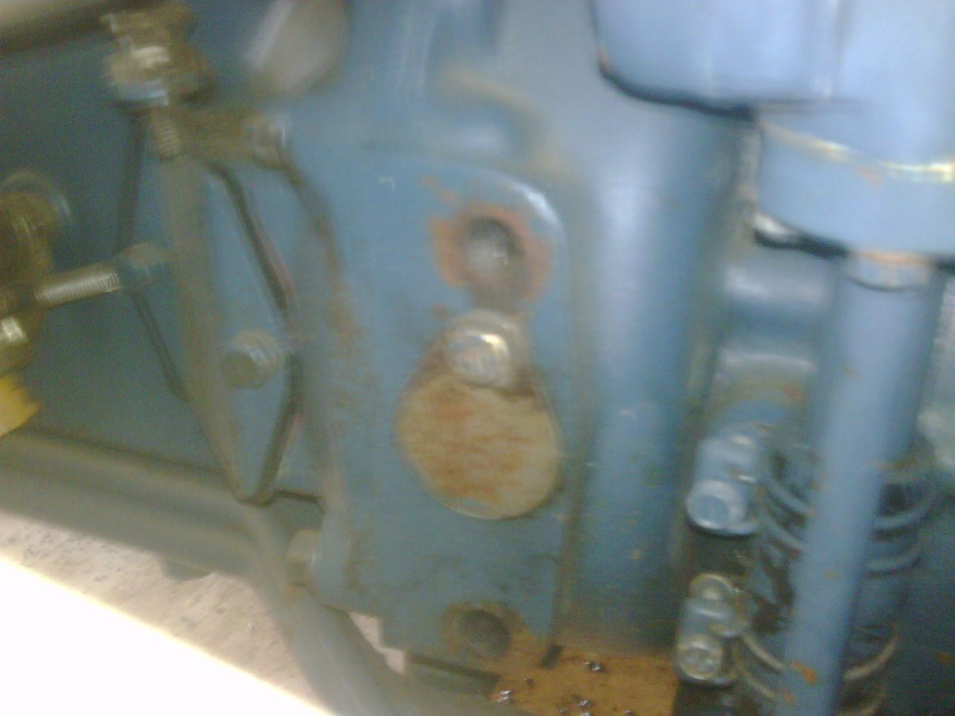

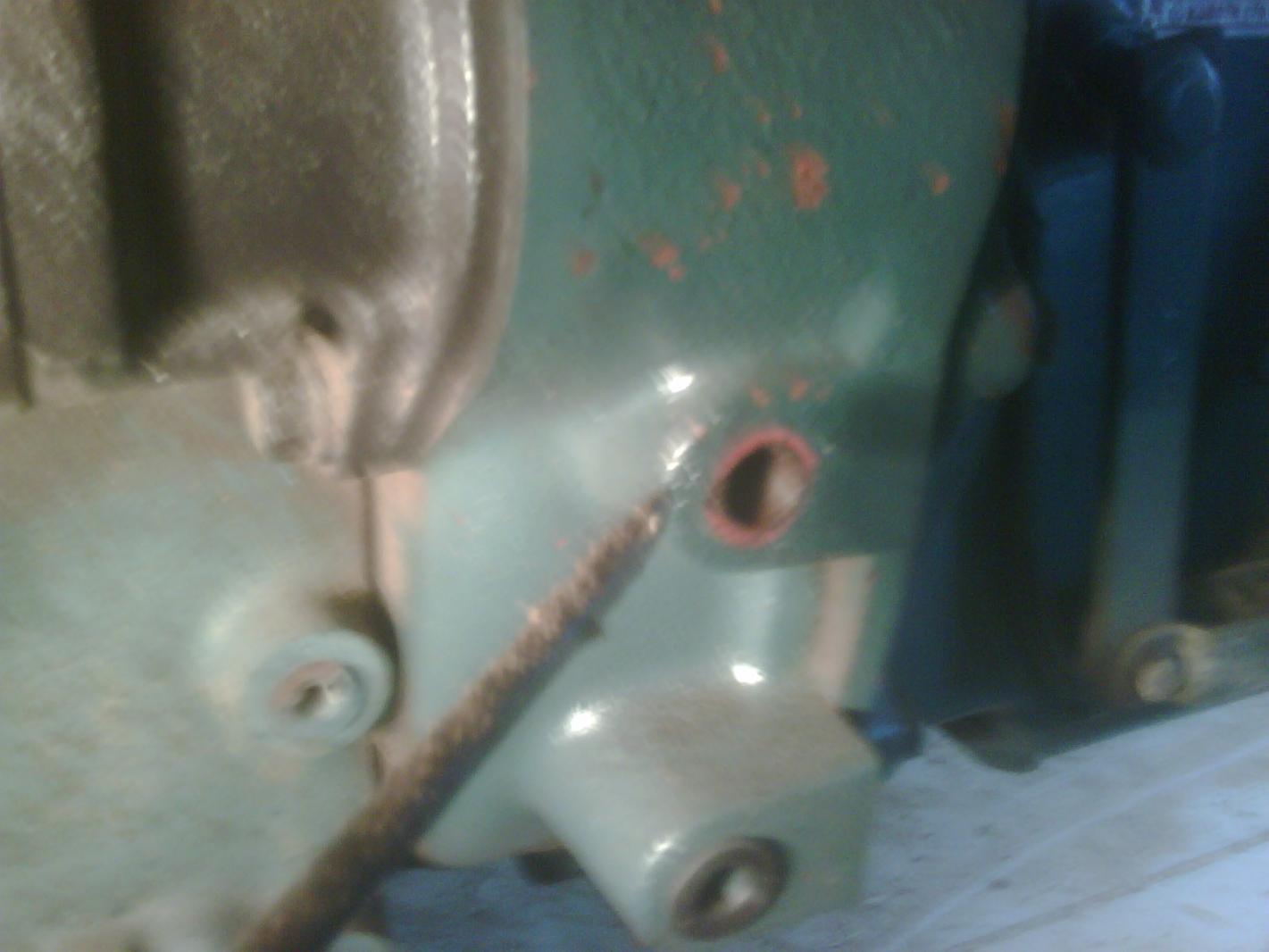

is it safe to use the bolt holes on the side of the trans for mounting stablizer brackets for my FEL? i will be running support back to the axel...
i can take pics of were im thinking if you guys dont already know...TIA

Pics of your idea would be a huge help. But over all sounds like a bad idea to mount anything to the tranny.

Hi Rex. Is that the side of the bell housing. Man I would be scared to death to bolt my loader to those. There are guys on here with L175 tractors they would be able to give you a better yay or nay. But without more info you couldn't pay me to do it. If you are wrong it will be very expensive. Hopefully some one will kick in here who has one with a loader and can give you a solid answer. Good luck and keep us posted.:D dusty

Dusty is right, don't do it. The stress being fed back would rip it right off.
I don't have access to my tractor to take pictures but FEL's have strong structural members that transfer weight and stress to the frame.
The weight of the FEL is supported by the heavy vertical beams and there are also horozontal beams that will absorb loads to the frame. Like when driving forward and digging or going into a pyle of dirt, the lateral load will transfer to the frame. Without this the FEL could twist aft and brake free possibly striking you.
