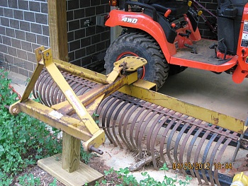

All,
I have a landscape rake just like the one in this picture and I'm going to modify it to fit my quick hitch. I have some ideas, but I wanted to see if anyone has already done this and has some advice. The biggest issue is that the two tabs that hold the lower hitch pins land dead center on the QH lower links. If I don't get a better suggestion, I'll cut off the tabs and weld new ones onto the tube closer to the center and probably add a gusset for strength. Don't have a great strategy to extend the top link out yet.

Modified the 5' KK xb rake to fit my QH. Cut some steel tubing to slide over hitch pins, drilled and ran bolts thru pins to hold longer tubing. Cut off rear support bar, welded in cross piece for support lower in the hitch triangle, enabling an opening for the top link of quick hitch. Slid pin into existing hole. Boom, QH rake.
HighSierra79
B7100d, M6800 w/FEL, 7' mower, 7' box blade, 42" LP tiller, 5' rake
Sep 1, 2013
74
MO
1.) remove round support from top of hitch to swivel.
2.) weld cross support piece at least 10" down from top of hitch to retain strength
3.) determine QH top link height, and adjust pin accordingly
4.).aquire new or used metal tubing(sized) to slide over pins, secure accordingly
5.) enjoy your 10 second hookup

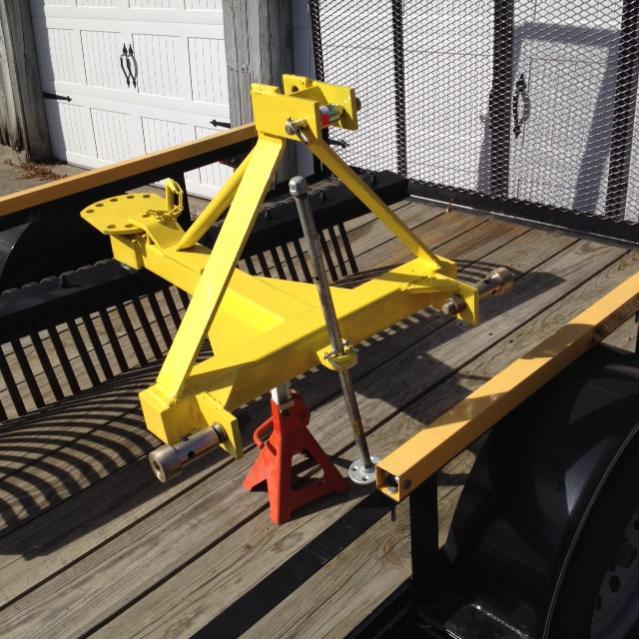

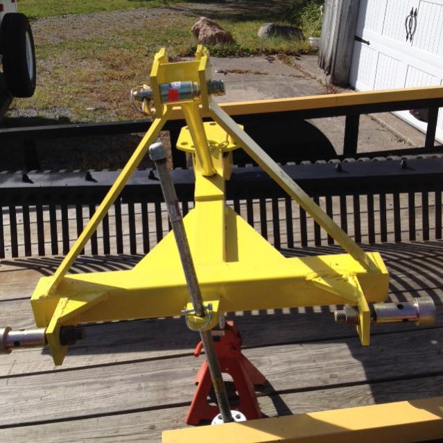

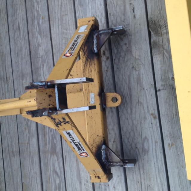

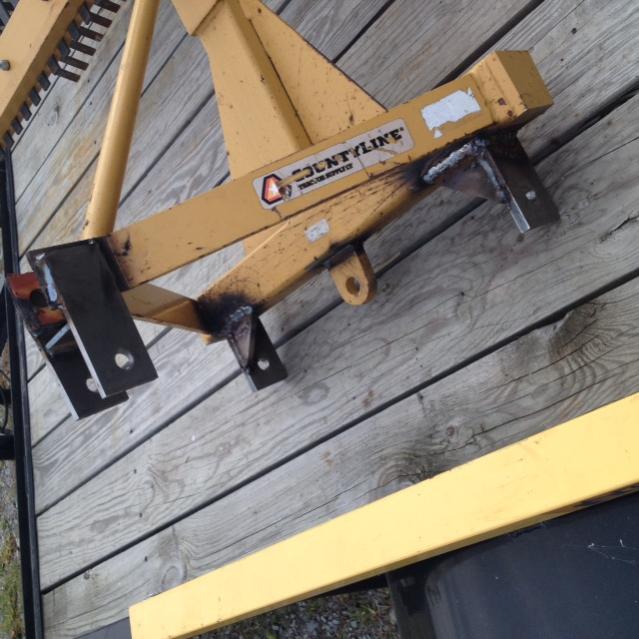

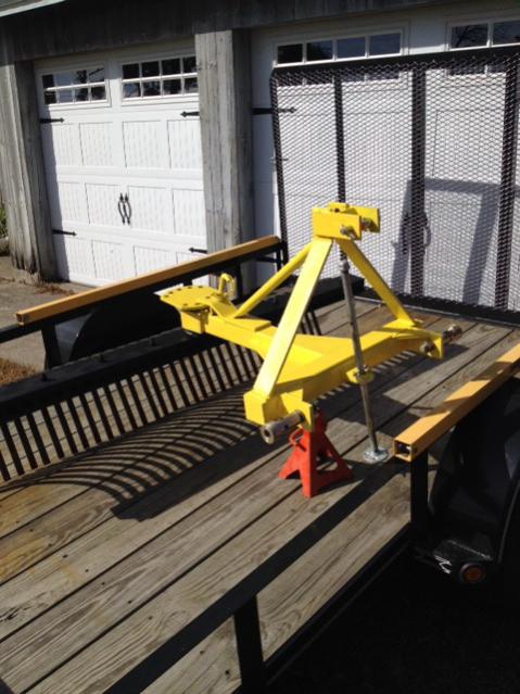

Well it's welded up. Had a local machine shop make up the pieces and got them welded on this weekend. I had to cut off the old lower link brackets on the ends. I welded one of them back in the center to use as a holder for a pipe stand to hold it up. I'll get it painted up and new pins/bushings on and post the final pics.
Builtough
Kubota B2601 with loader, pallet forks, rear bade, bush hog
May 15, 2015
38
Ottawa, Ohio, United states
Here's the finished product. It works well, but I do have use the highest setting on QH top link. Also wish I would have offset the kickstand pipe to one side so it didn't line up with the top link when up. Also attached sketches of the steel pieces I had made at the fab shop. everything fit up well.
