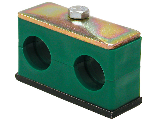

5,183
3,843
I upgraded from the BX2816 (chain drive) to a BX2822 (gear drive) snowblower this week, and the BX2822 was delivered today. It came with the BX2820 electric chute deflector, which also was on the BX2816 when I purchase that machine. I removed the BX2820 from my BX2816 and replaced it with a used hydraulic cylinder from a plow since the cylinders are all the same part number. Today I put the BX2820 electric chute deflector back on the BX2816 getting ready to sell it and put the hydraulic cylinder onto the BX2822. This is when I remembered that I put a 2 hose clamp onto the chute to keep the hoses from tangling with anything on the tractor. I will get a picture for you when I have a chance to do so. Right now, I am burning the candle at both ends. Below is a picture of the type of clamp that I used. Most of these are weldable to the metal, but I cheated and used a longer bolt and bolted it onto the chute. They are available at most hydraulic supply houses. Ask for a weldable twin tubing clamp to match your hoses. The only problem that I see is that your hoses might not be long enough.
