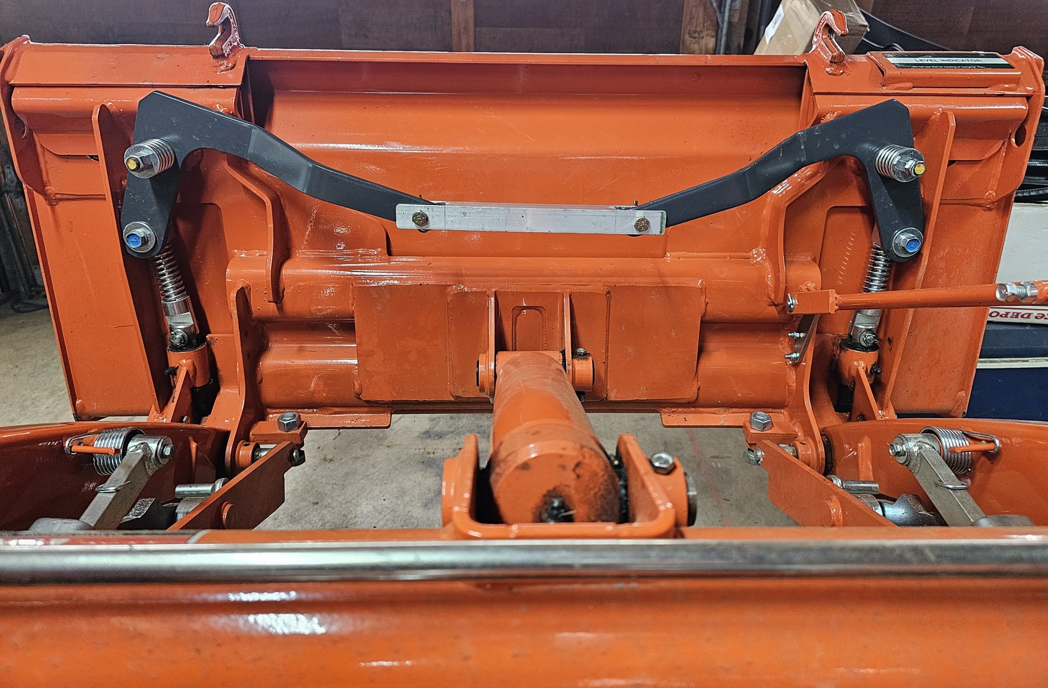

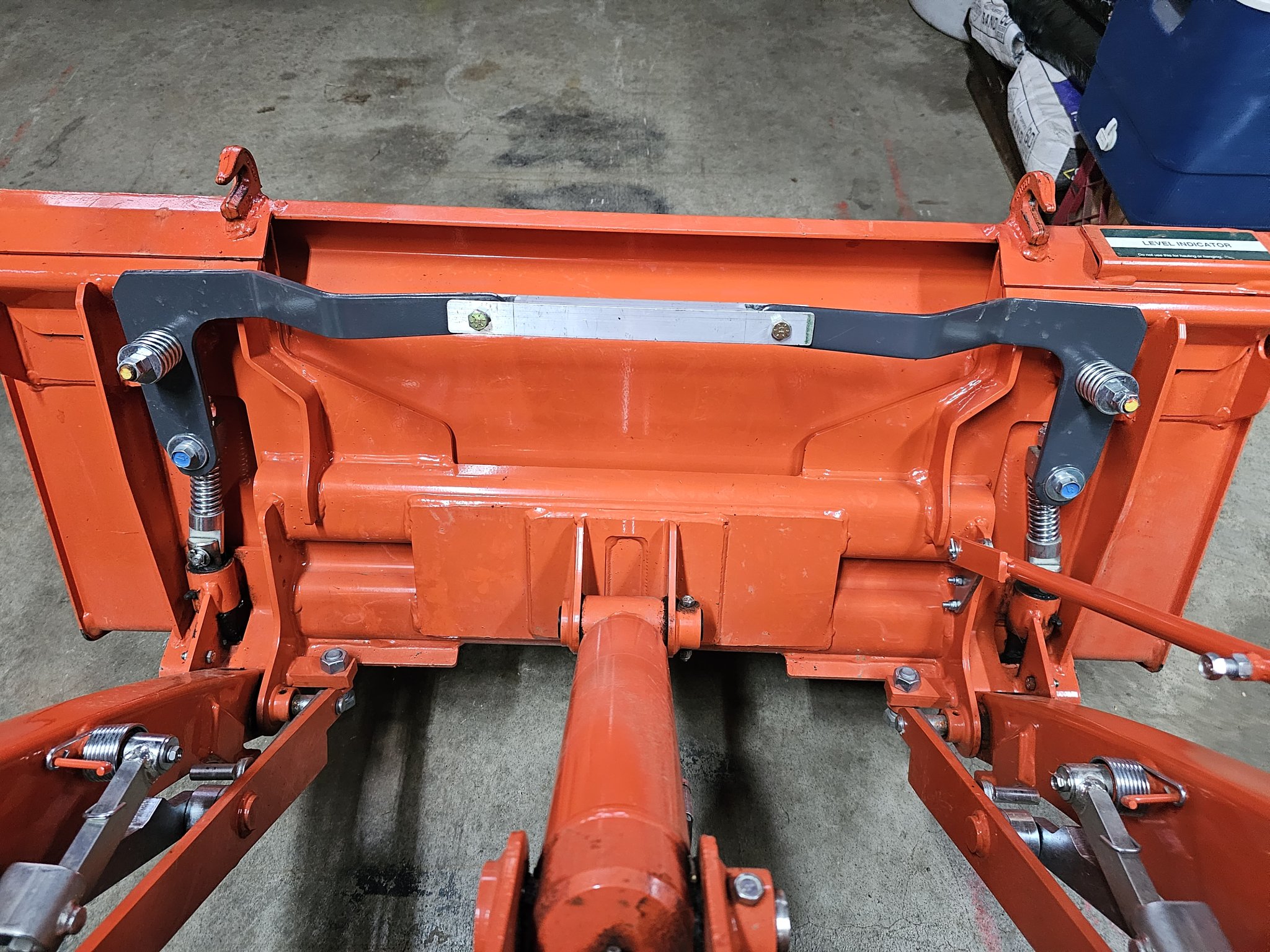

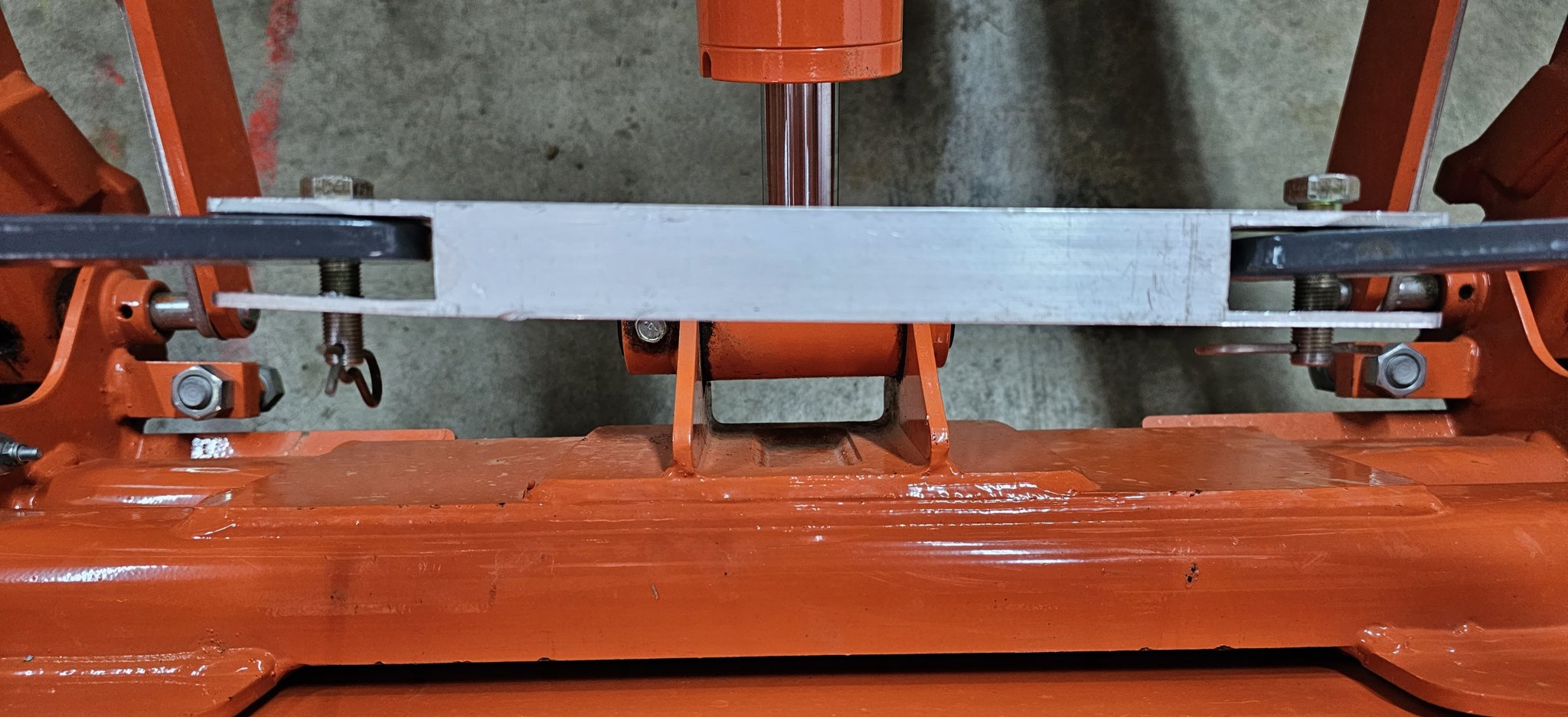

Interesting. Mine have never yet made any move toward accidental release, rather the opposite - they sometimes self-close when I'm going between implements, making the new implement not seat correctly.

I've gotten a lot of feedback from others about my addition as unnecessary. That may be true. The good thing is it cost me nothing to put on there, so I'm out nothing having it.

It isn't necessary until the day that one side comes loose and the damage is done. Then you will wish that you had one. I have a small first aid kit on my BX, and I hope that I will never need it, but it is there should the need arise. Just like a fire extinguisher, you might never have a need for it, but you will surely appreciate it if the tractor develops flames.
