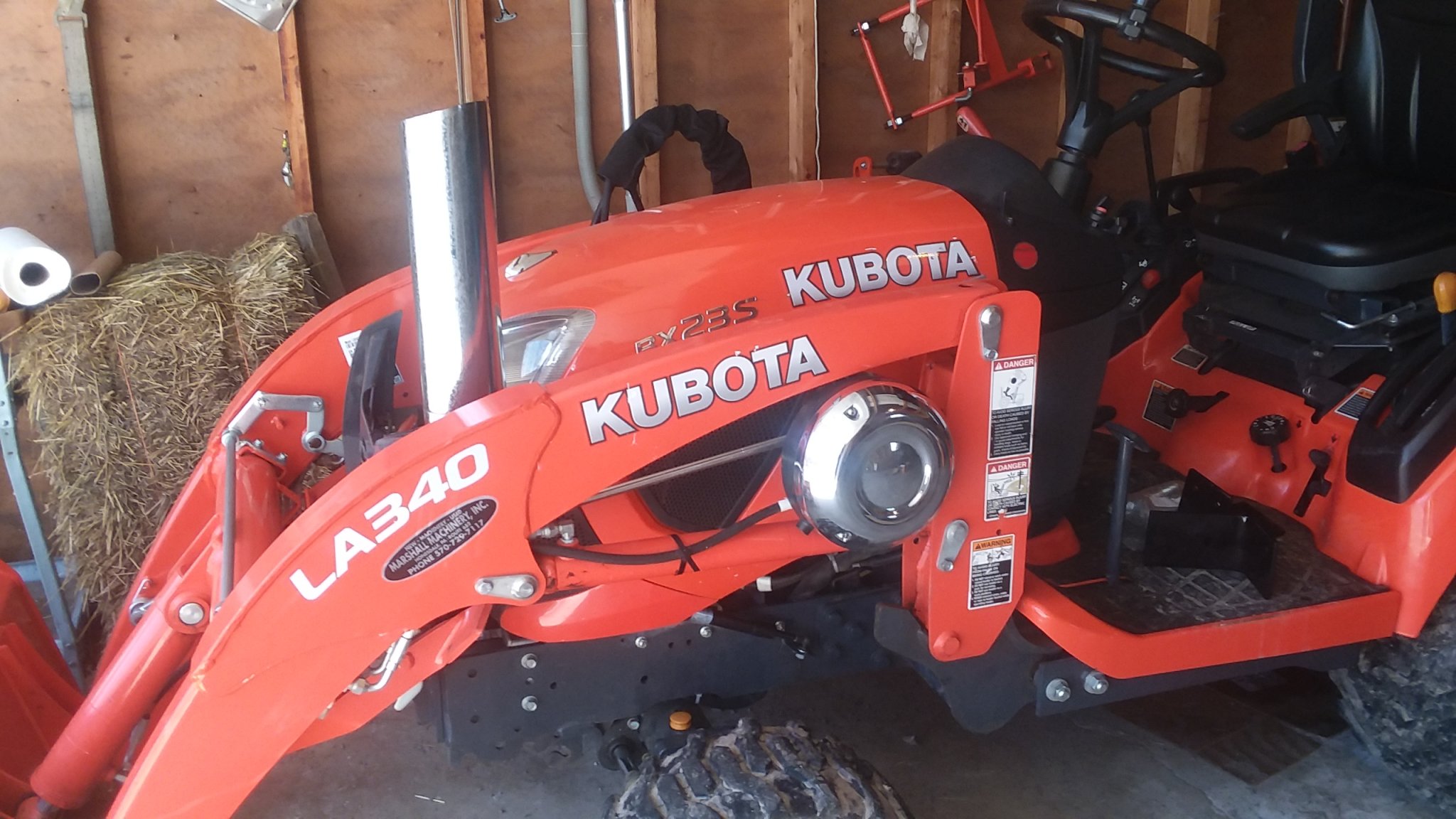

I dug through my goodies and found some Stainless, to route the soot away from painted surfaces.

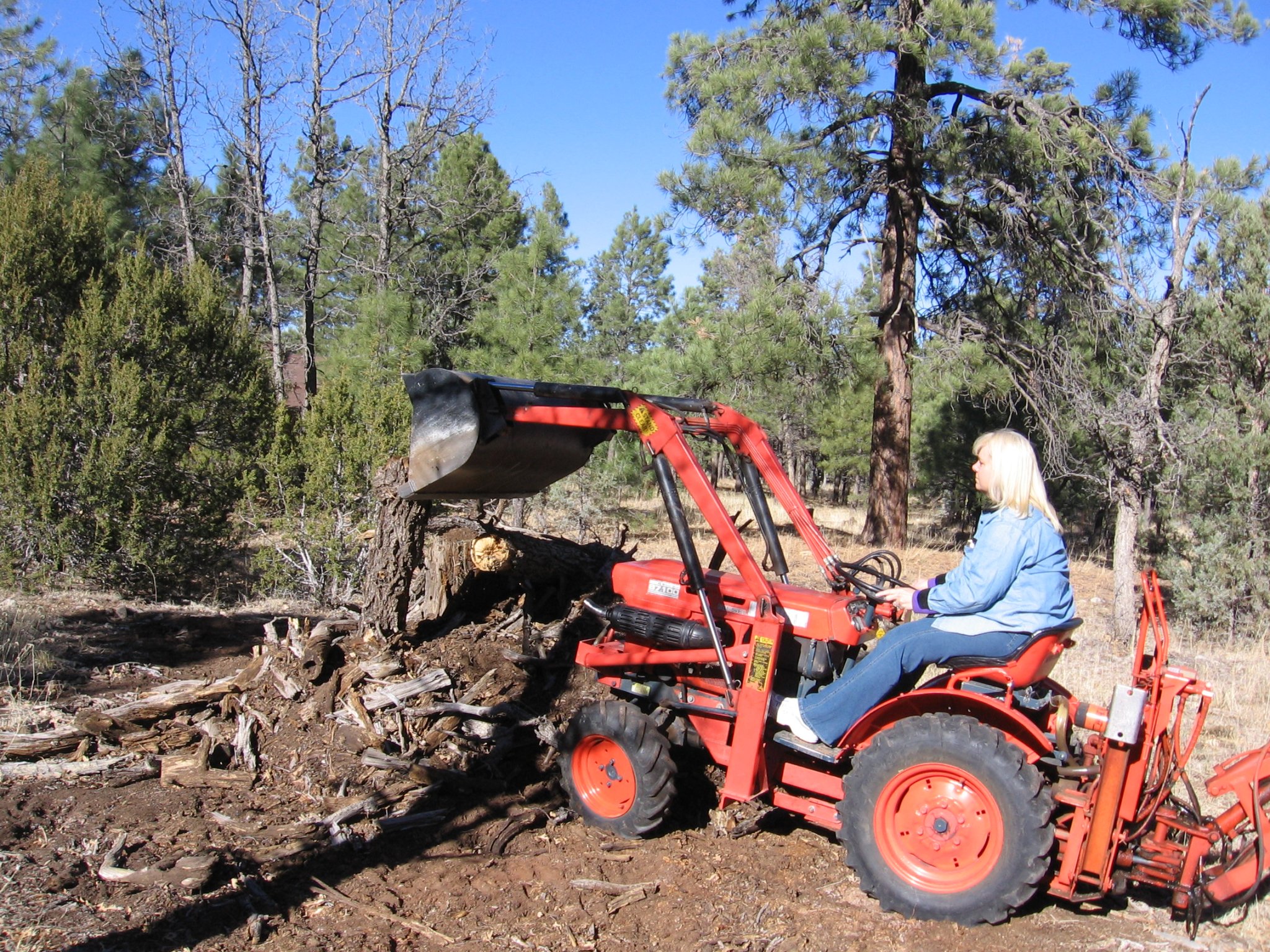

My muffler/exhaust pipe was horizontal when I bought the tractor, where it deposited soot & burned FEL hoses.
But it was easy to flip vertical & add an extension. :)

I found a better solution. I had an FMF Tuned Pipe and Header (4-stroke) left from my racing days. Stainless, and it slips snugly over the stock exhaust pipe. Final rendition is one piece.
Those wanting to redirect the exhaust, you might goto a motorcycle repair shop or motorcycle salvage yard to get a header pipe. Stock exhaust pipe (O.D.) size is 1-1/4" on my BX23S. You need a thinwall tube (1-3/8" I.D.) to slip over snugly for best results. Don't forget to get a clamp while there.
