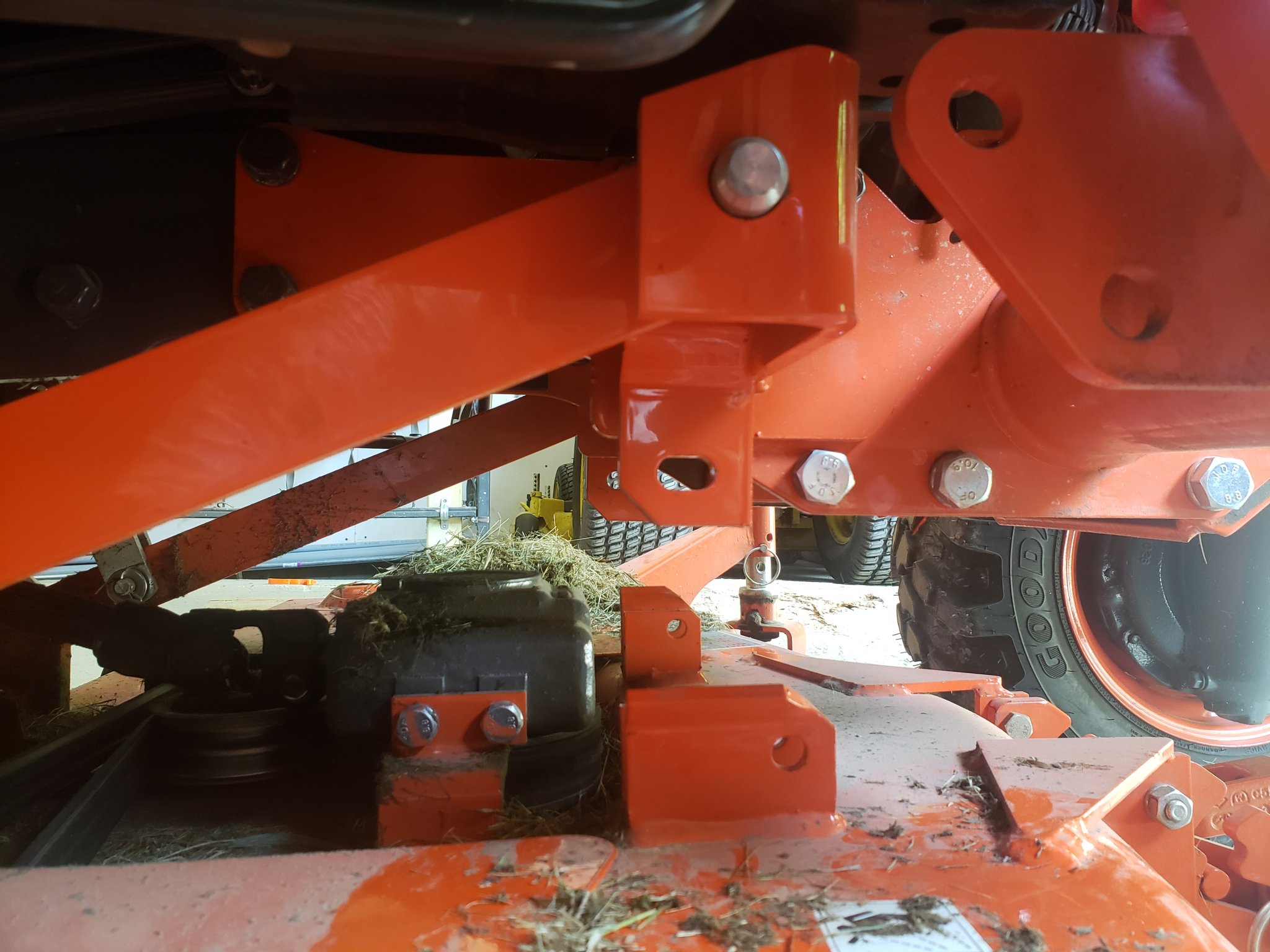

I recenty bought the LX2610 with the 60" MMM and the manual is not very good at all about pining the deck up. Called Kubota customer service and was advised to call dealership(customer service at its finest). The dealership did not know as this is a new model, found a yoiutube video for the B2650 watched that video and found my deck was just bolted on, never setup. Had to remove and adjust rear links(1.5 inches off), front links(.75 inches off), and remove the tuff tire brackets(have the R14T tires.) Then at the front of the mowing deck there is a double bracket that aligns with the tractor frame install clevis pin. I did massage the hole a little bit with a drill bit.

I recenty bought the LX2610 with the 60" MMM and the manual is not very good at all about pining the deck up. Called Kubota customer service and was advised to call dealership(customer service at its finest). The dealership did not know as this is a new model, found a yoiutube video for the B2650 watched that video and found my deck was just bolted on, never setup. Had to remove and adjust rear links(1.5 inches off), front links(.75 inches off), and remove the tuff tire brackets(have the R14T tires.) Then at the front of the mowing deck there is a double bracket that aligns with the tractor frame install clevis pin. I did massage the hole a little bit with a drill bit. View attachment 45710
Very common, CT.
Setting up the MMM properly upon first installation is time consuming and few (no?) dealers do so.
I spent a couple of hours properly adjusting the MMM decks per the installation instructions on both my B1750 and my B3350.
