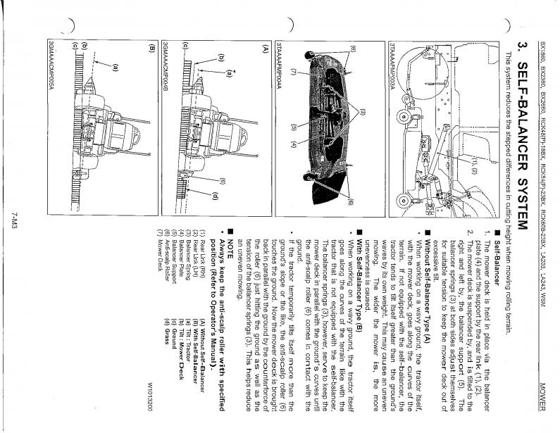

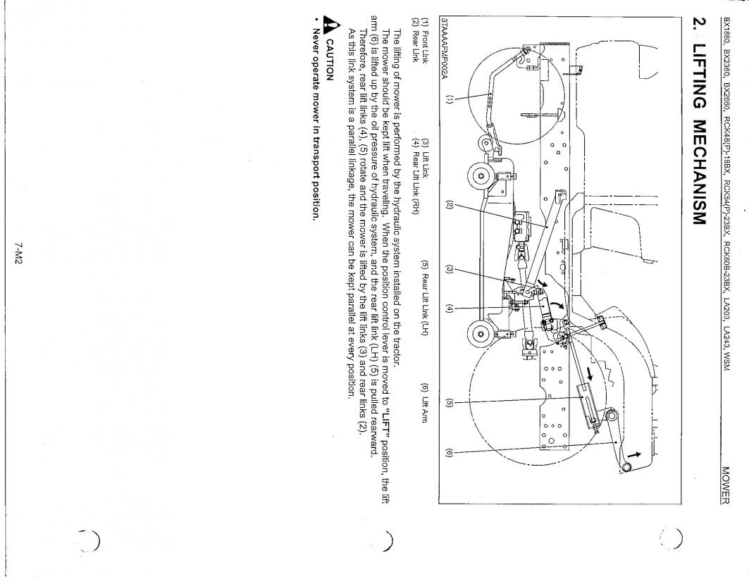

Assuming you may have trouble with things, I am attaching three jpeg files from my copy of the factory workshop manual showing linkages on the tractor, sort of. These from the BX manual and may be somewhat different. Be sure youalready have the mower height knob, setting just under your seat front.

thanks for the pics, and I'm glad you said something about the knob Ill look when I get home but I bet I don't have it.
