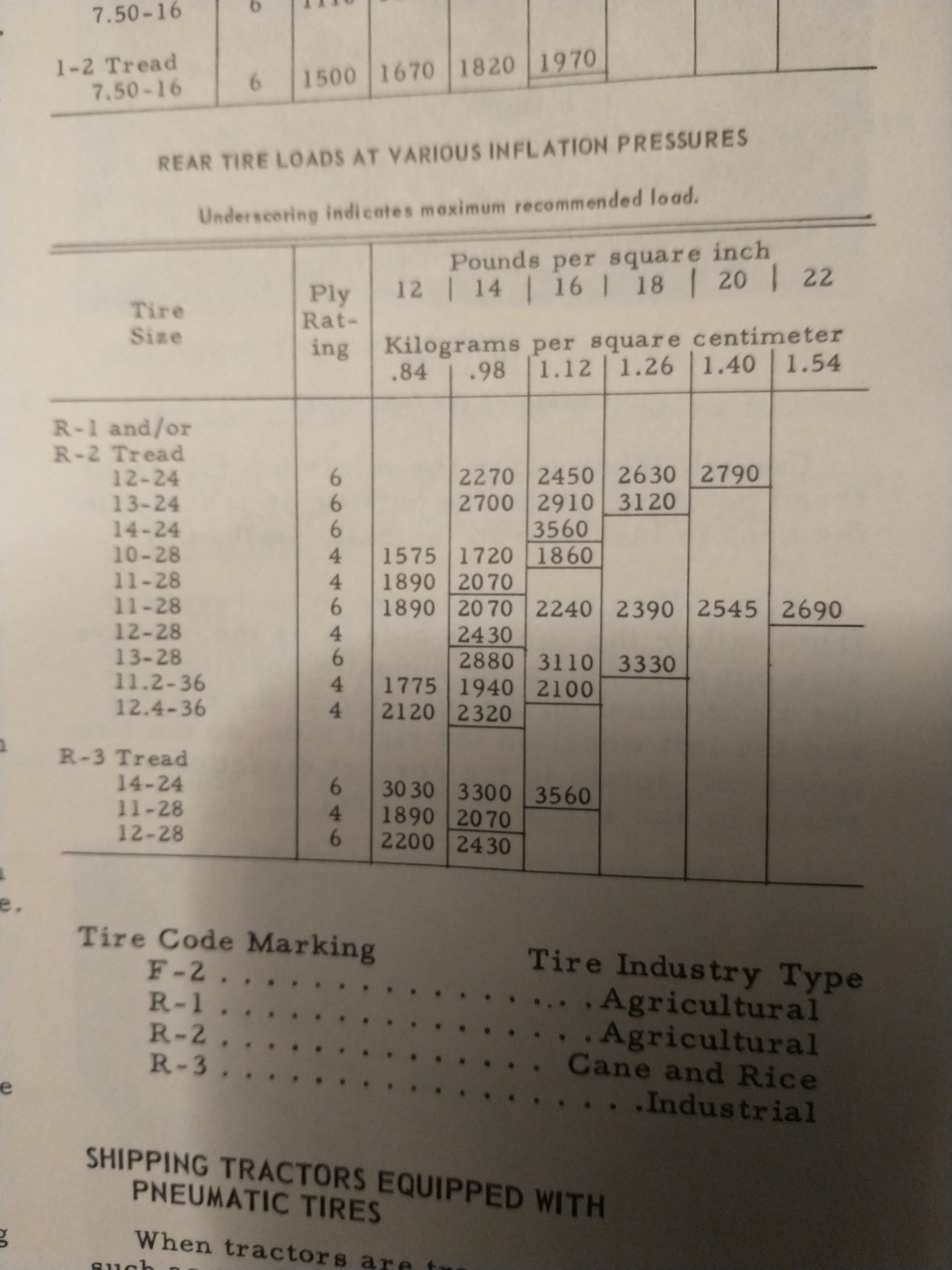

As for pressure. Liability says stick with the tractor manufacturers recommend pressure. The pressure on the tire is the MAXIMUM inflation pressure not necessarily the operating pressure. It doesn't take a whole lot of pressure to keep a tractor tire on the rim. When we pulled the little tractors we were commonly in the single digits. Never spun a tire on a rim. Would I want to mow hillside areas like that? No. But I'm betting my M4500 doesn't have any more than 12-15 psi in it with 450 pounds of iron wheel weights on each side and it's plenty.

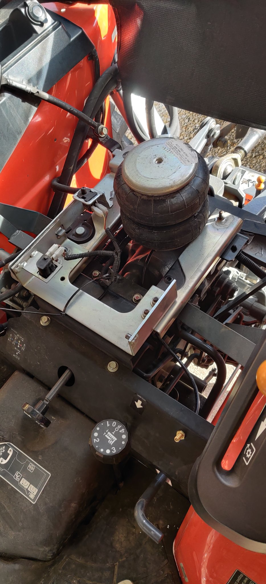

OK when you fill tractor tires keep the valve stem at 1200 and if you can jack that side up,, makes life a lot easyer on you,, as for the seat, I used some old valve springs out of an old pan head Harley I found at a buds shop, I guess you could use any valve spring and really no a brush hog wont smooth out the ride, my advice would be to slow down, and dropping TP odds of slipping the rim in the tire are pretty good.

If you have access to, or can rent/borrow one, a lawn roller sure helps to flatten out some of the bumps. Or maybe a grader scraper, grade it all down and start over.
tractors don't have suspension. Nowadays the seats can be had with some kind of suspension whether they be air or sprung. Wasn't long ago that those weren't an option either, and farmers were in/on the tractors for hours and hours on end doing, crop work. Those are bigger tractors and that certainly helps, but it still wears you out. I spend a little time on a 4640 Deere plowing when I lived in the corn belt. Yes it wears you out, even as young as I was at the time I hated doing it.

Back in the day, when manufacturers published serious operator manuals!
GrizBota
Apr 26, 2023
1,147
732
Oregon
Nice! Just think of the skill that table took to make with a type writer. Although maybe it was on the bleeding edge of word processors, either way, that was not easy. And now a fifth grader can do it in Word in a half hour.
