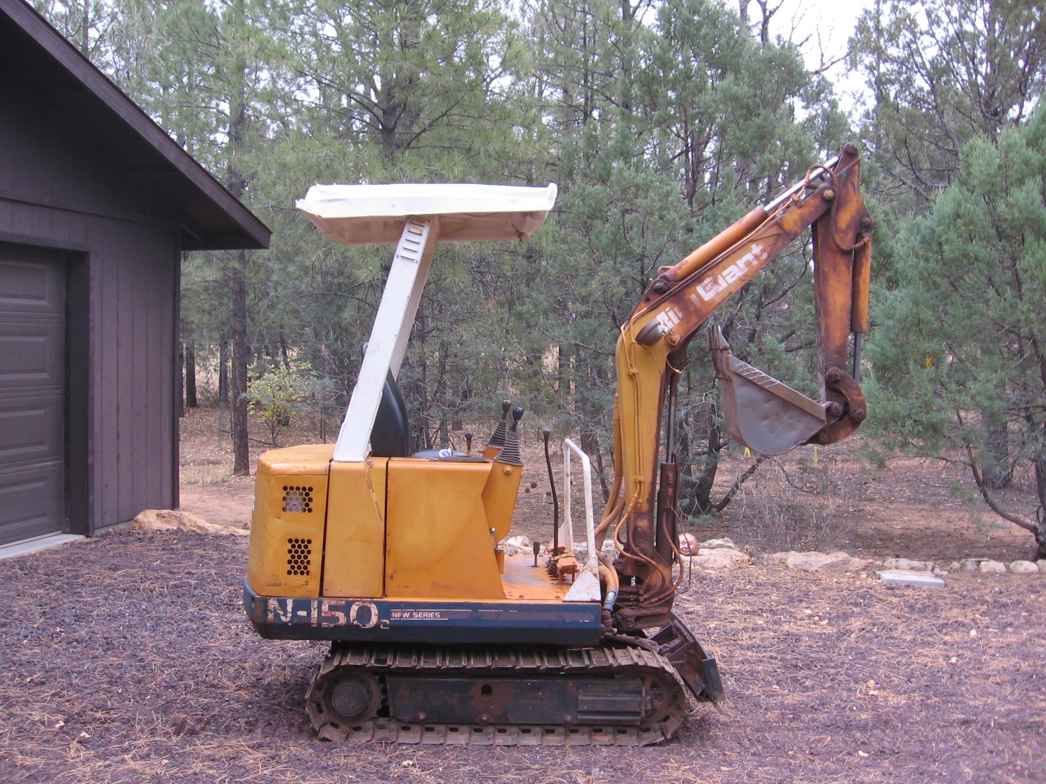

In the near future, I will be re-machining the bucket pins & holes on my Hanix N150-2 mini ex.
I think the bucket on mine swings side-to-side about 4 inches, pretty loose.
That is such a sweet looking little machine!
Ever since your first photos......
I want it !!

As soon as I first saw it, it stuck me as unusual, and I knew I wanted it. There is something kinda old school about the design that makes it attractive to me, despite all the grease, dirt & maintenance issues.
Not sure if it is the long but low body, the saucy forward lean ROPs/top, or something else, but it has personality.

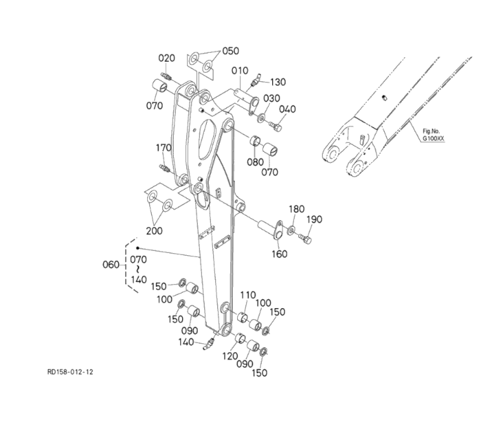

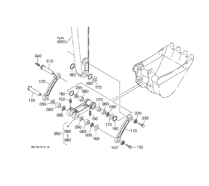

Not sure what Lilfoot is talking about but my Kubota KX71-3 Super (much like your 40) has bucket shims and theyre available in the Kubota parts catalog.
The Bushings are also available.
8,094
3,433

More to the point, define "old" and "most".
Keep in mind, Zepplins first album is now 56 yrs old......😲😄
That said, with minimal research, all post 2000 (25 yr old) Kubotas have bushings, not "steel on steel" that require machining to service.
Lilscoop's KX040 made its debut in 2019.....
Lets all try to give advice pertinent to the question rather than steer someone completely off course.

Thanks Doc, but we've established this already. Always good to see schematics and part numbers.

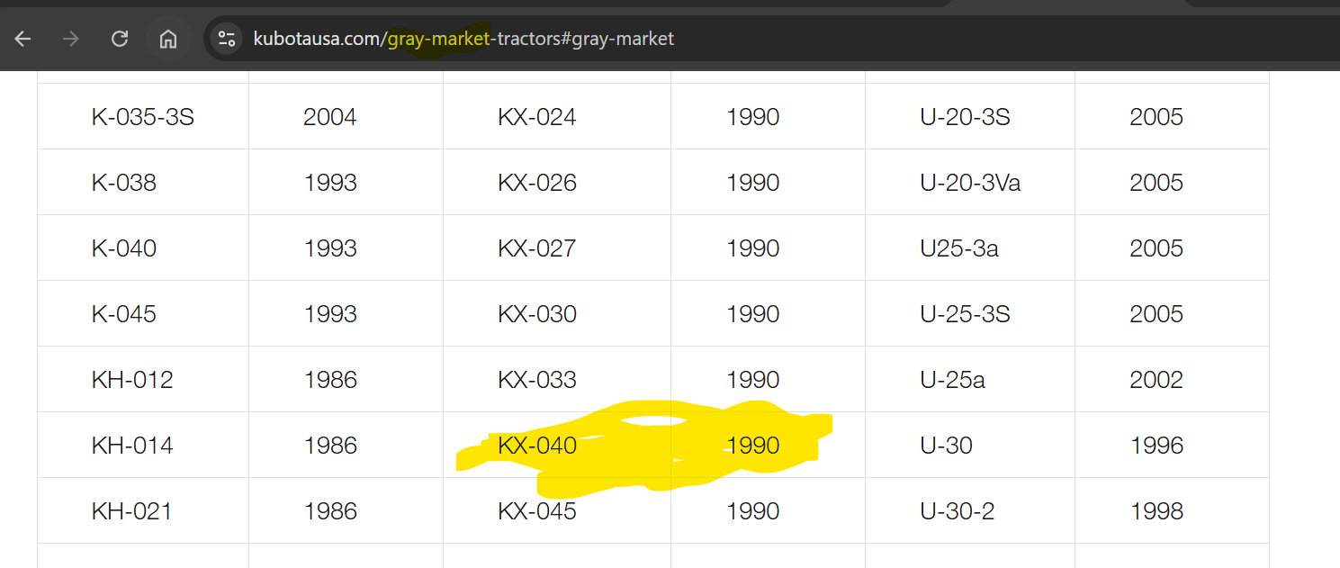

First the OP stated he had a KX040 which was made in 1990 not 2019 like you so boldly stated.
This is straight from KUBOTA
It was a grey market excavator, It is not anywhere close to a KX040-4 or -5
The OP never came back on to clarify if it was a KX040, KX040-2, KX040-3 or any other variant.
So that is a grey area also, But I'm going to assume that what he stated he had, is what he had.
Whether it has bushings or not is also a grey area because I don't have a parts breakdown of that specific model to state one way or another.
