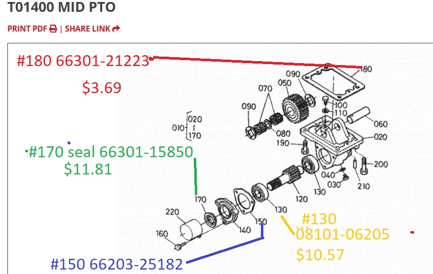

The complete mid pto unit can easily be removed from the bottom of the transmission after draining the oil. Sometime this can make seal changing easier depending upon your flexibility to get under.
However, before doing anything, a thorough cleaning with brake clean so you can see exactly where the leak is from would be wise. You don't want to change the seal and then find the mid pto housing is cracked.
Parts are available. In the following parts illustration I have provided the revised part numbers and prices.
It is not a complicated job requiring special tools.
Once you remove the complete mid pto unit you could just take it to the dealer for a new seal so you are not having to move your tractor.
The bearing behind the seal, which is only $10.57, should be checked to make certain there is not excessive sideways shaft movement., At Kubota's price of $10.57 going elsewhere to find a cheaper 6205 bearing does not make sense.

Dave:
Cleaned the pto and nearby surroundings. Oil dribble is not coming from the pto output shaft, but from somewhere above the pto assembly. What do you recommend? I'm wondering about ordering the top gasket and seeing if replacing it is a cure... I dunno--may be just magical thinking? I tend to be suspicious of appearance of coincidence even when no causal connection is visible, so I'm still proceeding on the premise that the flailing universal caused the leak.

Everything above the Mid PTO assembly gets much more complicated to work on.
Nothing easy.
And no a tight mower belt wouldn't cause a hydraulic leak.
