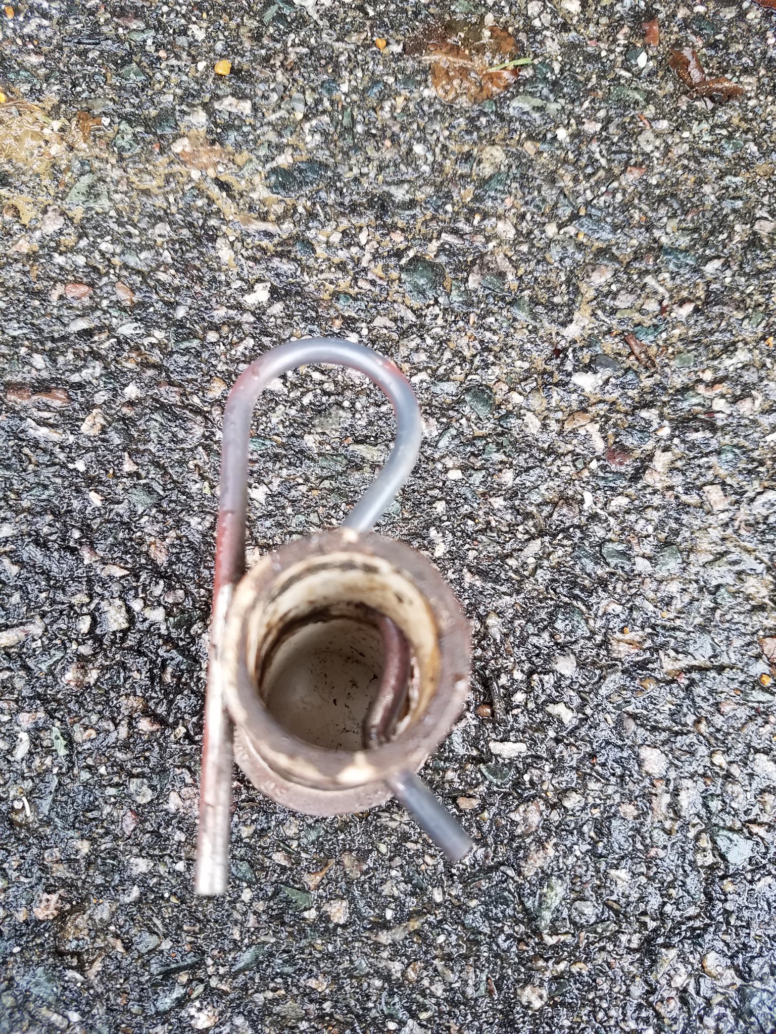

I have a piece of pvc pipe with a cap on it. I cut a notch on one side that lines up with the indent on the PTO shaft (the external PTO connector pin locks over the detent). The notch is deep enough to line up with the bottom of the shaft detent and wide enough for a spring clip. Slide the spring clip, with the flat side in the slot and the round side around the pipe, over the pvc pipe so it locks the pipe over the shaft. Quick and easy on/off. I'll try to take a picture of it later, if I remember!

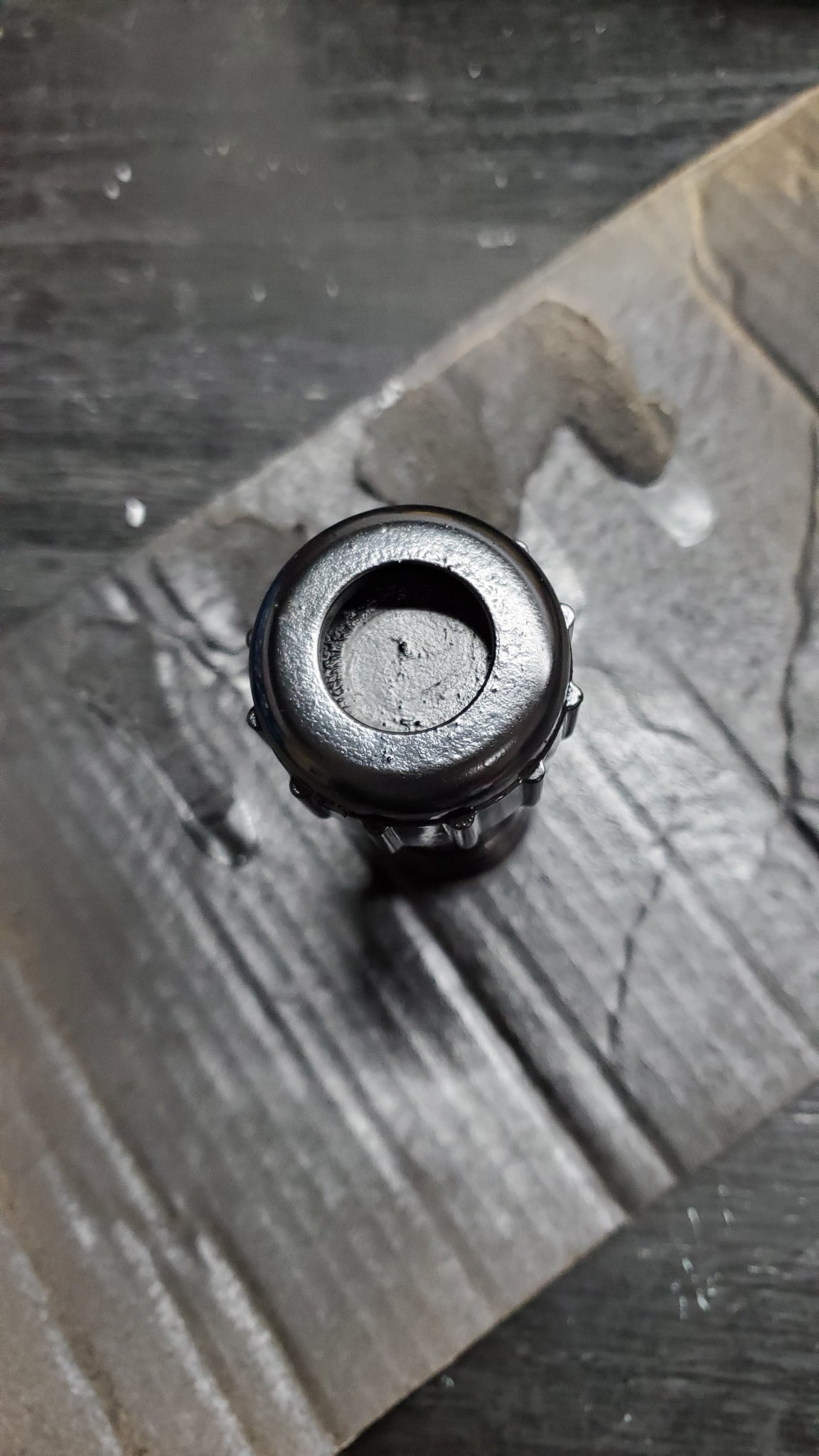

Hose is cheap and easy. What I do with my rear pto on one of my M9's. The other has the Kubota hard rubber cap. I see lots of rusty pto shafts on tractors. The surface rust makes hooking up stuff much harder. I keep my hose and cap with grease inside to grease the splines when it's on. A greasy shaft is a happy shaft... 😀

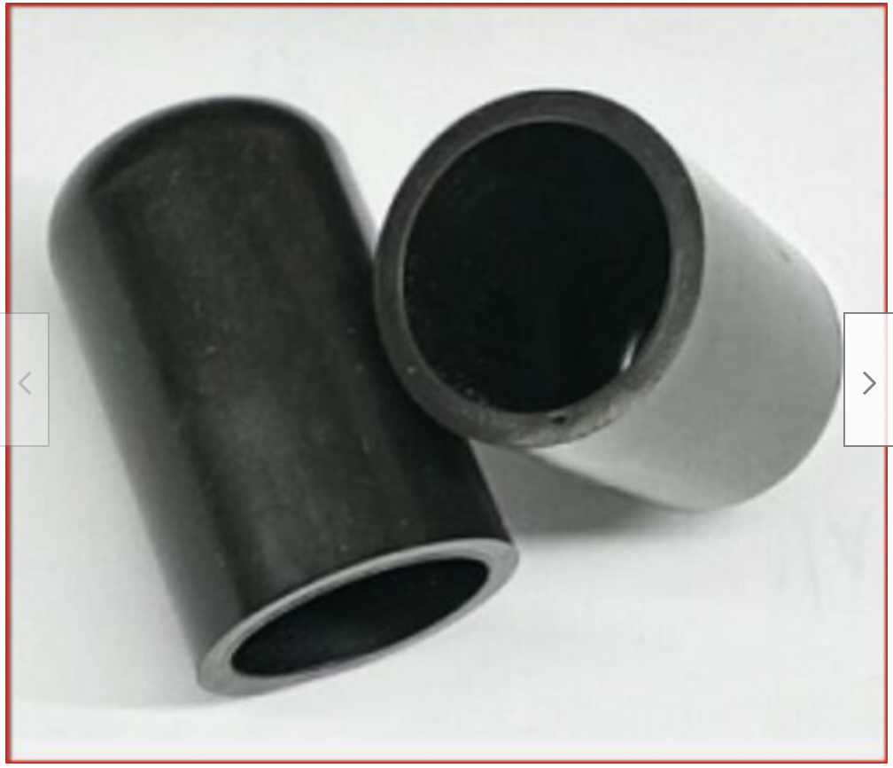

There was someone on the forum that got something just the right size and shape for a B2650, for free from his dealer, that came as packing for some other piece of equipment. Sorry I can't find that old post to be more specific.

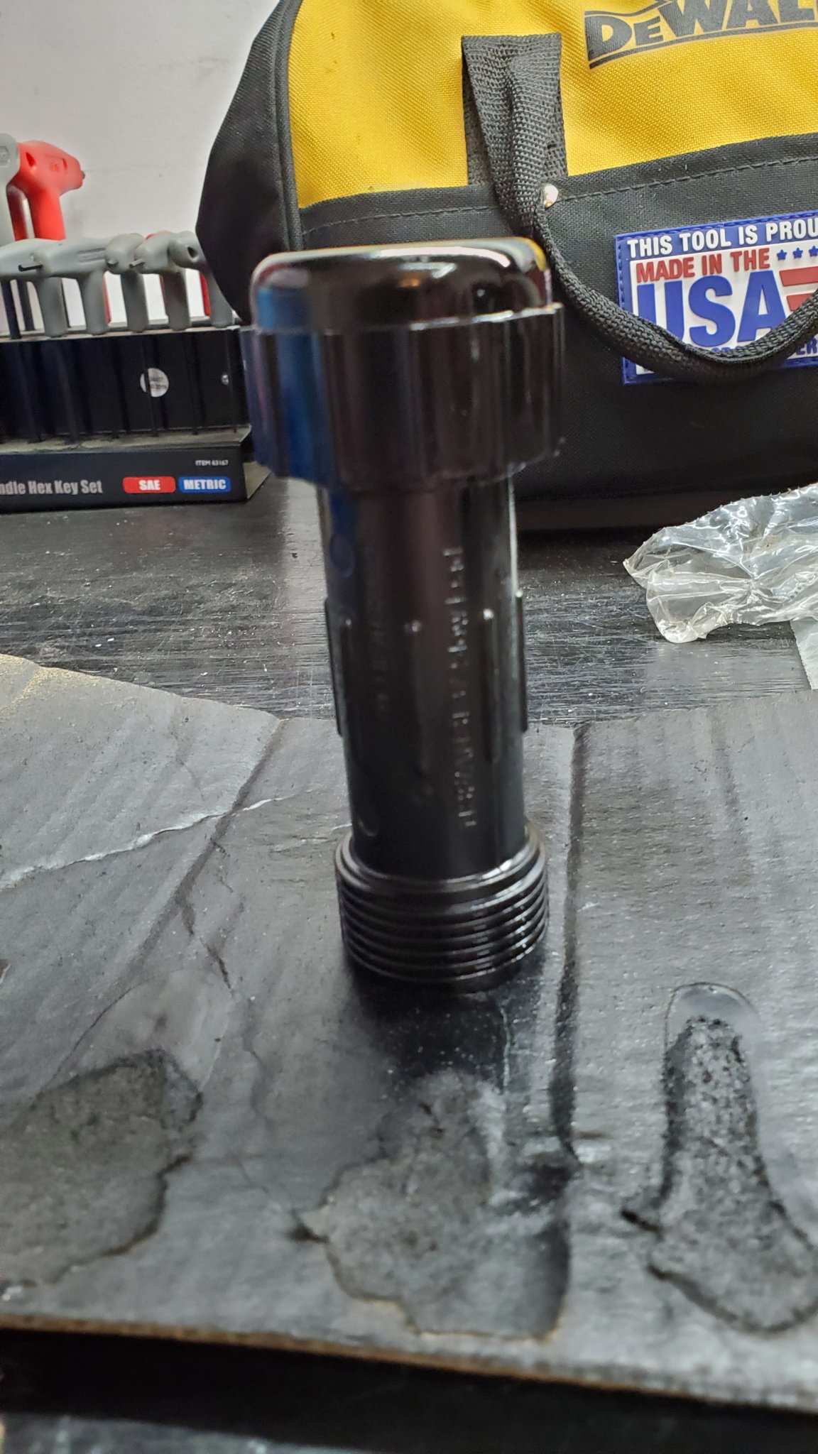

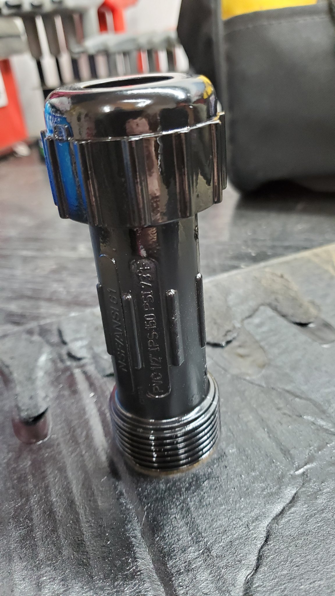

Chad Payne
M6060 and LX3310
Nov 30, 2020

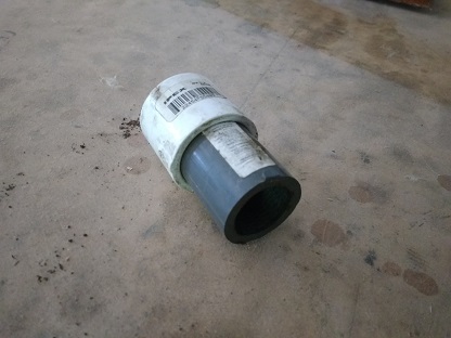

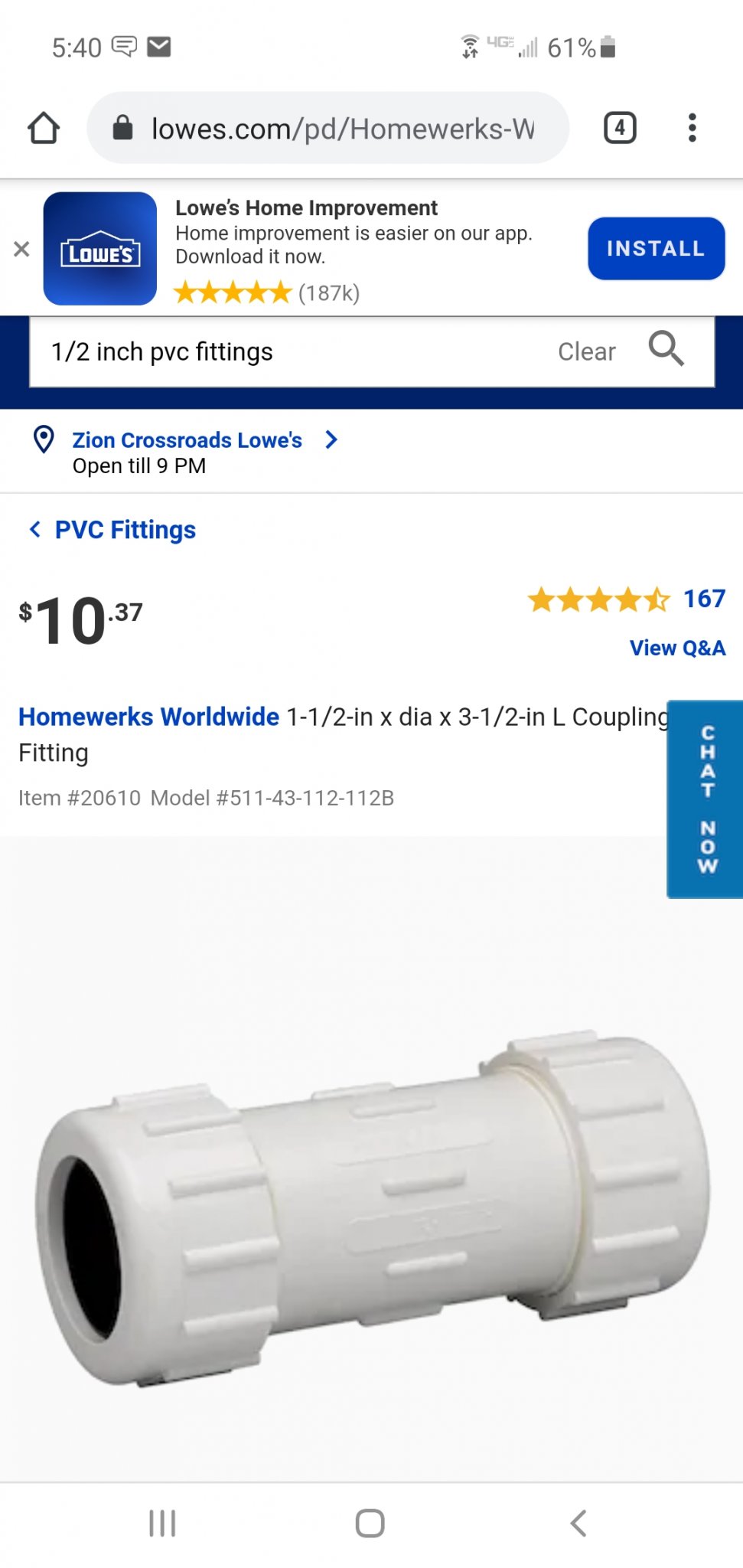

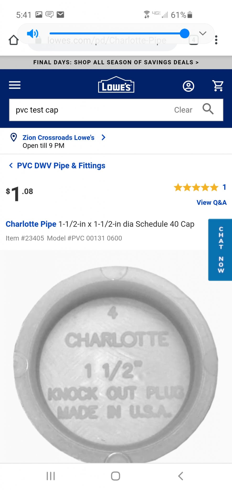

I was able to fabricate something today out of PVC fittings with some modifications. The coupling came with a rubber type bushing that fit over the pto nice and snug once I hollowed out the inside of the coupling a bit.
Since we don't have any implements for the mid mount (using a rear finish mower) I wanted something that would protect the mid pto from dirt, dust and debris. I think this will be perfect!
