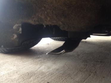

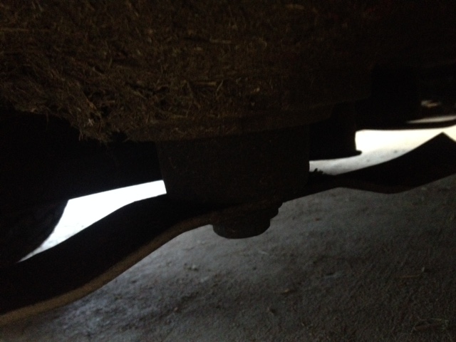

these are blade positions and results of mowing.... any thoughts ?
Tires all have the right psi ?
Looks as if the deck is leaning to one side - somewhere the system is outta wack!
Get on a nice smooth floor - get a couple of scrap pieces of wood to build a "thickness" sandwich - place the deck in the position that you cut, get down to the floor level and place these "shims" under the blades until they barely touch, move to the other side.......see what you come up with.
Doing this with a tape measure is a PITA - the height of cut is not as important here as the same cut on both sides!
report back whatcha find out!

Yep, what 85Hokie said. It doesn't look like the blades are misaligned, it looks like the deck isn't level -- looks just like the striping I got when my tires were low.
