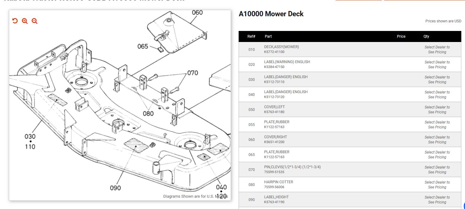

Is there a way to Pin the mid mount mower up on the lx2610 so I can use the 3 point without dropping the mower? I know there is a bracket for the mid mount arms so they don't hang once the mower is off the tractor but I don't think they work while the mower is on.
What is everyone doing for this?
60" midmount mower
You should be able to "pin" the deck up using part #70
