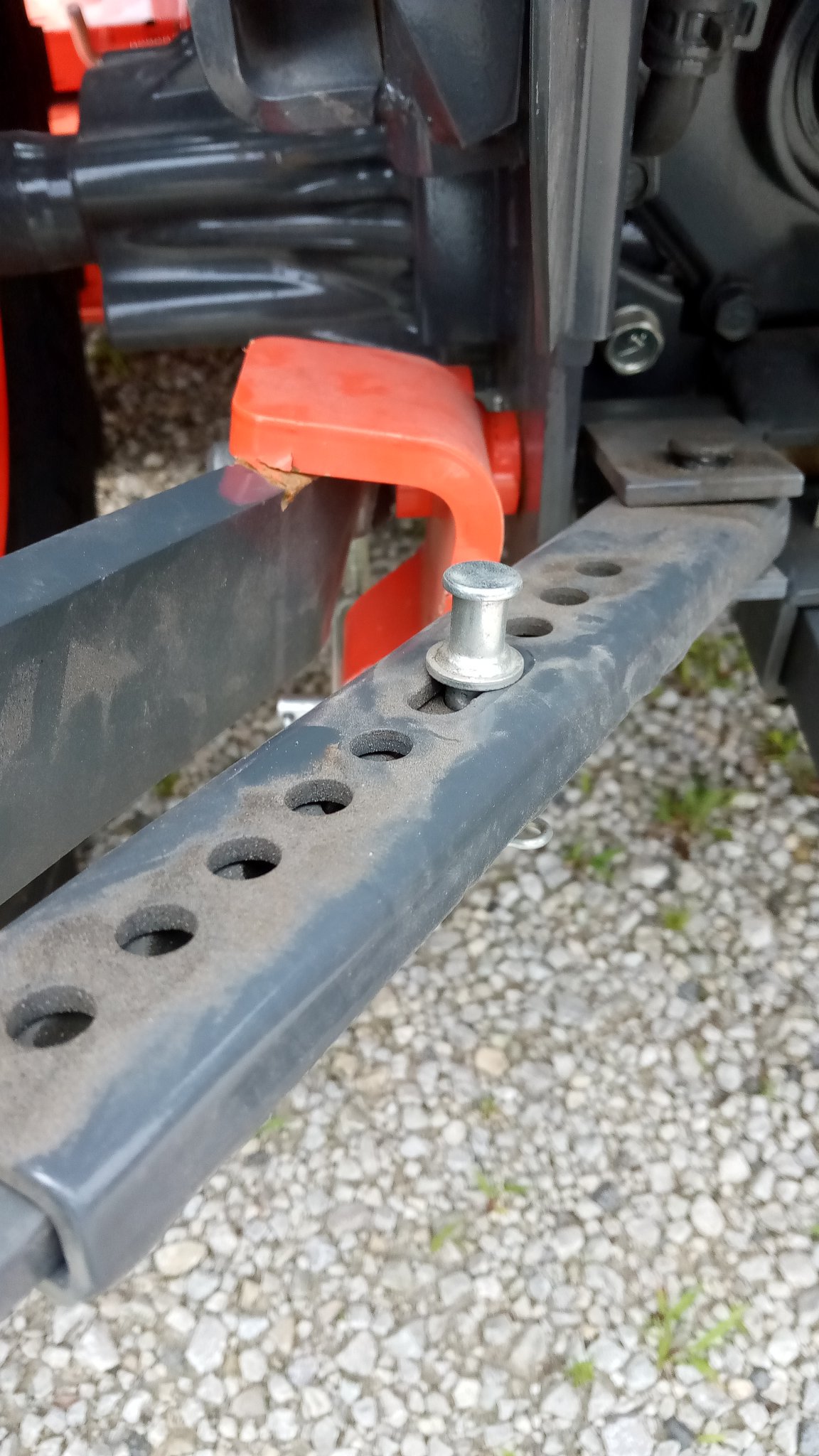

Has anybody else had issues with the orange bracket on the left side of the 3 point bending?
Ours has bent 2 or 3 times.
They replaced it the first time.
We just got it back and the first thing I noticed was the piece was bent again or still bent, depending on if they changed it again.
Does anyone know why that piece would be bending?
We have not used the machine yet. I didn't want them saying we bent the piece.
Somebody said the part was problematic but didn't elaborate.
