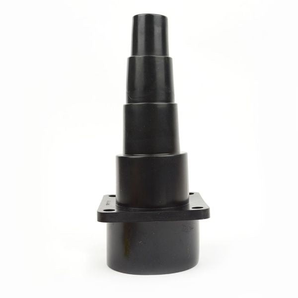

Neat idea. Good for the kid. They'll probably sell a bunch. To reduce inventory, I wonder why he couldn't do something like the adapter below. I'll probably stick with a rag stuffed around the hose because there's always a rag handy when doing fluid and filter work.

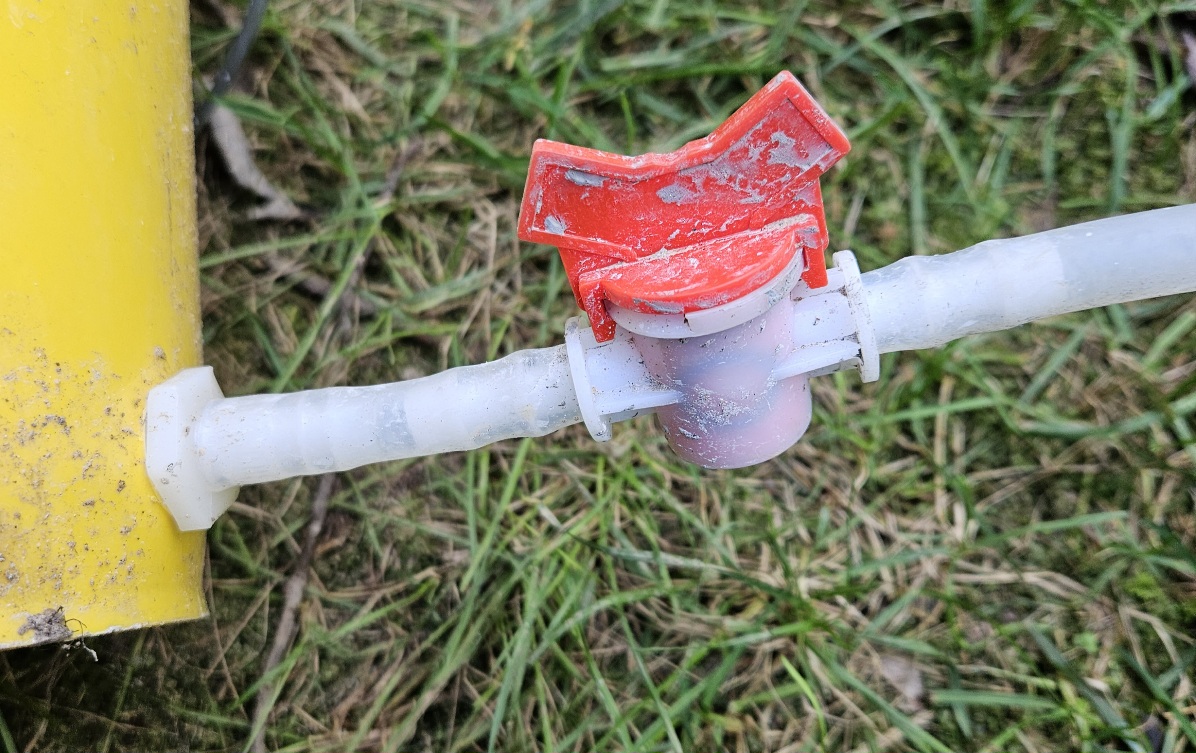

I agree but there is no way to throttle the suction, I don't want maximum vacuum, just enough to hold the fluid.
Drill a hole in whatever plastic tube or adapter you're using and put in a valve. If drilled low enough in the connector end of a vacuum hose the hole will be covered when connecting to another attachment, and/or the hole can be covered with electrical tape.
You could also drill successfully larger holes until getting the amount of suction wanted.
(example of the type of small valve)
