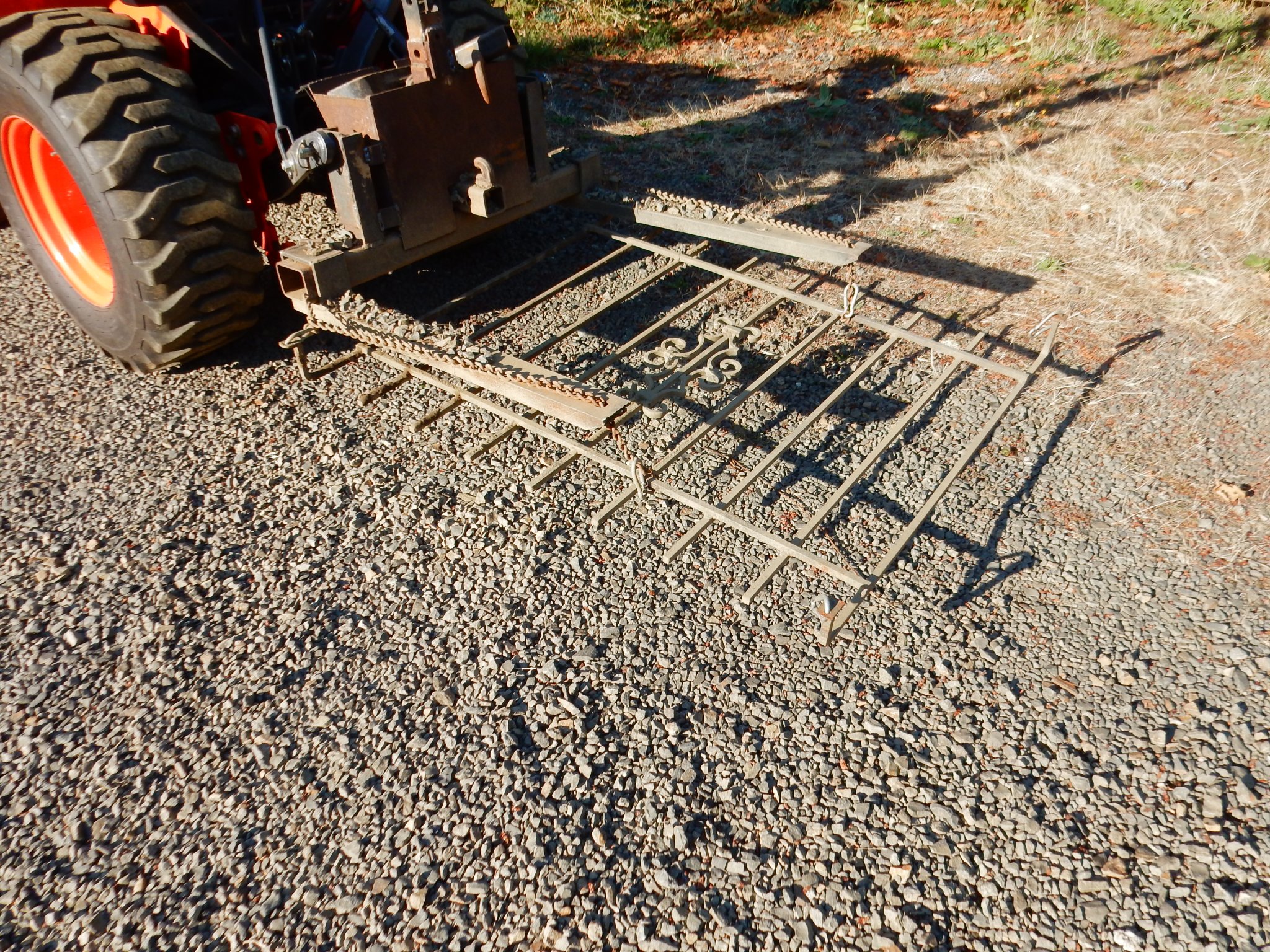

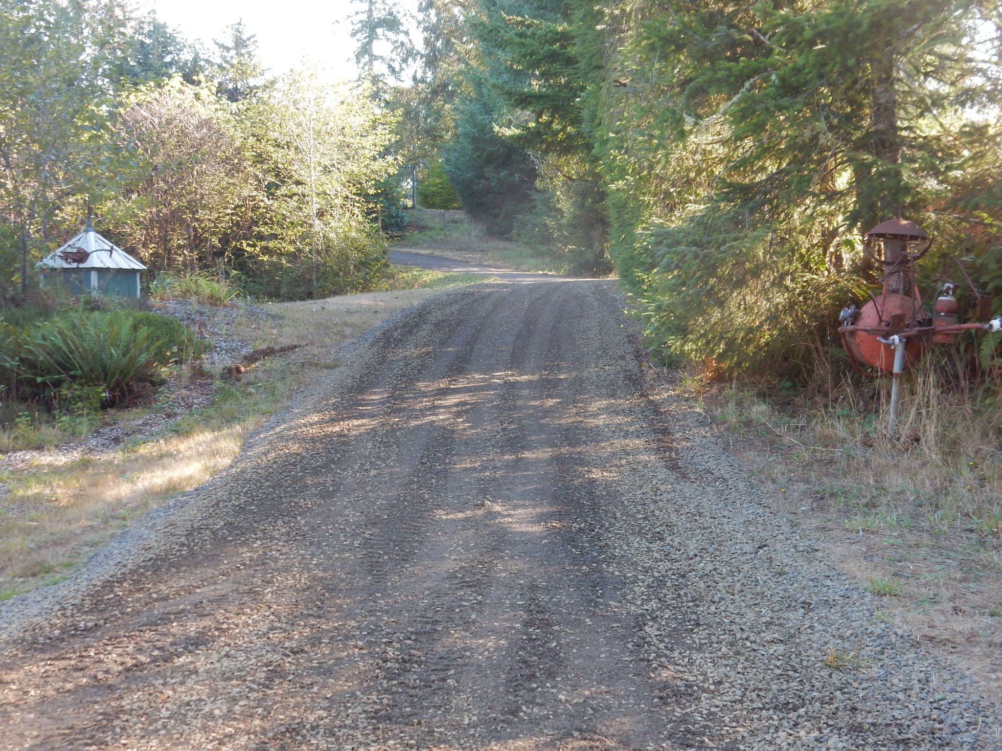

I had 12 yards of gravel delivered for my road. I asked the driver to lay it down at a 2 inch depth. I guess he decided that an 8 plus inch depth would be better. After using my box blade to cut it down and spread it out I ended up with a lot of woopedos.

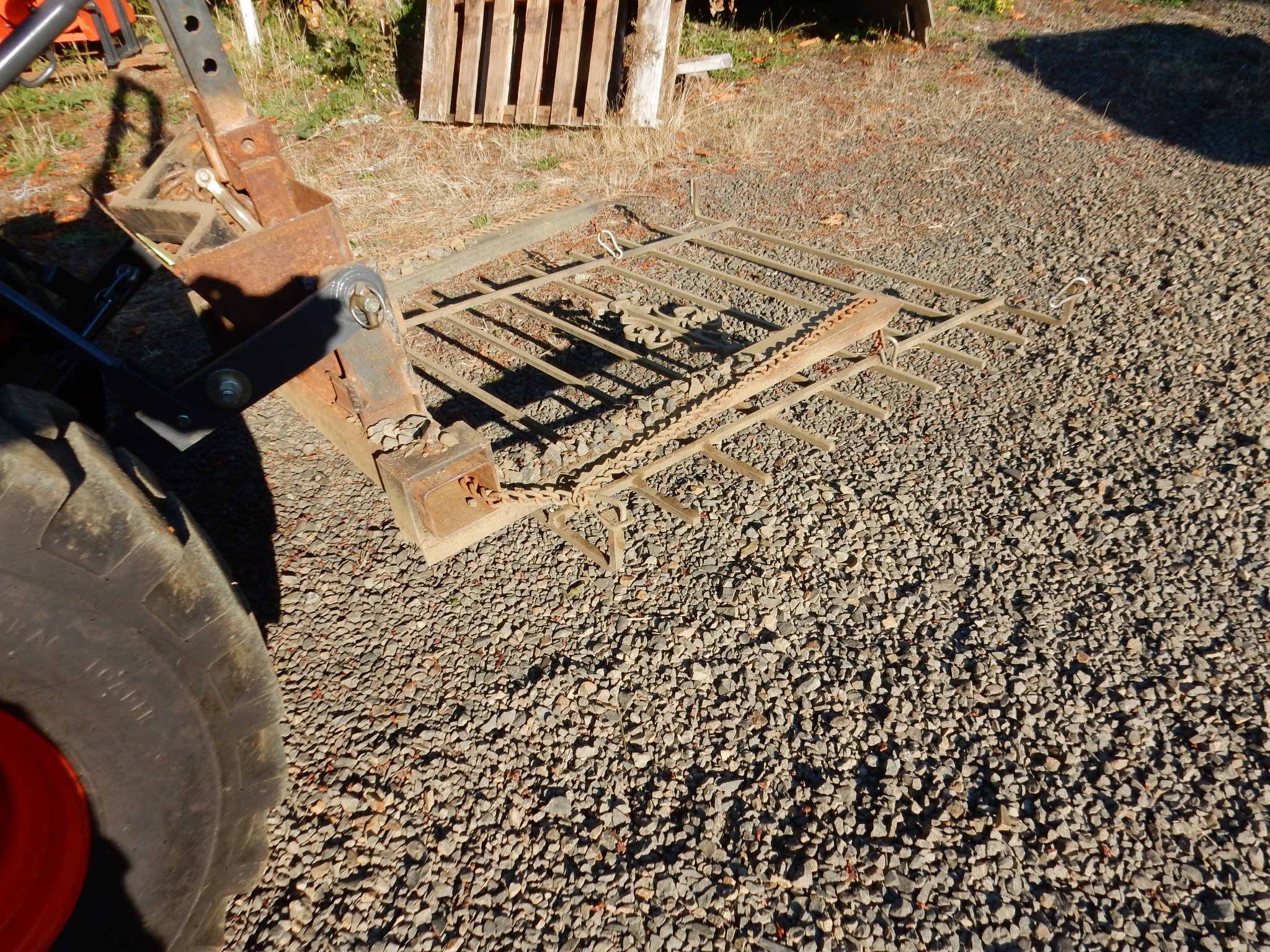

Not having a land plane I came up with this from my scrap pile. It actually worked much better than I had anticipated, with the only draw back being that its only 4 foot wide so it took several passes.

Looks like it did a fine job! Congrats!

Depending on the starting conditions, a "real" land plane takes several passes too.
10,193
7,089
Looks like it worked out great! (y)
Making top link longer might have avoided the bumps. Rocks box blade onto the rear blade to give it more of a smoothing aspect.
