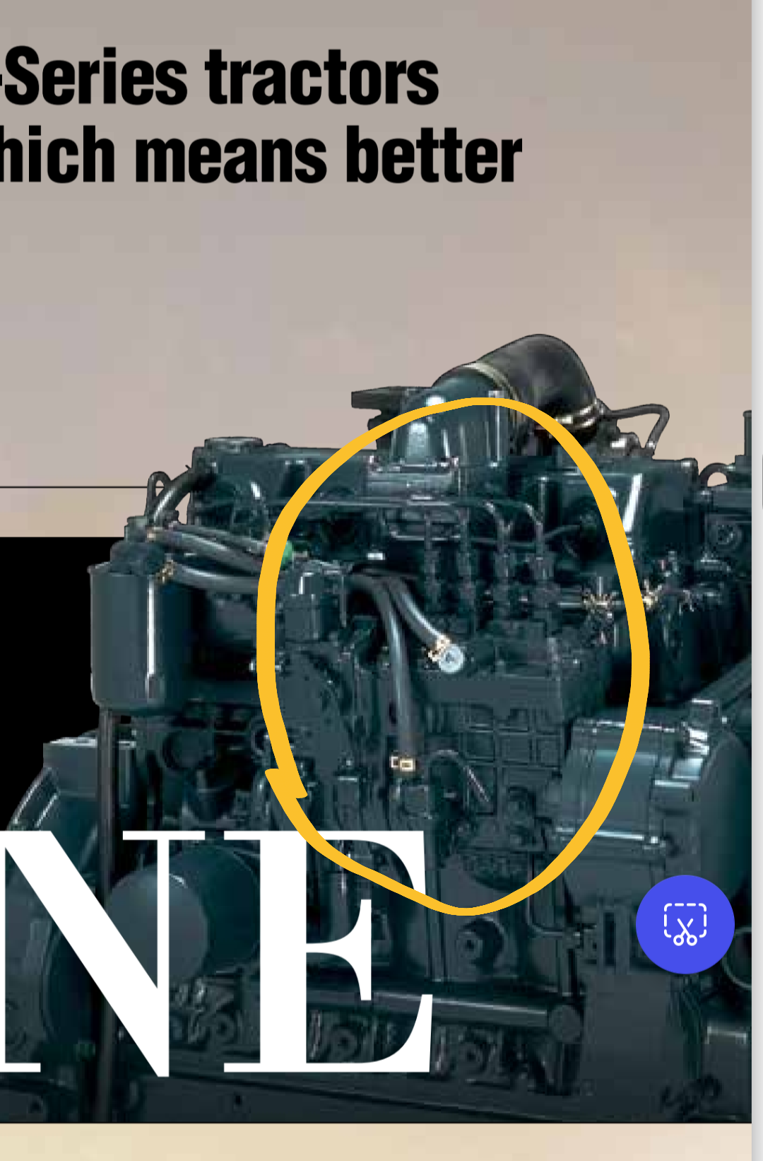

I think you'll discover the M9540 is a common rail not direct injection engine. The xx40 series tractors were the last models before the EPA went to tier 4, which added more "stuff" to meet smog requirements which makes that series of tractors actually increase in value over time.

Oh yeah, I mean the m9540 is common rail, and in a perfect world I would find a low hour 6 cylinder direct injection tractor!

The M9540 still has a mechanical fuel injection pump and was the last model before common rail.
