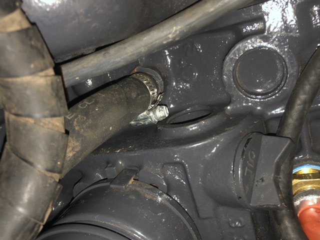

Ok my mistake, it’s the passenger side. Lol. Think outside the box. As your sitting in the tractor like a car, left side is driver and right side passenger. But I should have said pump side. Sorry The hose comes right out of the block left of the oil filter and runs to the bottom of radiator. If you look at Messicks under the A42000 WATER PIPE I’m referring to #080(joint,drain). In the picture it looks like it’s straight through but I assure you it’s a plug in the tractor. I’m thinking it’s a drain.
Interesting. I don't have that hose on either of my M's, open station or cab.

Didn't reply after reading your question because I have a question about your question and that is.. What is the drivers side? You sit in the middle of the tractor so what side are you referring to? If you meant the pump side right side, that hose is for the oil cooler base which on your engine sits proud of the block and the spin on oil filter mounts to it. I presume that is what you meant?

Got looking closely at my open station M9 the other day. There is a hose that runs from the lower side of the water pump around and behind the injection pump . Where it goes, I'm not sure but I'll take a closer look tomorrow as I have to put the hay rake on. I'm betting it feeds the oil cooler which is a plate that fits to the block and the oil filter fits on it.
