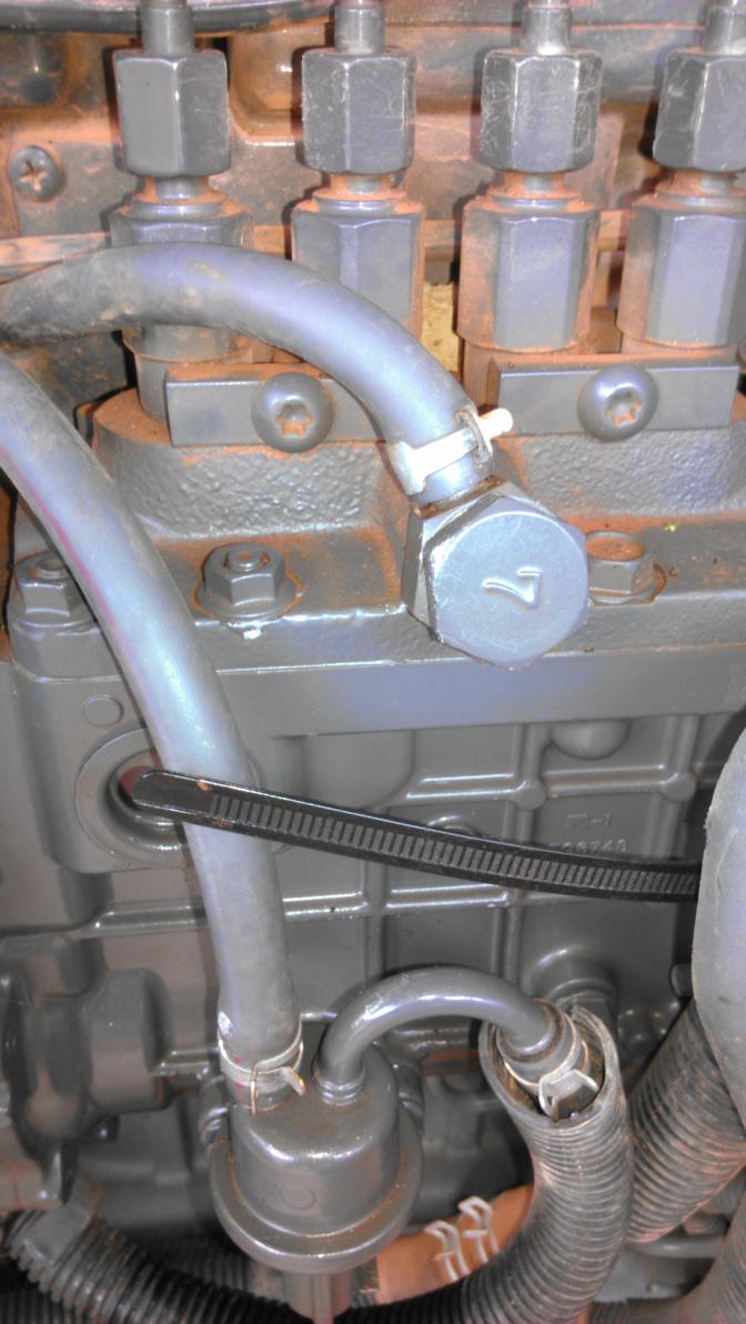

Well I crawled around and found what I believe is the return vent, traced it back to a port on the side of the air filter housing. There are little inline 1/4" filters with check valves, one at the filter, and one tees off to the right side of the injector pump. If this is in fact the return, then its a closed system and mud dobbers are out.
I've been getting filters and stuff from James Short Equipment, they're now a Kubota Dealer. They don't have a service truck and would have to have the dractor delivered to their shop about 10 miles from here. They seemed to think its an injector pump and that it would cost around $4,200 bucks to fix it, plus the hauling. Did I mention this tractor has only 200 hours on it...
There might be just one other thing that's a possibility. The fuel level in the water separator is chaotic, either full or half full and sometimes bubbly when running. Is that normal? I was thinking of bypassing the separator and see if that works.

Thanks Tx for thinking about this. My cap looks like its vented from the hole molded into the cap. Here are some photos.
Do you think the water separator should be at one level all the time or is it supposed to fluctuate?
thanks..

I think water seperater should stay full of fuel. Several yrs back I owned a M4900 I bought used and it would act as if it was running out of fuel. Fuel level in bowl fluctuated. Local Kubota service manager told me to check for a plugged tiny screen in fuel cut off valve. Sure enough it was plugged. I cleaned screen then engine ran fine until I traded it for my M7040
