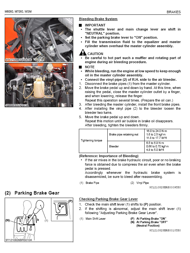

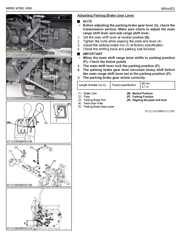

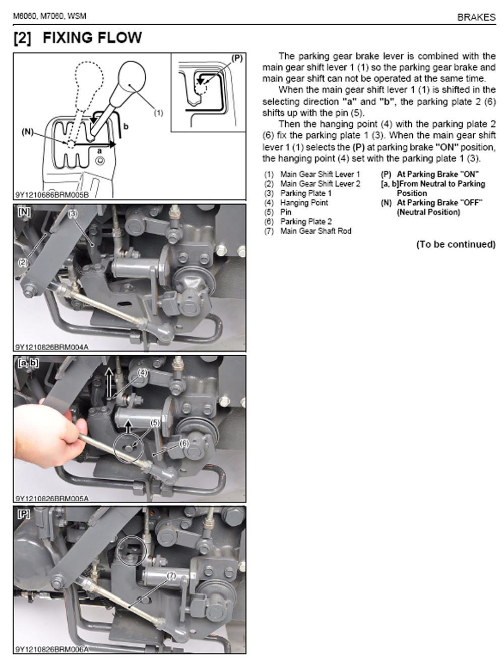

Reading the WSM for the 7060/6060, the 7060 has the parking brake integral with the transmission and gear shift and it's a gear lock type. Interesting ... and hope you get it figured out. The 6060 is a simple foot brake lock like the MX.
8,359
11,753
In case the issue is related to the parking brake gear lever.

In the Oper Man, I see the 12F/12R shifter has a Park position that the 8F/8R doesn't. What does this do?

Ivr had my 7060 be stubborn to get in/out of park of the linkages become wore/bent/seized. When its cold its stiff to move around the pattern. Maybe have a helper move the shifter and watch to see if the linkages are moving correctly. The rubber boot on the shift shaft? will get stiff, its not made for the cold.... maybe its tore and some ice inside it not allowing that last bit of movement to unhook off the brake 'latch' linkage

I apologize to everyone in this, I'm on the little computer today and didn't have access to the WSM or the OPS manual.
I totally missed the mark, that model does have a Parking Paw Just like an automobile.
And yes if it's stuck then it won't move.
Thanks to mcmxi for pointing out my failings.
I checked that boot, no tears or holes, and I don’t see any bending. I’m thinking the linkage just needs some adjustment. The shifter has always been a pain in the butt.
