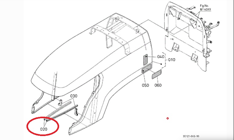

If you are looking for the rubber seal:
RUBBER,SEALING - RUBBER,SEALING 3C151-83330 $12.51
I found best to smear silicone grease on them to keep them from freezing and preventing hood from opening.

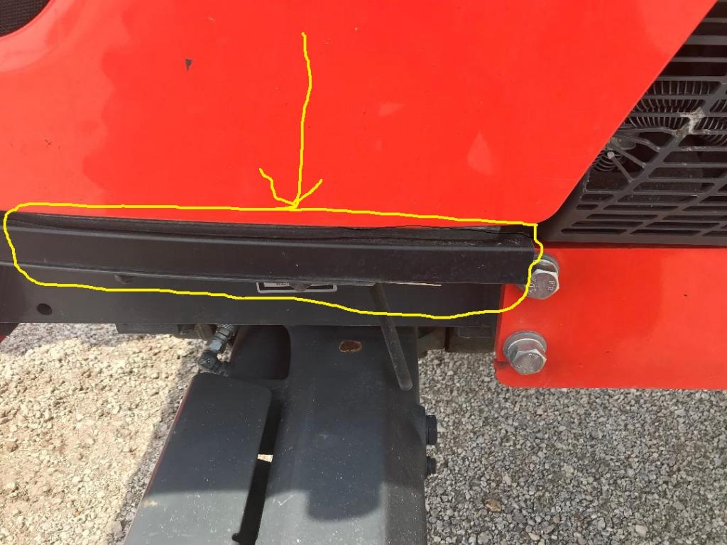

Are you looking for the black cover? Number 70 in the diagram? Verify with your model, I looked up using a M7060HD. Its in the air cleaner section
