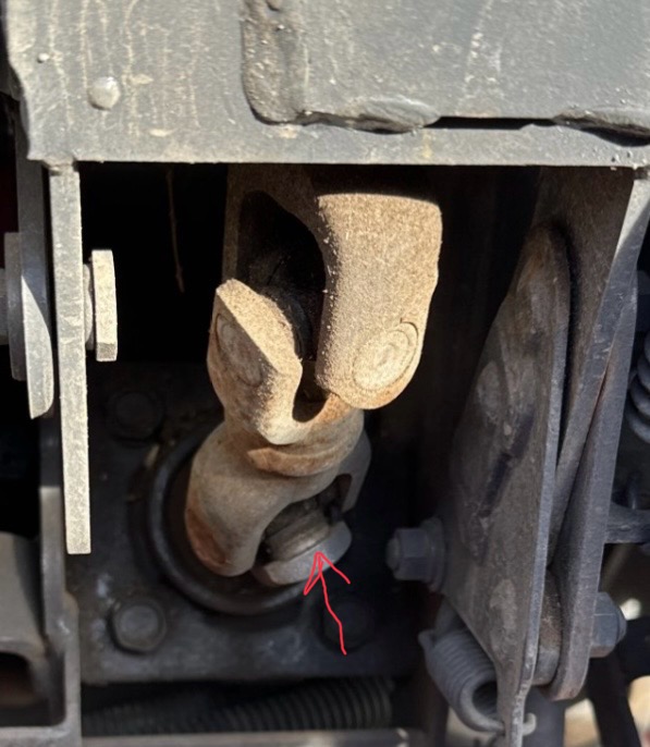

I don’t know exactly what you are showing in that picture but what is this thing that the red arrow is pointing to? It doesn’t look right for the pin to be falling out (as I see the picture).

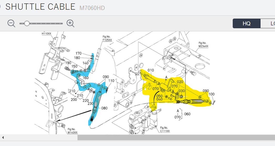

Have you looked at the bottom end (yellow) of the shuttle cable?

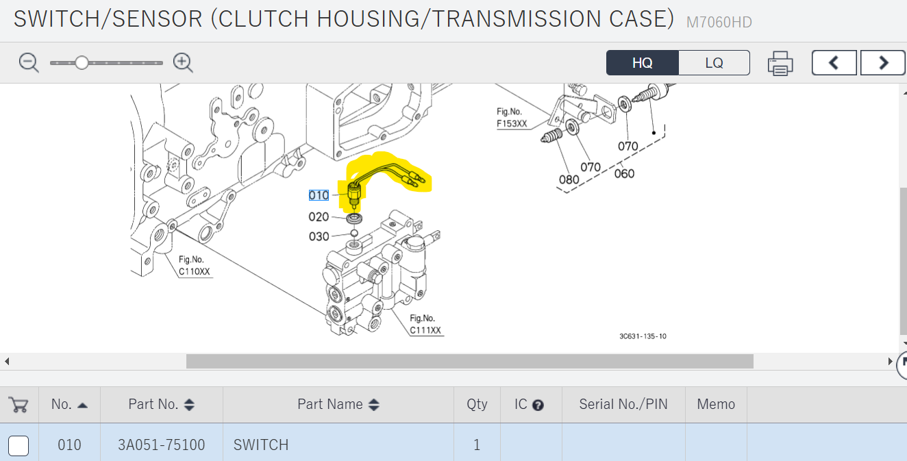

The switch is here, first thing to do is check wiring, hear a lot of times a stick or something just pulls the connectors apart.
Do you have the WSM (aka service manual) , it should tell you have to test the switch.

Just following up in case others have similar problem. Tractor was taken to dealer and diagnosed / fixed in about an hour. Somehow the shuttle cable running to the shuttle valve, the pin came out. Replace shuttle cable pin and back in service. $10 in parts and $180 in labor/transport.
Live and learn. Hope this may help others with similar problem. Thanks for all the suggestions.
