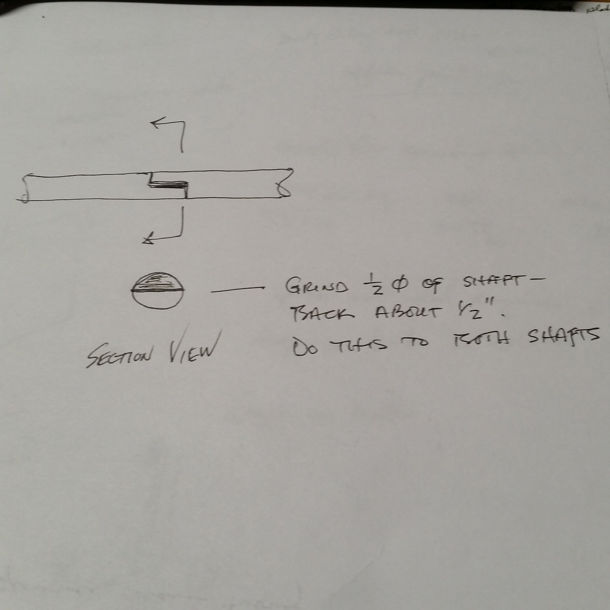

If you weld it yourself here's a method to get maximum strength when welding a round shaft.
