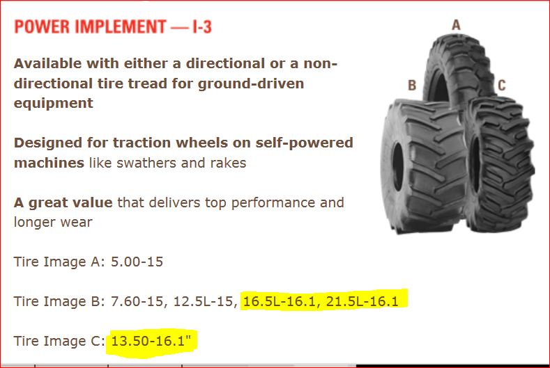

It looks like you can do it with a change in wheel size, you'll have to find out if you can fit a set of 16.5 rims on it.
I have the C tires on the back of my L3450 and they have excellent flotation and killer traction, I don't even need chains in the winter.
http://www.firestoneag.com/en/tire-finder/search-Ag-Flotation.aspx
