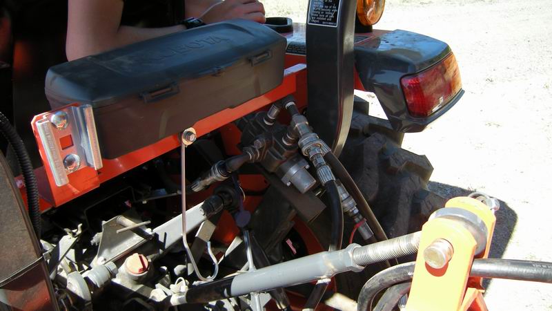

My dealer charged me a whopping $500 for giving me a rear hookup. Essentially it was a couple of long hoses in the FEL return line, with quick disconnects on them. I picked up the pictured valve at Big R for $99, a couple of quick disconnect sets at about $45 ea, and some hose. I could have gone to a dual valve, but I am worried about fitting my backhoe in there.
