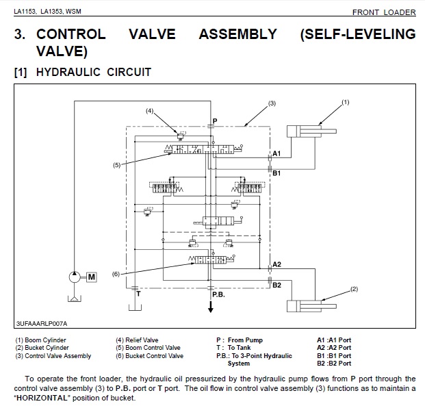

Filters and oil was changed at the same time I changed the loader valve. Not even an hour since. Only been running while trying to fix this thing. Hoses are not swapped to the best of my knowledge. 3 pnt was all in working condition. Is there a plumbing diagram available anywhere?
The following are from the FEL WSM

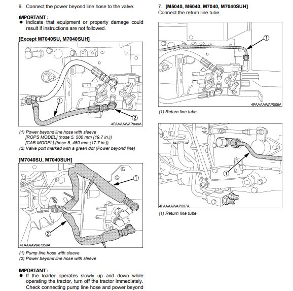

I'll almost bet that the hoses from the pump to the loader valve are installed wrong causing the pump to be deadheaded. This is what caused the hose to blow and likely has now damaged the pump. This is very easy to do unfortunately, and isn't readily apparent, I did it one myself on a new tractor. The tractor worked good for a few weeks until the owner actually stressed it by running it all the way to the top. see attached page from assembly manual

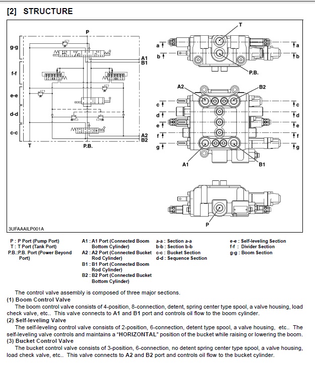

And this one
