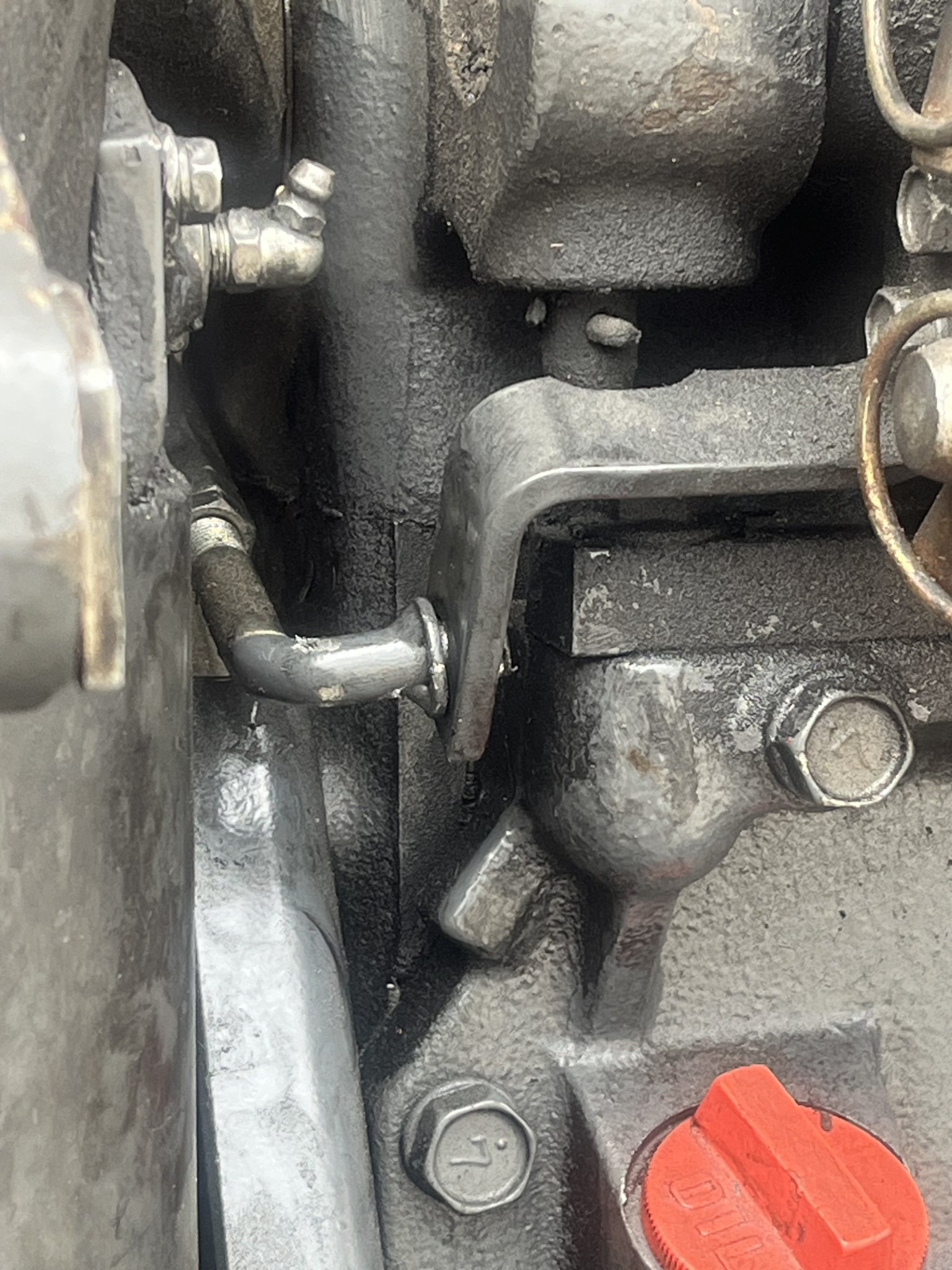

So I finally found the problem. The draft linkage was beginning to freeze up. I disconnected the linkage (shown in picture) and noticed it was a little hard to move back and forth. I exercised it and now it has 1500 psi at the remote at idle.

The WSM is calling the rod the draft feedback rod.
It’s #3 in the attached photo is the one I disconnected and exercised.
I can see how draft control might be causing your 3pt lift problem. I cannot see how it would affect pressure at the remote. Your pressure test indicates you are getting full system pressure delivered to the 3pt control valve.
Understood. So a couple factors, human (lol), secondly I went to Kubota and bought new fittings for the remote, lastly I took the relief valve out for another visual inspection and backed it off a turn, tightened it two turns. So unfortunately to many variables to nail it down to one, but the draft controls “probably” had nothing to do with remote pressure.
