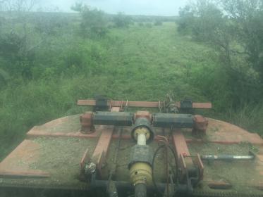

You will love the M6060..
I pulled a 7 footer pull style with no problems. (it’s for sale if your interested)
Now pulling a 10 footer bushhog. It did bog down in hood high grass going about 4.5 MPH, but normally i’m shredding weeds and brush. It handles my normal stuff very easily. Can’t go wrong with the 6060..
