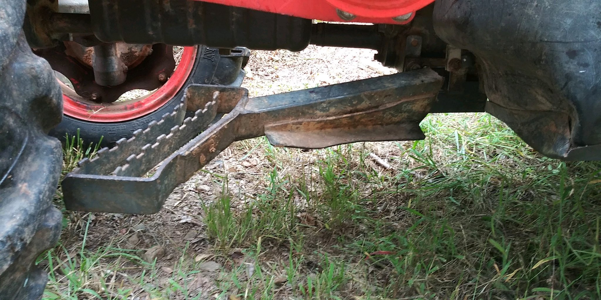

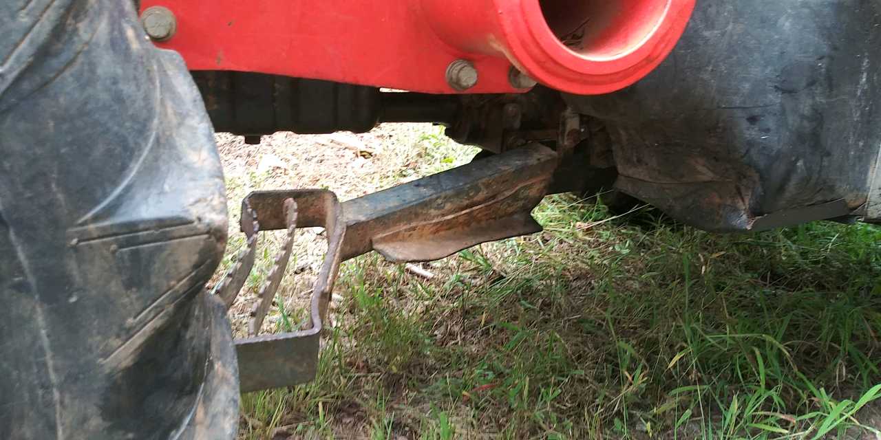

MD50404 tractor was recalled in 2010 for step breaking. The "fix" was a brace underneath the step. This brace does not prevent step from breaking sideways. See the attached files. I notified Kubota about this and they did nothing. Since my injuries from this are very serious, I have now notified government at SaferProducts.gov. I am issuing this warning to all my tractor loving friends to prevent this from happening to them.

Wow. That's quite a bend. Did it hit something after it broke, or broke after it hit something?

Looks like you tried pushing a stump out with that step and the stump won! This begs the question, "How strong should a step like this be?" Should it be designed to withstand the same amount of force as the FEL or drawbar? Should it be strong enough for a 250 lb human, a 350 lb human, a 550 lb human?

Sure does and Kubota does have a step reinforcement kit. I have one on my M9000 open station. Don't have the part number handy but it's a wholegoods part. It bolts to the step arm and to the tractor frame. For overweight farmers, like me.....lol
Sure looks to me like that step was used for something other than what it was designed for.

Why didn't you replace the bent/broken step when you ran into something, damaged your fuel tank cover, and dented the tank? The break looks to be rusty, so it didn't just happen.
Sorry, but this one is on you.

I appreciate the photos. I am curious about your injuries and how they occurred. How did the step get bent? Do you know the safety recall information?
I did some digging online and found this. "I bought a used 2008 Kubota M5040 and emailed Kubota to see about how to check to see if my tractor had the fix or not. They replied they knew of no recalls for a step problem on a M5040. Does anyone have the recall name or #? Thanks."

Still trying to figure out why this is Kubotas problem? A step is designed for down pressure and yours is bent from lateral. That is a step not a ram.

Sure looks like it was used for a bumper rather than a step
Ditto it appears step contacted a fixed object similar to a rock or tree stump.

Found a few references to this recall on the net. One mentioned a situation with two people involved. One driving and a passenger standing on the step while the tractor was moving. The passenger was injured when the step broke off.
Google Kubota M Series Recalls
Interesting. I have the same exact step and rectangular support on my open station M9000 and like I said Kubota makes a step reinforcement kit and I have that installed, not because I was worried about the step itself, but the length of the rectangular tube. Even with no reinforcement bracket, it's plenty stout and I'd never ride on the step with someone else driving the tractor, that is just plain dumb.
I'll get the Kubota kit number tomorrow, I have it in the shop (box and warning label I did not put on). I find warning labels to be an accessory I don't need.
PSB-2009-031-R1

WT, that doesn't look like it would apply to the OP's model of tractor by a long shot. I appreciate you posting that, but we probably won't be hearing back with much more information. Thanks. I appreciate what you contribute to this forum. Have a good Christmas!
