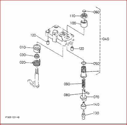

Is your model Serial# <51139 ?
If it is I've got some good news for you... I know exactly what's wrong!
There is a funny little and rarely used device called a compensator and it does exactly what you talking about, controls heated idle and acceleration.
Sounds like you have something wrong with yours!

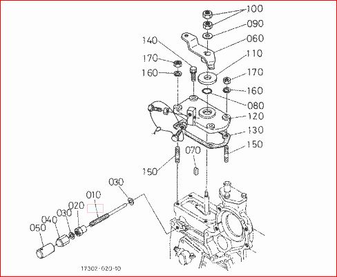

Here is what your dealing with it's inside the plate for the throttle and governor.

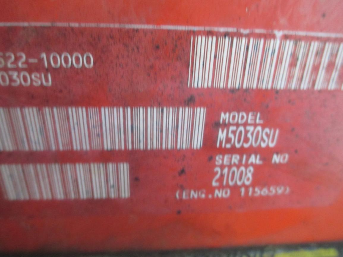

The serial number of the machine is 560801. Model number 195.
The engine model says S-2802-DI-A
If I am reading your response correctly, then my model number is not the one that you're talking about.... Right?

Well your serial # 560801 is Greater than serial#51139 so it should have it.
In the picture there is #130 that is a thermostat and I would suspect your problem revolves around this device being bad.
Real simple to tell if it has a compensator, just look at the top of the throttle plate, it will have two shafts if it has a compensator and only one if it does not.

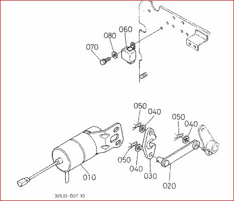

As far as the stop solenoid you have a passive type, it's an external magnetic pull type that is triggered by the key being turned off, the key switch triggers a control timer that turns off after approximately 5 seconds, So I don't think that has anything to do with your problem.

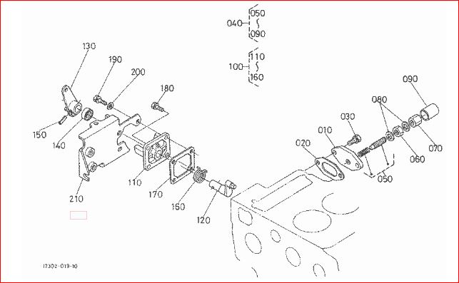

Throttle plate with Compensator:
Throttle plate without Compensator:
Stop solenoid: Note this was an option, you may or may not have one,
Do you stop the tractor with the key or with a pull rod?
Optional stop solenoid:

Now that I have looked over the parts diagram a little more and have thought about what is happening and what that thermostat is doing in the throttle plate, I think that you are right Wolfman. I am very tempted to order this thermostat right now.
Would it be possible to ask if there is anything else that I'm going to need for this job? I've never removed apart from this tractor, especially in this area so I do not know which gaskets or other materials/supplies may be needed. If it is as easy as taking apart a few bolts and putting it back together, then it should be a snap.

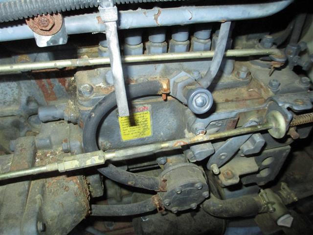

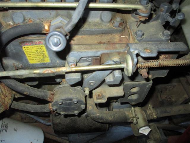

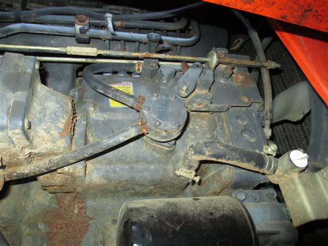

Here are some photos of the pump area that I took today. I must be honest and tell you that I do not know exactly what I'm looking at.
Can you point me to the location of the throttle plate or compensator?
...and by the way thank you for the help thus far.
33,388
8,700

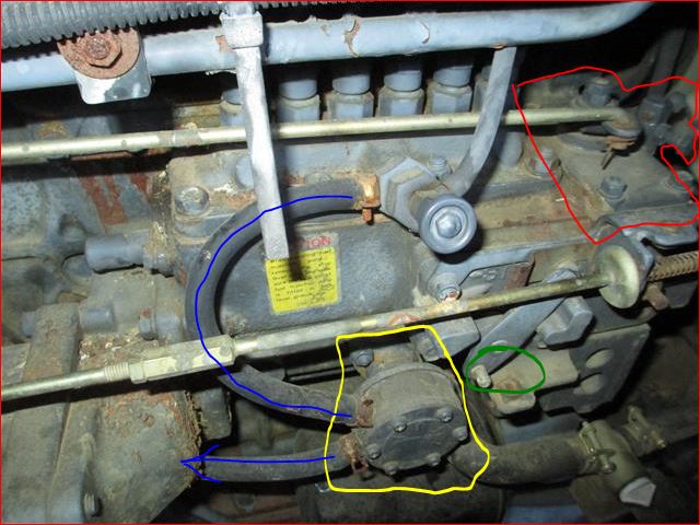

I reloaded the pictures, have no clue what happened to them????
I can tell you a couple of things from the pictures that you posted, Sadly it doesn't look like you have the compensator, I only see one shaft and I see two bolts for the adjustment of the high and low end.
Also you don't have a fuel stop solenoid on your tractor, so you have to stop it by pulling the rod and not just turning off the key.
We will have to switch gears and look for other possibilities.
I would double check the rubber fuel lines.
I would pull the lift pump and check the diaphragm for damage.
If there is nothing here, your next steps for repair are not so easy or cheap!
It involves some serious work and serious tear down to get to the governor assembly.
Have there been any change in the amount of oil in the tractor, like fuel is getting into the oil?
Also if it hasn't been a while, I would consider an oil and filter change before I went too far.
In the next pic is all noted:
Red is the throttle plate
Blue are the rubber fuel feed lines to check
Yellow is the lift pump (low pressure, low flow fuel pump)
Green is where the stop solenoid would hook up if it had it.

The reason to check for fuel is that if the injection pump is failing that can be an indicator of that failure, but I don't think that is your problem.
You are looking at only a few possible reasons that the tractor is having the problems you've described.
First is a long shot, Start at the lift pump, pull it off the motor 2 bolts and nothing to worry about falling in the motor on removal. Once off the tractor pull the bolts off the round cover and remove the diaphragm and check for any damage, hold it up to the light and look for pin holes, if there is any thing that doesn't look good, I would just change the whole pump, there is a $10 difference between just the diaphragm and the whole assembly.
Pump: 15263-5203 $52.51
Gasket: 1A021-52140 $0.88

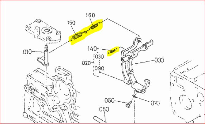

Next is the stop plate, remove the 4 bolts and pull the plate off the side, your going to be checking foe free spring loaded operation, make sure the spring is not broken.
Gasket: 1A021-51660 $2.78
Next is throttle plate, pull the 2 bolts and 2 nuts off of the throttle control plate and pull up gently, there is 2 springs (one inside another) attached to the throttle connection internally (you should be able to see the other side of the attachment threw the stop plate hole), I tie a string to the springs before removal to prevent them from falling into the motor, once springs are string tied pull them off the throttle arm.
I'm hoping that one or both springs are broken, missing or stretched so there would be your problem.
After you remove the throttle plate look down the hole to the governor and there should be another spring in there (do not remove that spring just verify it is there and connected on both ends). You should be able to move the governor back and forth with it returning smoothly, if not then we will have to go to the next stage.
If any of the springs are stretched, broken, damaged, or missing then there is your problem, you should be able to replace the springs and fix your issues.
Gasket: 1E147-57210 $2.16
Spring one: 17301-56410 $3.24
Spring two: 17301-56420 $2.78

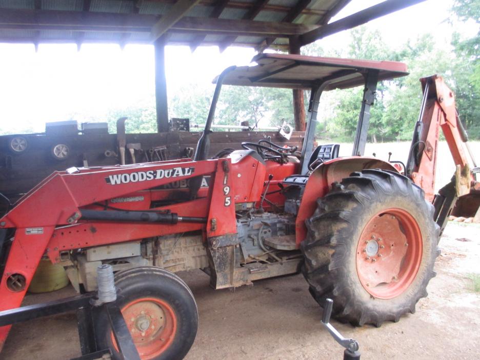

Due to the way that life has unfolded over the past year or so, we actually never got a chance to take the tractor apart. I had to use a tractor yesterday to dig up a busted water line.
It was so hot outside… The tractor did the same old thing and after it got hot, it would barely idle and would not increase rpm no matter where the throttle position was.
I just thought it was funny that we were stranded by the same tractor again, years later, same problem, FML. :eek: :D :confused: :mad:
