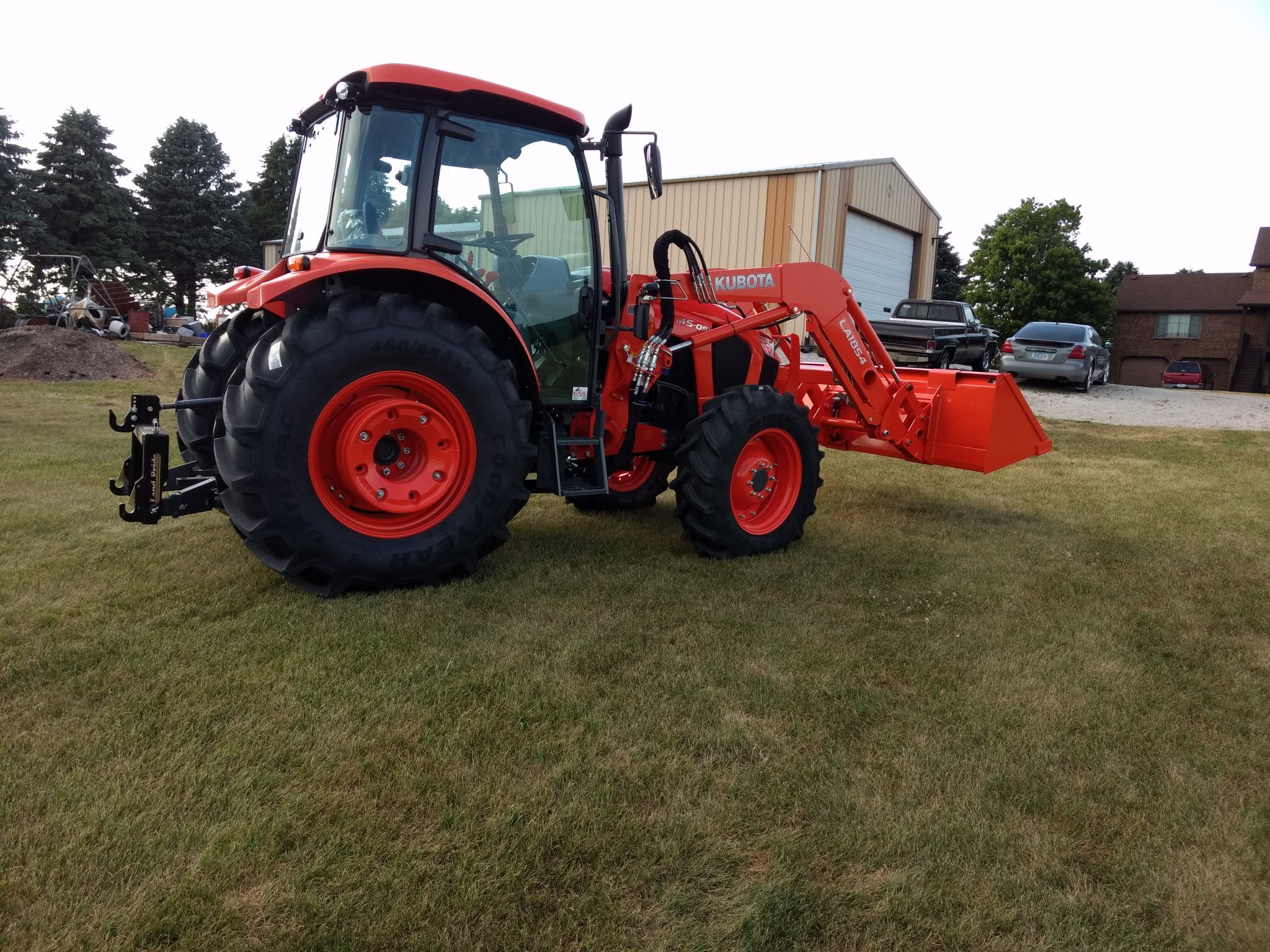

Hello,
I recently switch from a 7060 with rops to a M5 with a cab. I like the new cab a lot and it was about time that I step in from bugs and dust. My question is, did anybody installed a remote control for 3 point hitch from outside on the fender on an M5 ? I see that Kubota offer one on the M6 but not an option on the smaller M5.
On the 7060 open station was much easier to reach the lever over the fender when I try to hook an implement but on the M5 is a little bit more hassle.
I was thinking that maybe I can make a small hole in the back panel few inches bellow the window, put a rubber grommet or sleve and run a rod from out back to the main lever.
Any suggestionis greatly appreciated.
Here is a pic of the new big boy.

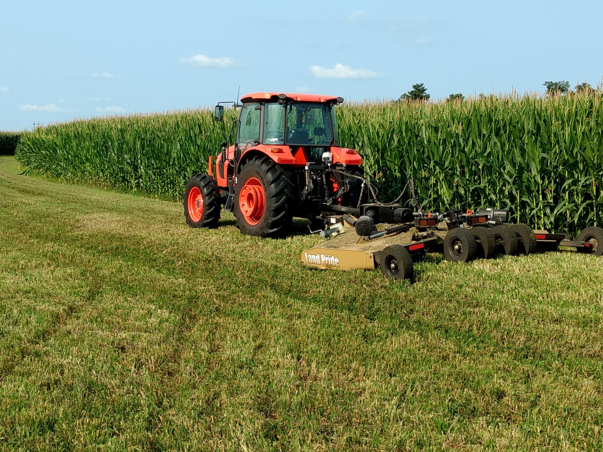

That is some serious weights in the back. How much per wheel ?
The rear wheel weights are 164# each and there are 3 per wheel plus I have the cast iron wheel centers. For summer time use I add the heavy front weight bracket and 4 100# weights, that helps smooth out road ride with my Land Pride RC3712 rotary cutter, I believe it has a 1200# tongue weight.

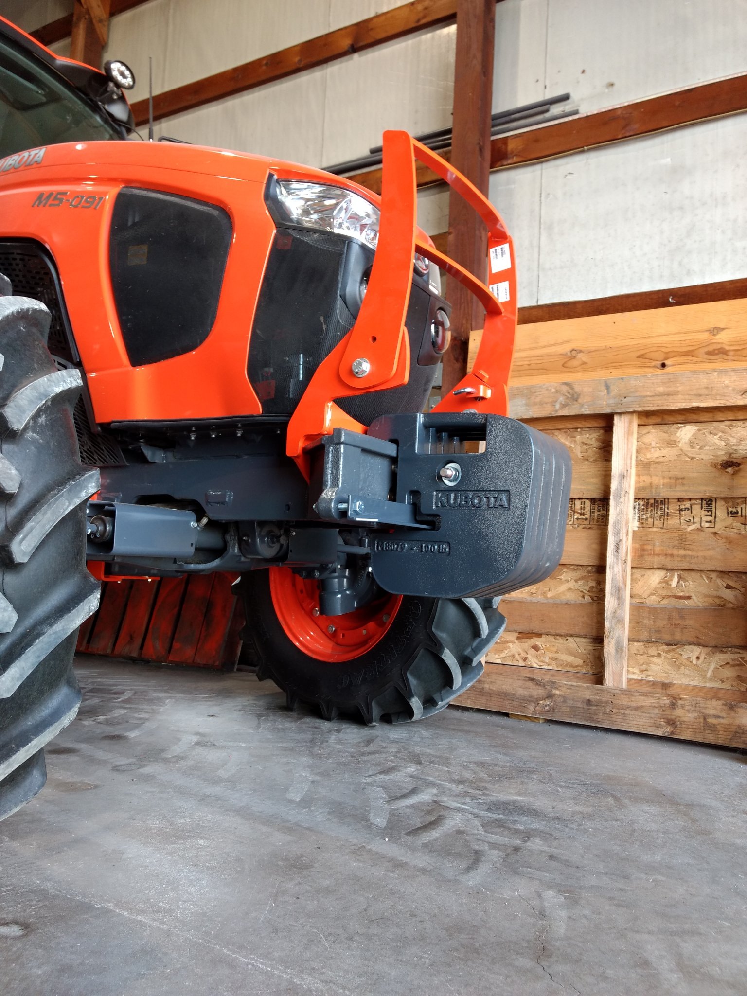

I leave the 240 Lb. cast front weight bracket on my M9960 year around. Cannot think of any good reason to remove it.
Same here. I leave the weight bracket on all year. I have 10 weights and use them when I plow, spray, or plant. Most of the time my loader is on though so the weights come off. IMHO, the tractor feels best (most balanced and nimble) with the rear tires filled and all 10 weights on the front. Love being able to move my combine heads around in the barn without having to fire up the combine though so the loader is on much of the year.
I have the same or similar weights on my M6060. I started out with two per side but ordered another set a couple of weeks ago.
I have my wheels set up at the widest setting which results in more space for the weights and they won't stick out as much as you show.
