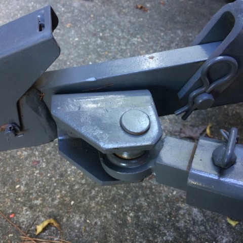

I have the WSM and page 8-S9 addresses the lift arm adjustment. I just bought the tractor last month so some stuff is still new to me.
My issue is that the lift arms don't go as high up as the old JD, which is causing me a problems with a couple of implements.
I am hoping that there is a simple adjustment on the position control linkage or the feedback rod but I wanted to ask questions first.
(I turned the lifting rods all of the way up but that was not enough.)

By using different holes in the lift arms(or drilling more) upward range can be traded against available upforce, or min height. I had a three-point forklift once that needed a couple more inches of lift - new arm holes closer in made the difference.

I thought about that but there is not much room to drill another hole. It's sorta crowded as it is and I don't think 1" further out would make much difference.

I am familiar with the 4 top link positions and their affect on draft control. Also that shortening the top link, however way, will have a fulcrum effect on an implement's height.
Neither of these will raise the height of the ends of the lift arms which is my question.
An implement (subsoiler) must be kept level during operation in order for it to to bite into the ground during operation. Shortening the top link raises the "plow" point making it impossible for it to do it's job.
So back to my original question: Is there an adjustment in the position control linkage, etc. that will allow the lift arms to be raised higher?

No BigG. Your geometry is wrong. Closer to the tractor lowers the lift arms, and away raises the lift arms.
I have considered attaching the lifting rods in the same holes as the stabilizers which gives me ~3"-4" of height. The other option is to just use shorter lifting rods which would be the easiest.
Before I do anything I want to know if my lift arms are as they should be and whether there is a normal adjustment that can be made.
Magic, you don't have it backwards, but you're only considering one side of the equation....
It is true that moving it closer will lower the lift arm ends when down, but they will also go higher when lifted.
Think of it as moving the fulcrum such that one side of a lever is very short; enough to create a much wider range of motion on the opposite end of the lever.
A lift link/rod hooked closer to the tractor will allow the lower link-end to raise higher and go lower, but at the expense of some lifting force.
Moving that attachment further out on the lower link has the opposite effect...ends don't go as low or high, but can lift more.
Don't know your tractor, but I'd be surprised if an M didn't have multiple options for hooking the lift links closer to the tractor to get the height your looking for.

I would really appreciate it Newlyme. I'm at ~10" low and ~27" high.
I moved the lifting rods out 5" to the stabilizer bolts. Because of the geometry, that raised the low up 6" but only raised the top 2".
Yes, RCW, moving the lifting rods 5" closer to the tractor raises the lift arms 4" top but it puts the lift arms on the ground in the lowered position. Not good.
If there is no adjustment on the position control linkage it looks like I might shorten the lifting rods.

My apology BigG. Actually moving the lifting rods both ways proved that both of us were right, just in different ways.
