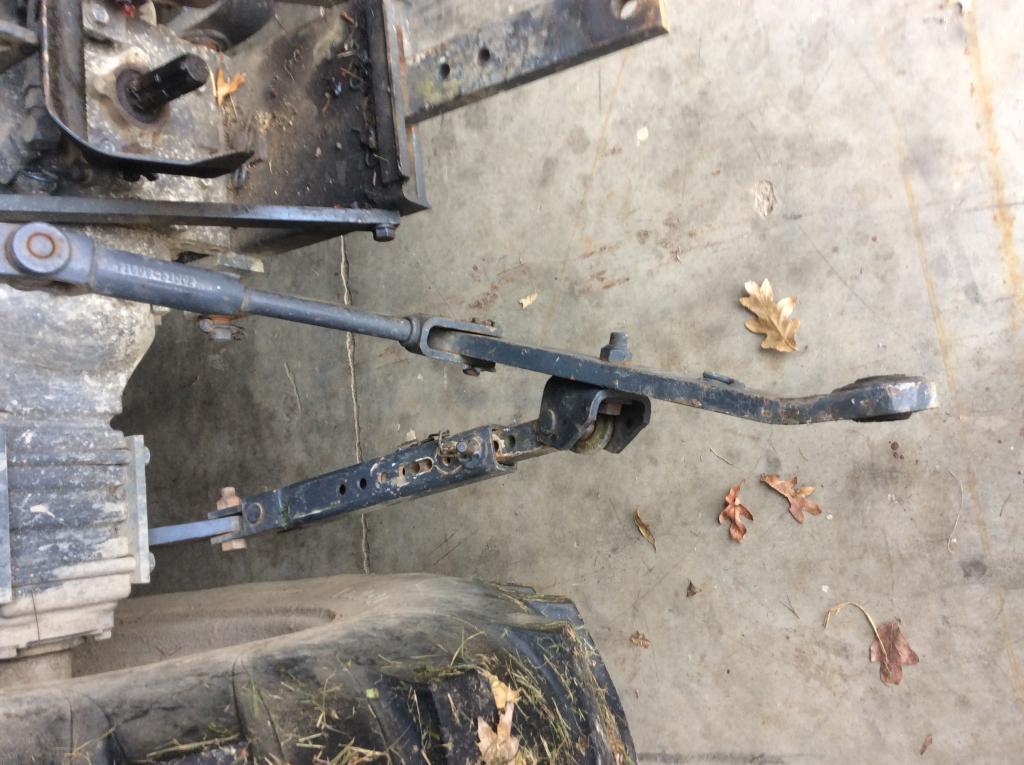

I would really appreciate it Newlyme. I'm at ~10" low and ~27" high.
I moved the lifting rods out 5" to the stabilizer bolts. Because of the geometry, that raised the low up 6" but only raised the top 2".

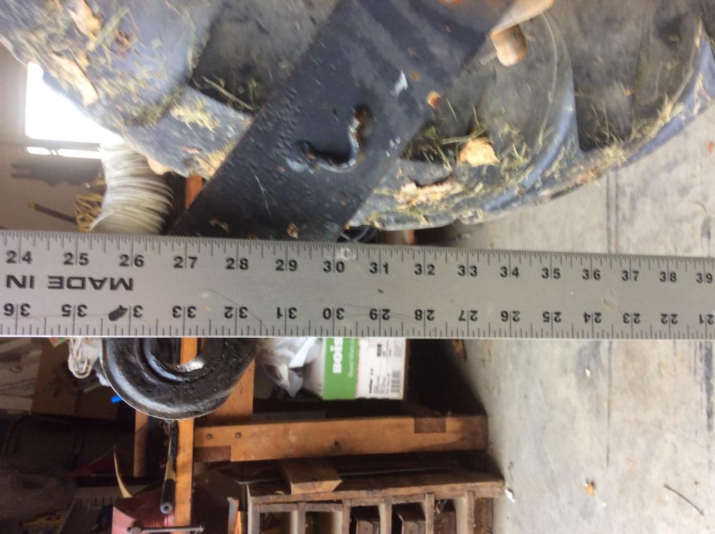

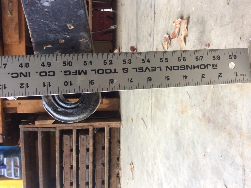

This one is all the way down. 10”
All the way up. 33”

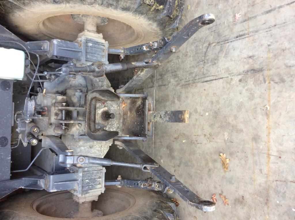

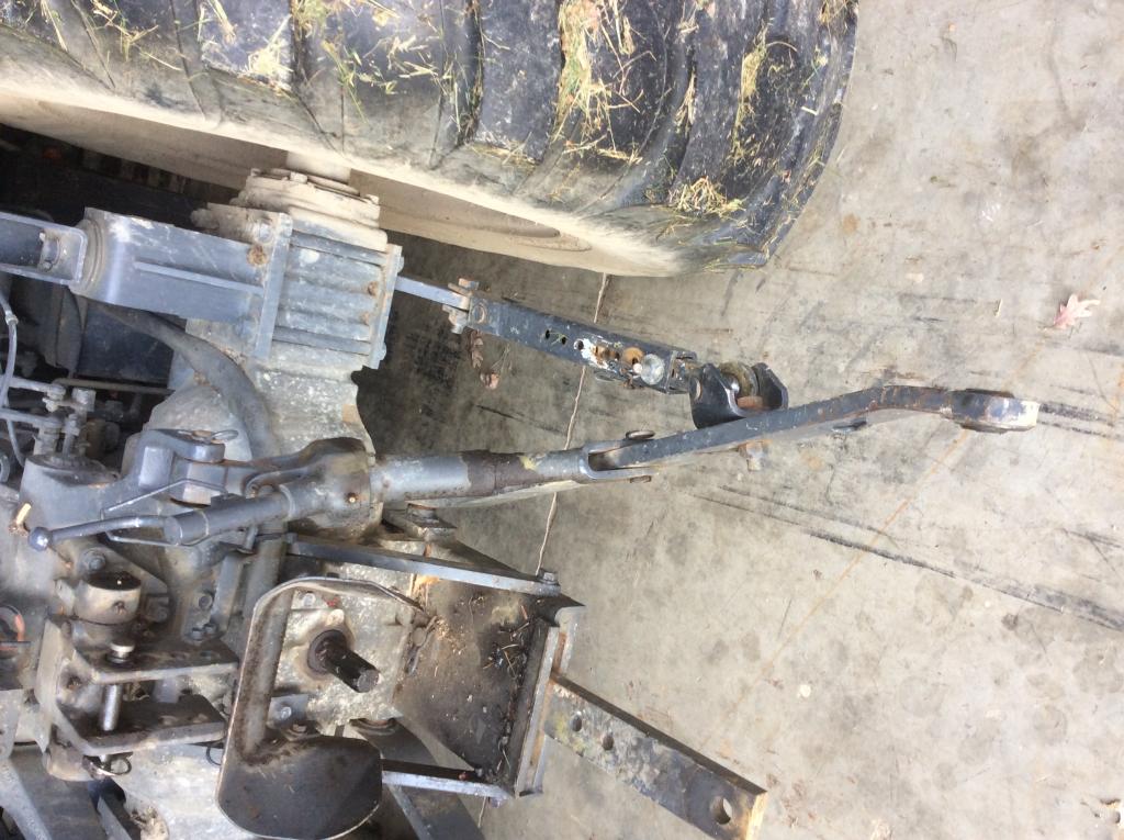

Left arm assembly.
Right arm assembly.
The whole three point arm assembly.
Both of the measurements were taken on the non-adjustable side.

Thank You for those measurements. You are a full 10" higher than I am so I will now adjust the "position control" linkage.

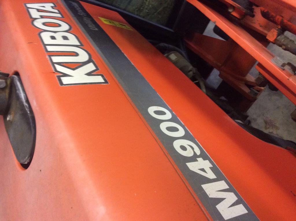

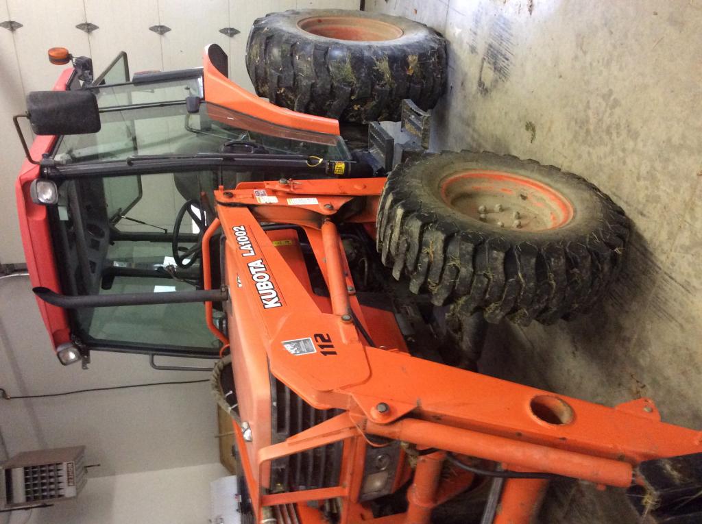

Here is a picture of my tractor model.
And here is a picture of the tractor.
Do you have the same tires as I do?
If not that may give you a different measurement.
Sorry about the sideways pictures.
