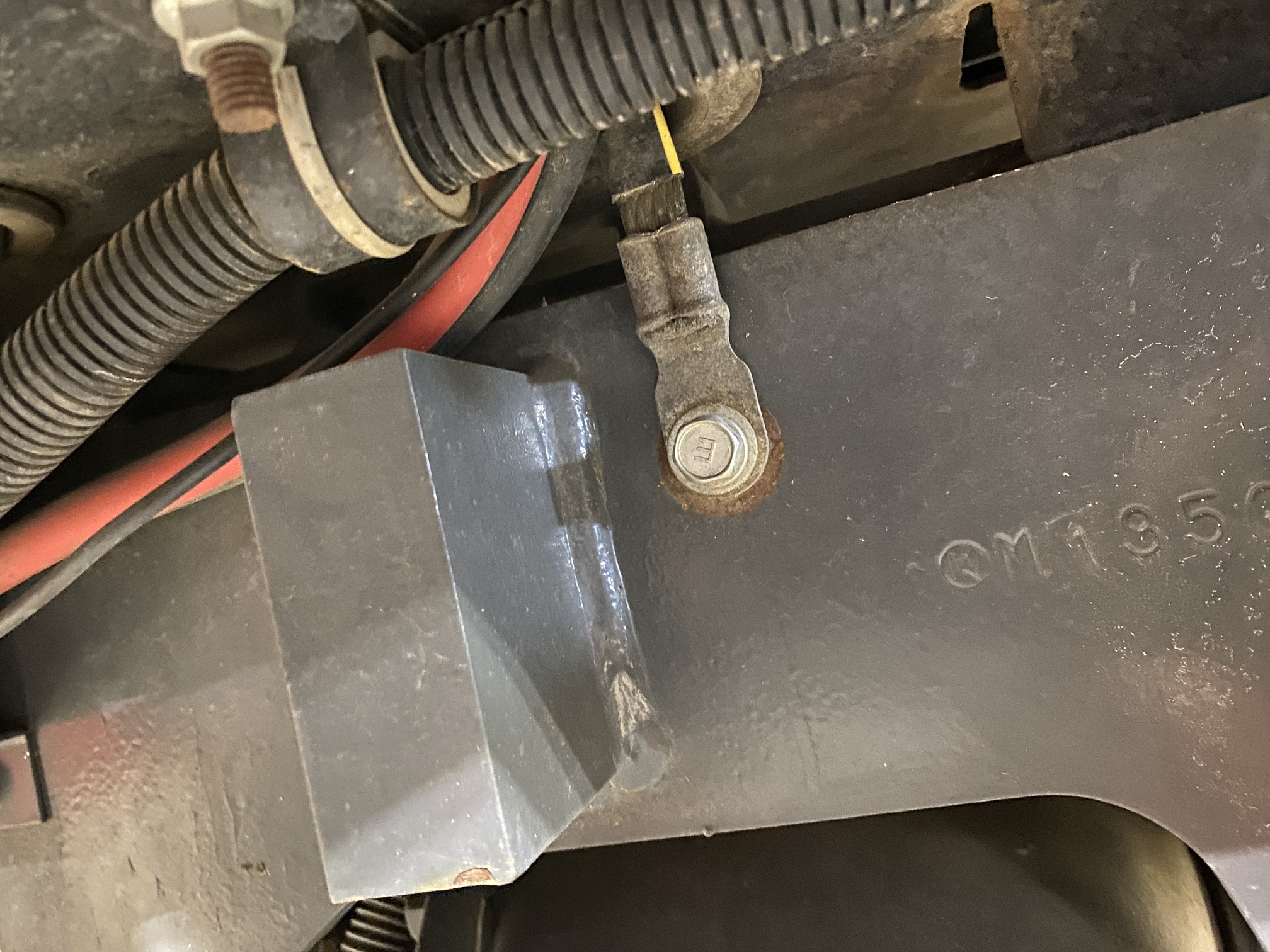

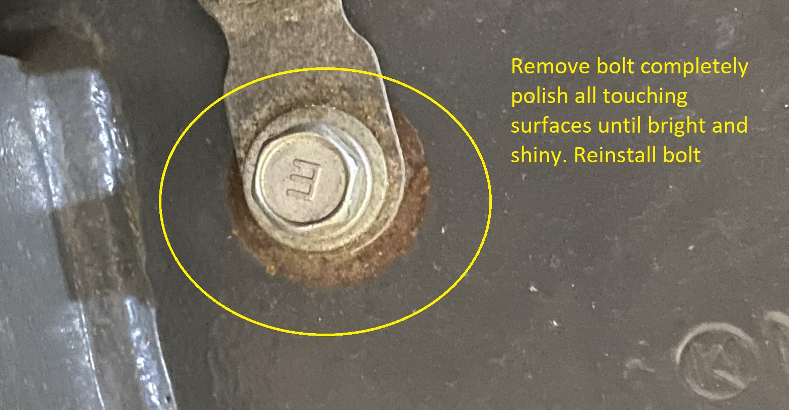

I have rec'd the battery cable photos I asked you for.
Do the fix I suggested to this one connection and then try.
Post if it made a big difference

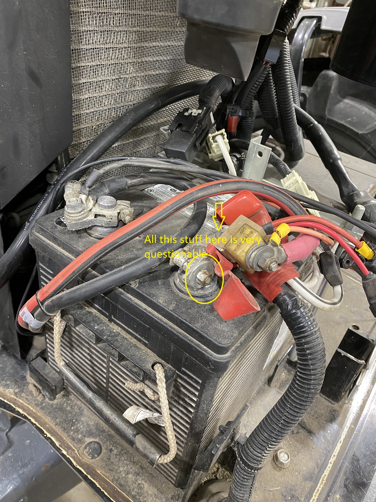

Here are photos from owner
In addition to the ground cable bolt to frame, the positive battery connection looks very messed with and may also be part of the problem.

wow what a friggin wiring NIGHTMARE,sadly though I've seen worse.
3 or 4 high current device trying to get power from that battery !
That tractor should have a SECOND battery, just for 'extra' stuff.... and a 'dual-diode' between the alternator and the batteries.
Not really a nightmare. 1 cable operates an auger swing that isn’t connected unless auger is connected to it and the second cable is for a kubota round baler only used in summer time. Instructions from Kubota state to connect this way. The rest is factory connections. Sure wasted a lot of money on this tractor and regretted buying it from day one. Must have been built on a Friday or maybe they are all built this poorly.

Do as NIW says AND properly clean the cable ends and every nut/bolt/washer that secures them. Also follow the ground and see does it go to the frame or connected very close to the starter ?
BTW, I counted SEVEN wires on the +ve post, 4 or 5 on the -ve and a lot of 'corrosion' .
I will post the other photos so other forum members can review
Dave
Polished it clean and it was not that bad but still no difference. even tried a brand new 2 gauge ground cable, and still no difference. Definitely not a ground issue.
