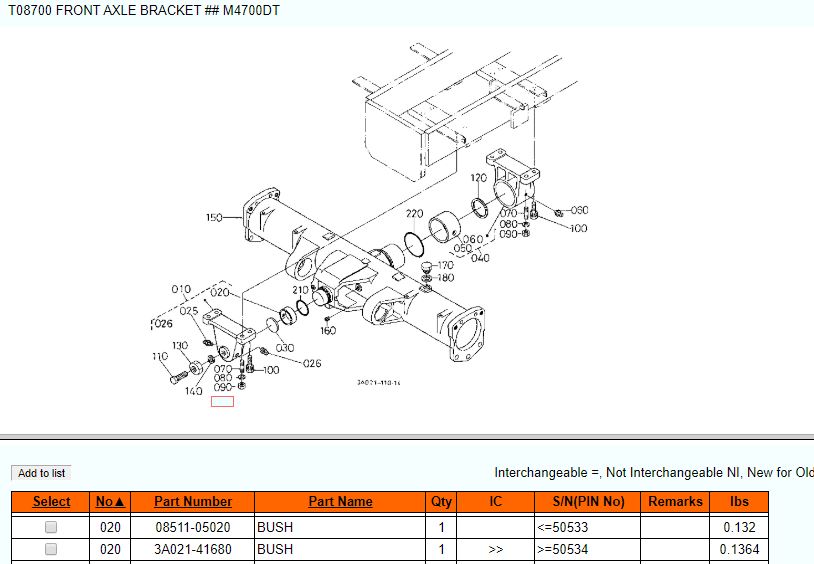

6,142
3,445
Ok...while sober...before my evening tranquilizer (St Pauli Girl) ... I have crawled under it AND visited Messicks Parts pages for my M4700DT Front Axle support and...
Messicks page: No expansion plug on the rear support and only one zerk... THIS agrees with my tractor.
Messicks page: One zerk and one plug on the Front support... neither on my tractor. I see the price is over $200 and I think I can remove the front support (4 bolts) and drill/tap/install a zerk and a plug without spending $2 much less $200.
But I also notice the Messicks page has an * on one of these parts and *** on another. No explanation as to what asterisks mean.

There is more to it than just a couple holes drilled and taped in it, for one it has a different bushing as grease ain't going to travel around a solid bushing.
I do believe the case also has a relief cut in it too.
Not taking mine apart to look but I certainly can ask Dennis at the dealer. He works on M's all the time.
I bet wolfman is correct though, solid (no grease channel) bushings. I imagine you'd have to press the bushings and machine a grease channel in them, then drill and tap (1/4x28) the hole for a zerk. Not an insurmountable job but not just a drill and tap either.

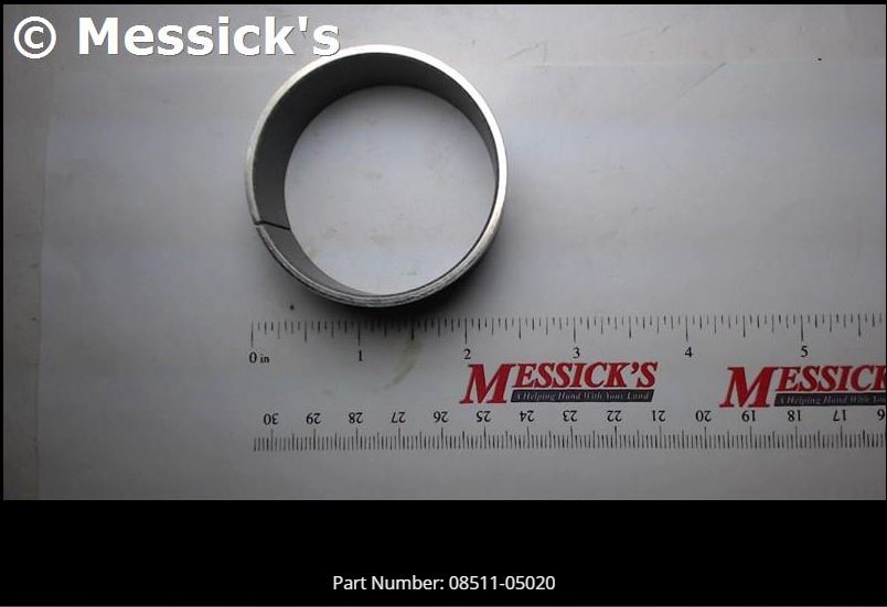

Thanks, Wolfman, I expect you’re correct (as usual). However the bushing appears to be the same PM regardless of which bracket (zerk or not) is used. The photo of the bushing shows it to be a split bushing so grease should get inside it the same either way.
I may order the part then examine it when it comes in, I can always refuse it.

The picture on the diagram is the newer bushing with the hole, the old bushing does not have the hole.
The real issue is the case, the case has a groove cut inside of it (for grease to travel around it) along with the 2 holes for the plug and grease zerk.
Old bushing with no grease hole, which you will have installed in your case.
Sorry no pictures show the inside of the old or new cases because when you buy it, it already has the bushing installed into the case.
