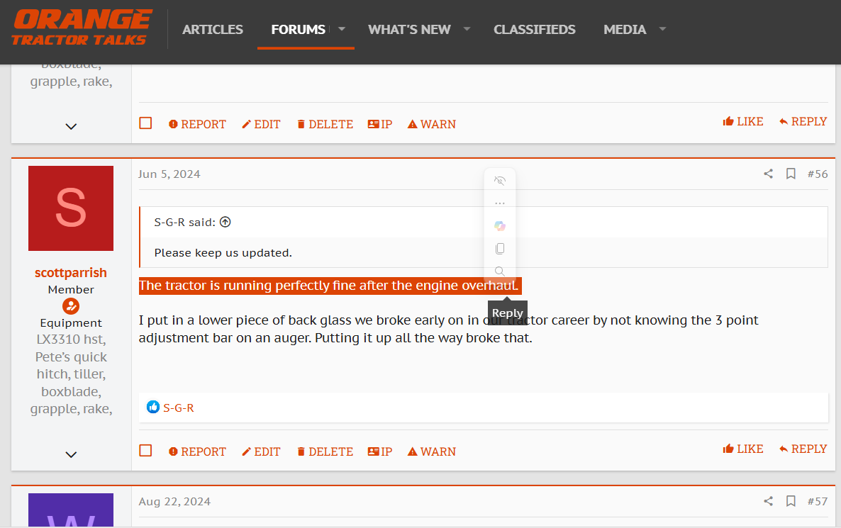

Kubota did $5000 in warranty engine repairs last year due to a no engine horse power issue. Replacing injectors and a bunch of stuff they called the “top end” which a moderator said was not a top end job when I posted the last issue here
I think you stated that it had an "engine overhaul". See your post below.
