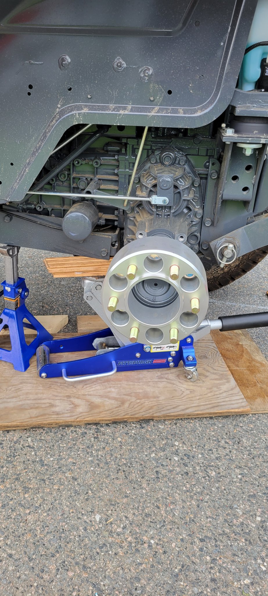

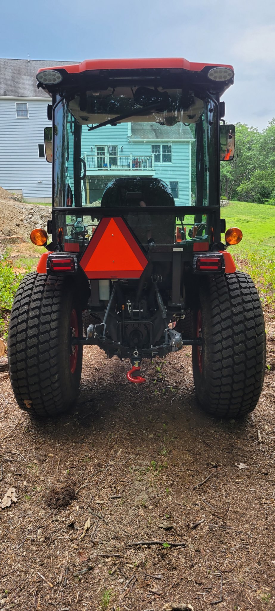

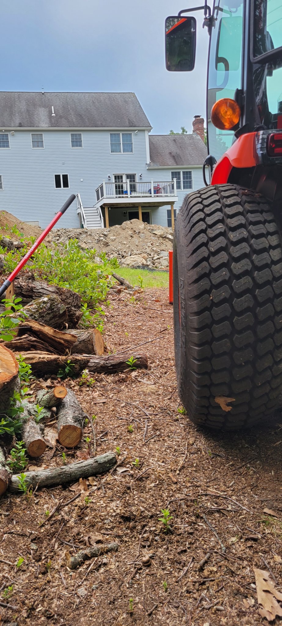

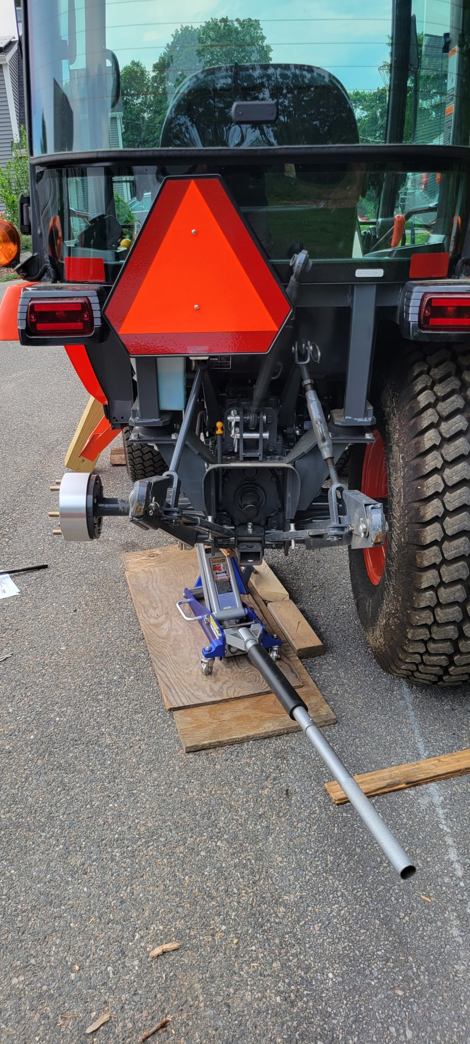

I also went with the 3" Bro-teks. Easy install, give a good looking stance, and add noticeable stability on slopes based off of my butt pucker inclinometer readings.

Do you have torque specs for the installation?
Does that butt pucker have a grapple?
I don't remember the torque setting. My son looked it up on his phone, set his fancy digital torque wrench, and handed it to me to.
No grapple, I use forks and finesse ;) Pretty sure the butt pucker values will apply to grapple work as well.
